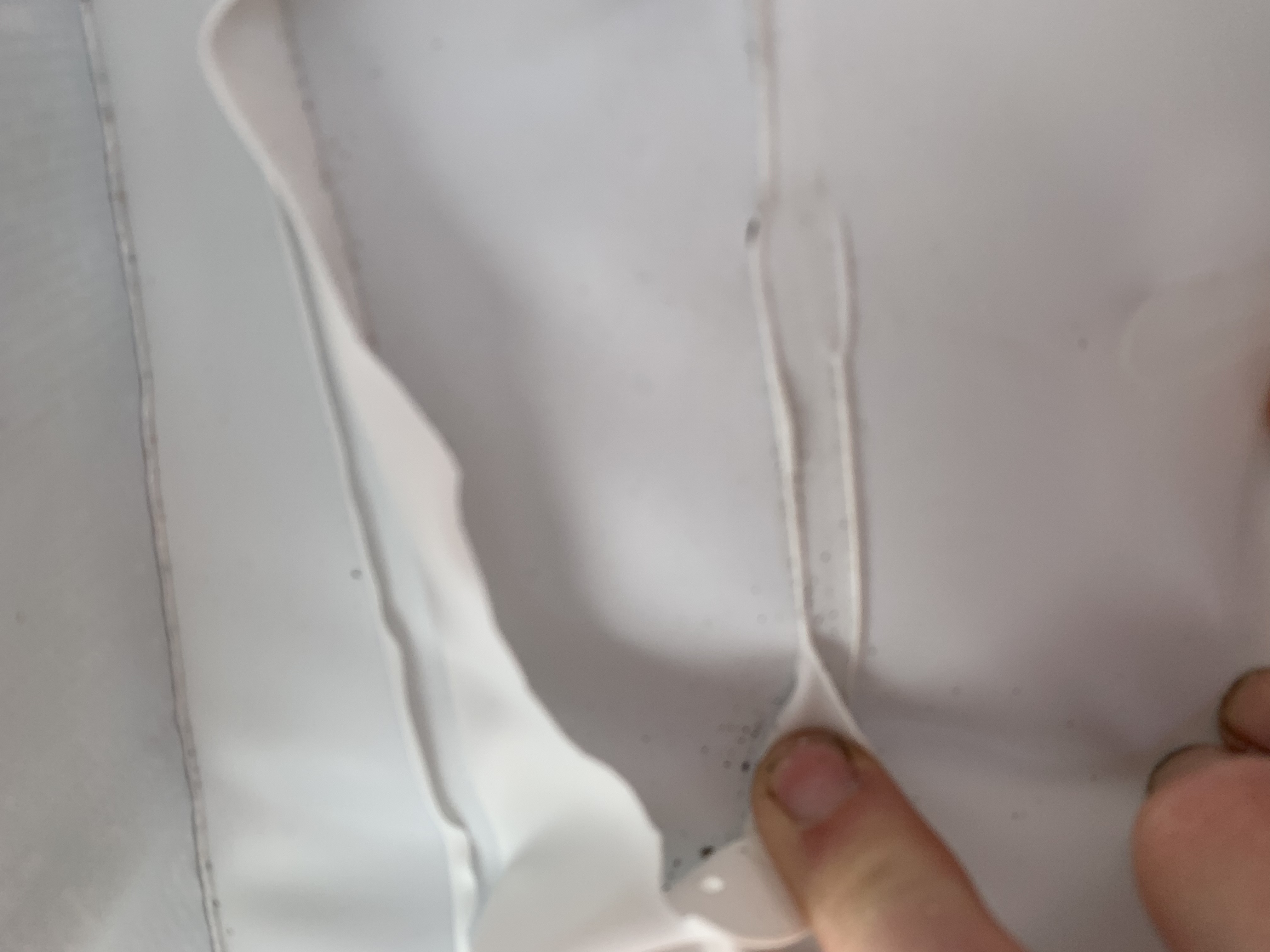

JDarnley Posted May 30, 2021 Report Posted May 30, 2021 Guys if you aren’t bothered too much about the jets like us or just want it to last abit longer before replacing. We had this issue. My husband cut part of the air jet ring where we could hear the air coming from and there was a puncture inside the air keys ring in the lining of tub. So we have repaired it that way. We haven’t tried to use the airjets yet but I assume it will just come from where the big whole is now in one. Quote

ratchett Posted August 18, 2021 Report Posted August 18, 2021 On 8/15/2021 at 10:22 AM, RachelW19 said: I’m having this issue and mine is only 8 weeks old so I’m guessing the puncture was there when we bought it These inflatable spas are assembled using heat-welded seams. Very little QC testing is done in the factories on these types of spas. A missed or failed seam is totally not surprising on these budget grade products. For older inflatable spas, water adds pressure to the seams - add in heat and you're compromising the structural integrity of the seal, eventually causing them to stretch and eventually tear over time (that's why you'll never see a 10+ year old inflatable hottub - because the seams give out way before then!) Sadly there aren't many easy ways to repair a torn seam without the repair also ripping out from the stress of air pressure + water pressure - these spas are built to be used and then discarded/replaced as needed. Serviceability is not exactly something these Chinese factories care about when producing these inflatable spas - they make more money when you buy more stuff, not fix the old stuff. My advice to you would be take the spa back to the original place you purchased it and demand a refund for the defective item. If/when they refuse, call your bank and request a charge-back - explain to them you bought a defective product and the store is refusing a return/replacement after two months. Quote
