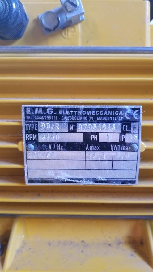

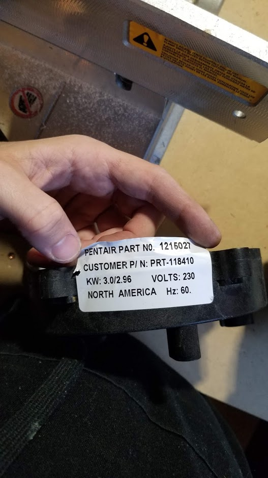

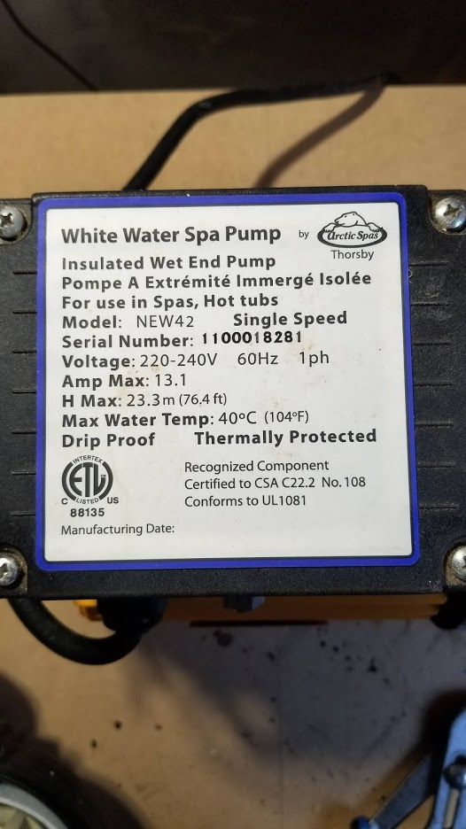

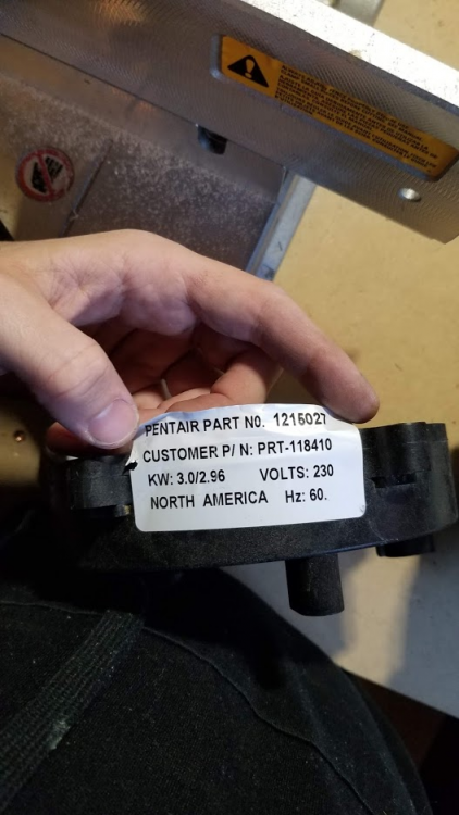

bradzal Posted March 13, 2021 Author Report Share Posted March 13, 2021 Hey, there are pictures of everything in that imgur album. Wet end part number and motor plate are attached. The entire unit is from Arctic Spa. Quote Link to comment Share on other sites More sharing options...
RDspaguy Posted March 14, 2021 Report Share Posted March 14, 2021 Well, I can't find that pentair part number. Pumps are usually rated in hp, not kw. The impeller you posted is a balboa, not pentair. I don't think I can help you. Maybe @CanadianSpaTechmight know. Quote Link to comment Share on other sites More sharing options...
CanadianSpaTech Posted March 14, 2021 Report Share Posted March 14, 2021 I have seen those yellow EMG (made in Italy) motors come with different wet ends from Arctic Spa. I would nee to see better photos of the wet end housing to try to match it up. Install notes: I have had to remove the slinger and cut/shorten the end/shaft of the impeller to get it to screw all the down way onto the motor shaft. The impellers are often uprated on these as @RDspaguymentioned. @bradzaldownload this catalogue... see pages 109, 110, 113 and 114 Here: http://elmsalesandequipment.com/product-catalogue.htm Quote Link to comment Share on other sites More sharing options...
