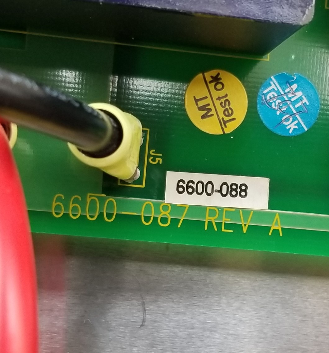

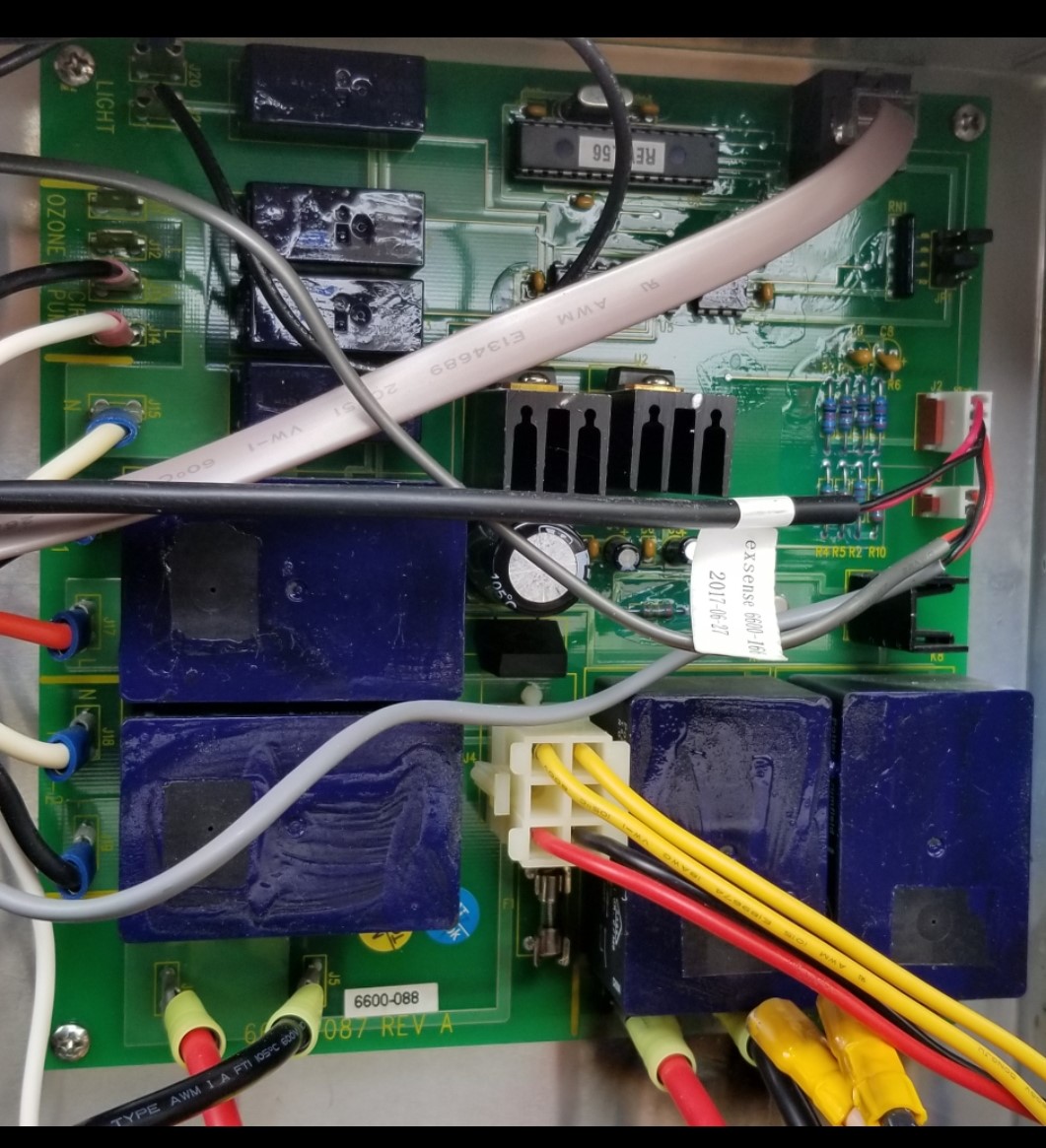

Fred Harwood Posted January 15, 2021 Report Share Posted January 15, 2021 Good day All, the other night i heard a pop from inside the tub and it blew both breakers, found a significant scorch mark on the "heater out module" and blew the pins out on the back of the board. I am in Canada and draining the tub as i write this for fear of freeze up, I have a 2004 Jacuzzi J-345 and the board is a 6600-087 but the new version would be a 6600-728 according to jacuzzi tech in California. Would anyone know where i could get a reasonably cheap board as I'm see them at $500 - $ 700 which is way out of my budget, in the 17 years i have blown a circ pump and now this , so not too bad and very fortunate. Appreciate any help you all could suggest. Thanks, Fred Quote Link to comment Share on other sites More sharing options...
RDspaguy Posted January 15, 2021 Report Share Posted January 15, 2021 Bring it to an electronics/ computer repair shop for a new relay and terminal. Much less than a new board, and probably will do it while you wait. Draining it will not prevent freeze damage. Get a space heater under there, and just disconnect the heater wires so it can circulate water. Quote Link to comment Share on other sites More sharing options...
