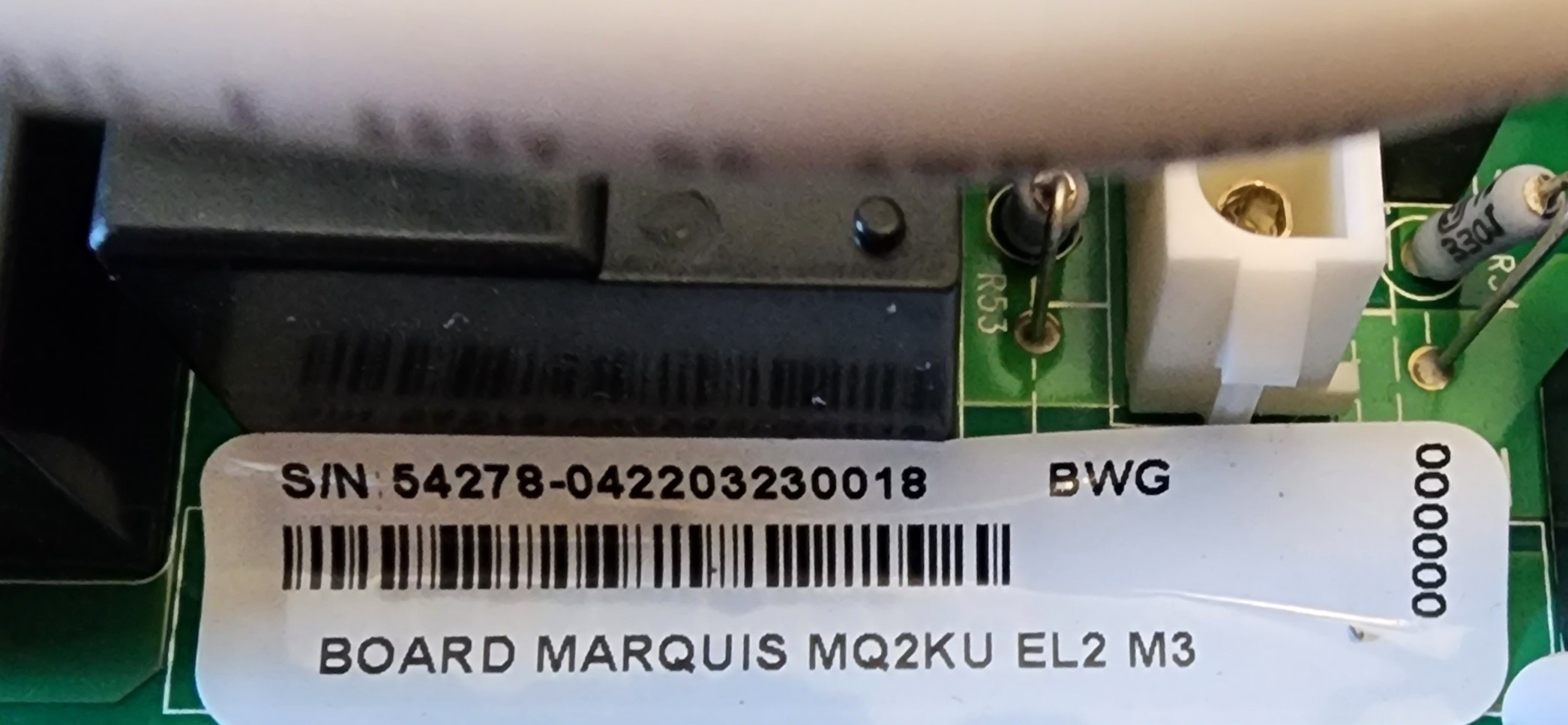

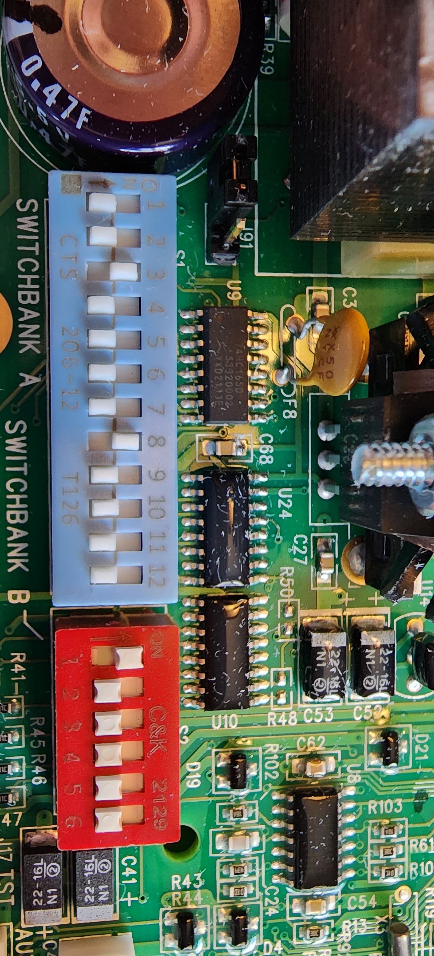

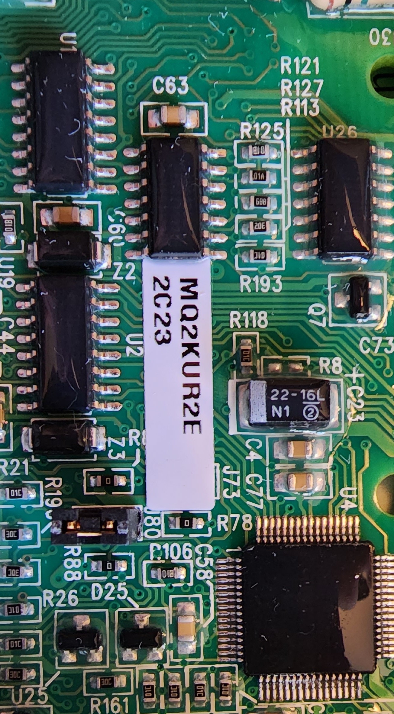

Khon2023 Posted February 28 Report Share Posted February 28 Hello, I recently bought one of these exact 2009 Marquis Epic spas (with circuit board: s/n 54278-04x, Marquise MQ2KU EL2 M3). I'm having trouble with my heater and need to troubleshoot my connections and dip switch settings but I'm missing the control system wiring diagram from the control box lid & so far I can't find this online anywhere. If anyone can share a picture or .pdf etc. of the system wiring diagram for a 2009 Balboa Marquis Epic spa it would help me out greatly. If everything is set correctly, I'll probably need a new heater, sensors, &/or a new circuit board, but want to take it one step at a time. I'll attach pics showing the circuit board info., chip, and current dip settings in case it helps. Thank you, -Kenneth Quote Link to comment Share on other sites More sharing options...
