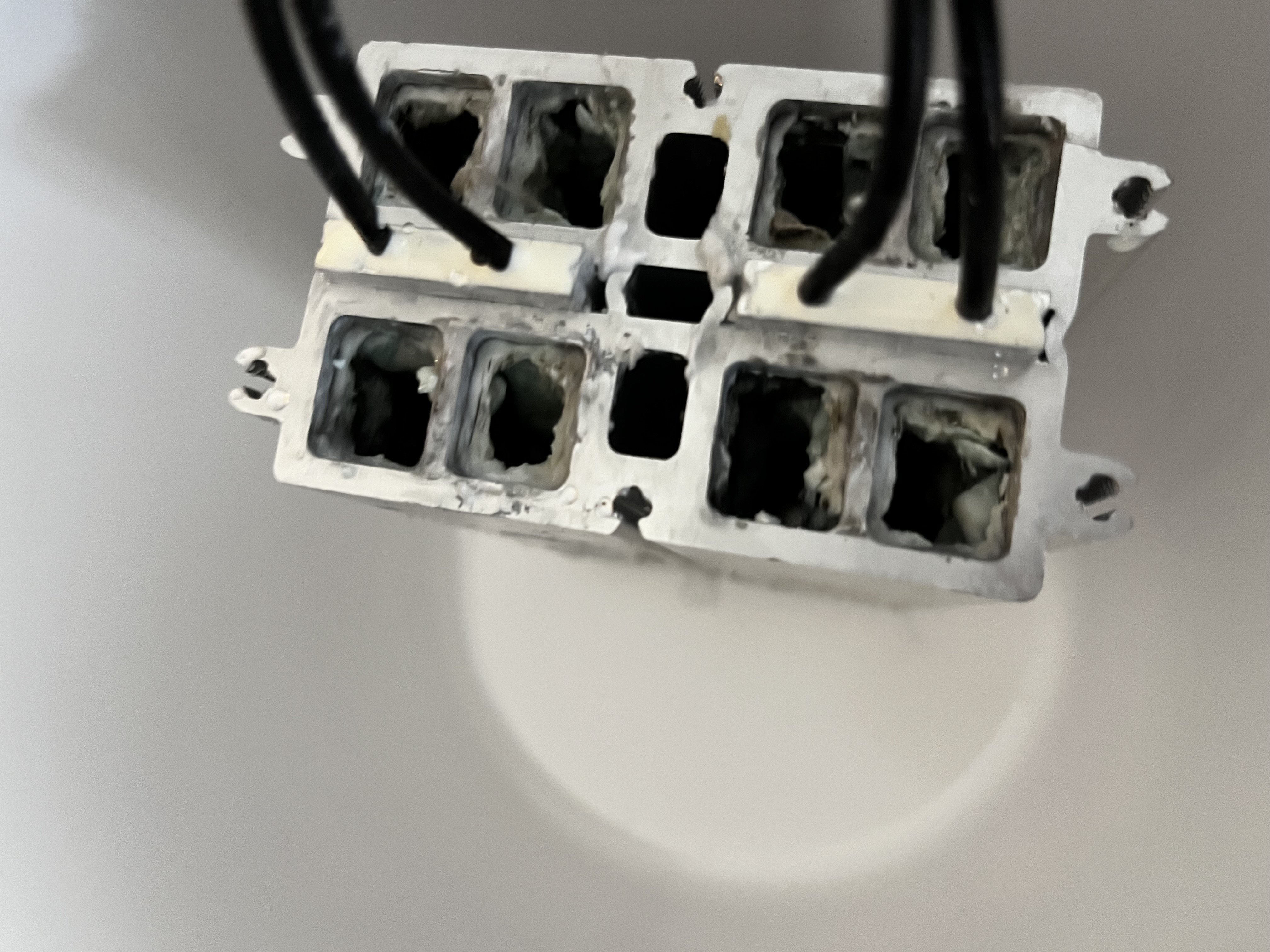

I had the same issue, I took apart the unit, every part, it’s relatively simple. I found the heater or what I assume is the heater and it was clogged with calcified minerals from the water. Essentially the heater would heat the water in the unit and not push it through making the unit overheat and sending out the e5 code. Once I cleaned out the calcified minerals that accumulated inside the heater and put the unit back together flow returned. And the error code stopped coming. There also was a clunking/clicking noise that disappeared. Not sure if it was related but a win either way.
