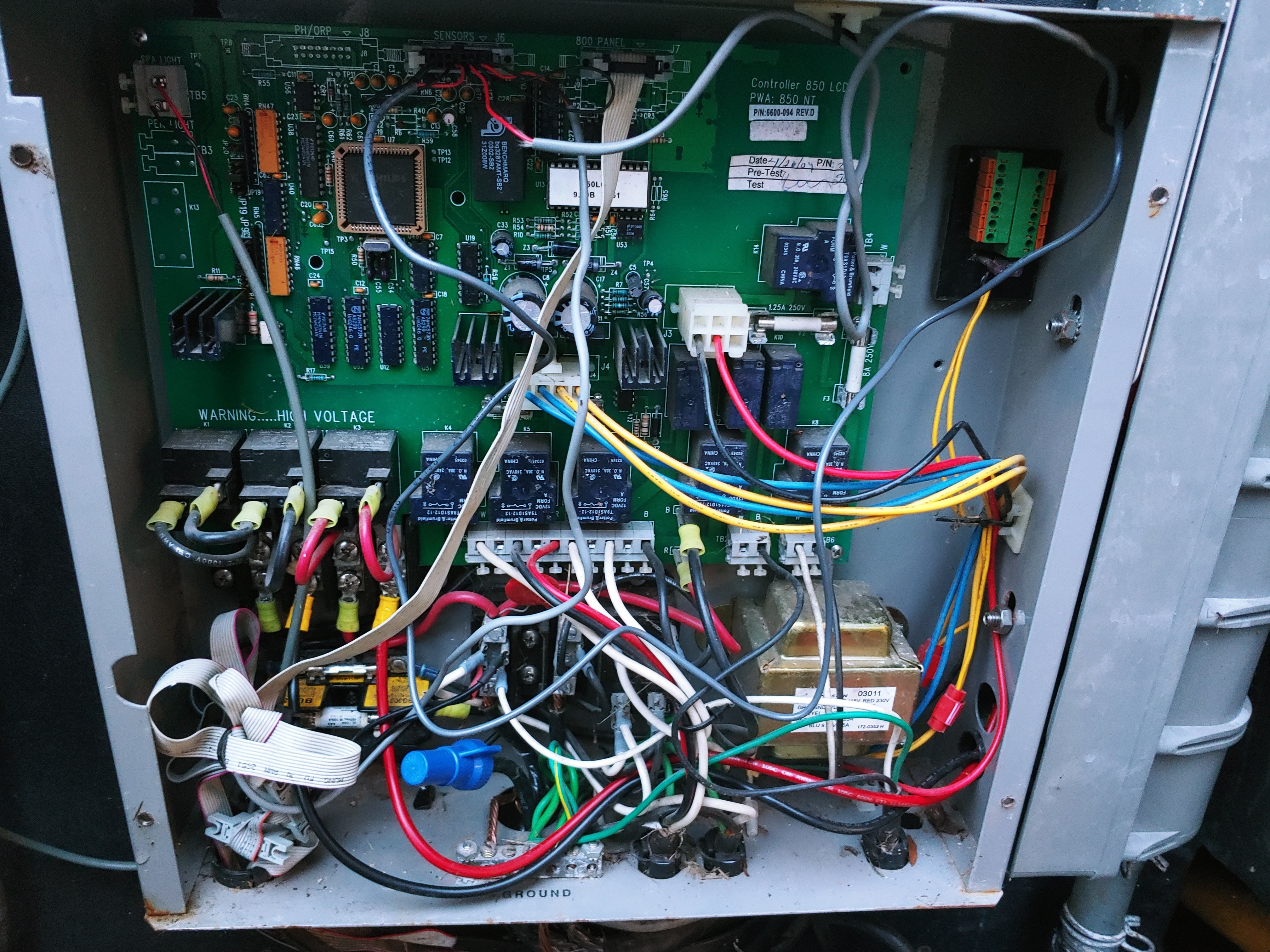

RDspaguy Posted May 15, 2020 Report Posted May 15, 2020 Check for voltage at the heater terminals. You may also have a thermo-disc in the heater terminal compartment. Check it as well. If you have no voltage and you have a heat indicator on the topside then you probably have a bad relay on the circuit board. An electronics repair shop can likely replace it fairly cheap, but you will have to remove the board. Let me know what you find. Can you post a pic of the circuit board? 1 Quote

CanadianSpaTech Posted May 18, 2020 Report Posted May 18, 2020 Likely not related but that F2 fuse (white paper fuse horizontal one on right hand side) is barely hanging in there Quote

RDspaguy Posted May 19, 2020 Report Posted May 19, 2020 If you have a heat indicator, no errors, and no voltage between the wires going to the heater then you have a bad relay on the board. 1 Quote
