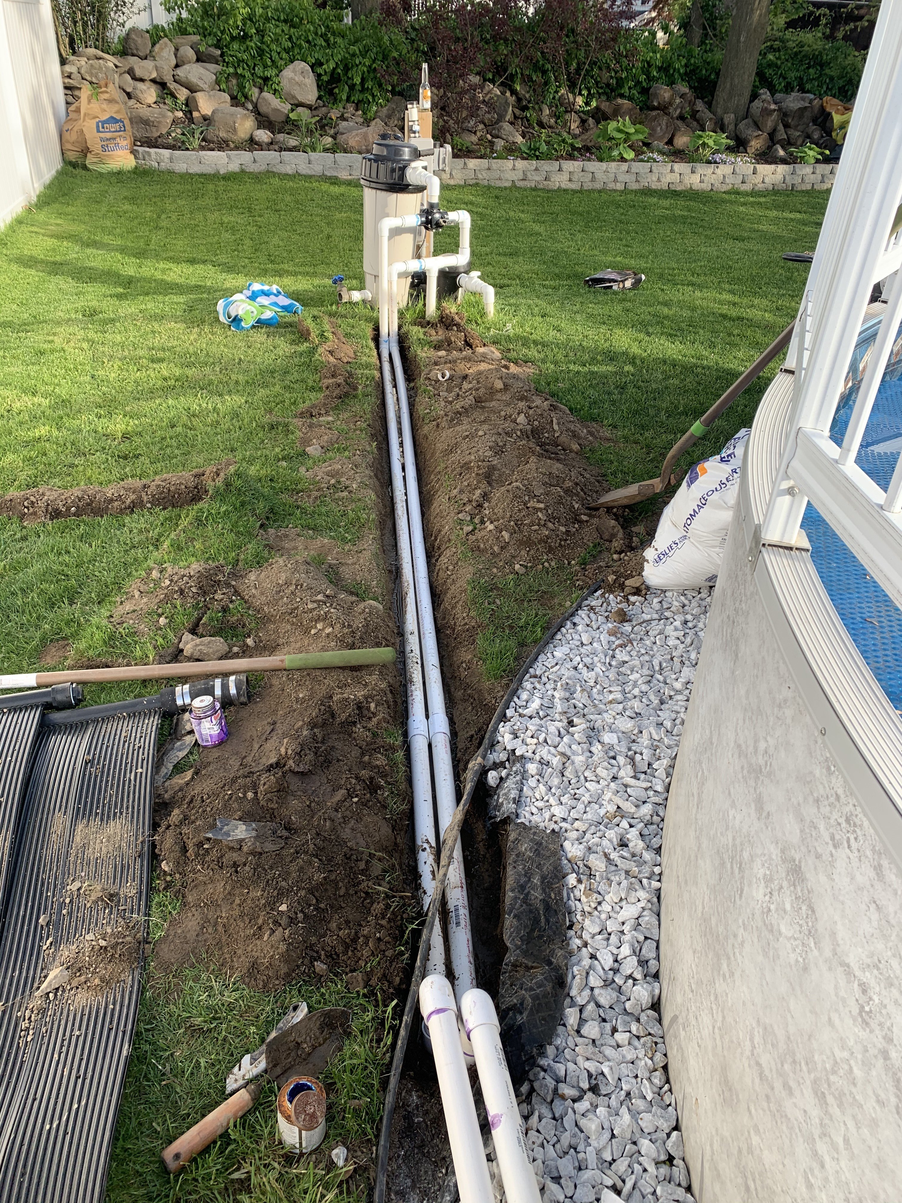

John Pacino Posted May 12, 2020 Report Posted May 12, 2020 Hi, i purchased two 2x20 SunQuest solar panels last year which i connected and laid them against a west/south/west facing fence. While it heated OK, i was not getting the full value of the solar panels. I would like to move the panels to my Southwest facing roof that gets sun exposure from 10a - 6p that should definitely help with heating our pool (located in CT) The pool was recently installed a few year ago and at the time did not contemplate solar roof panels. I'm currently operating a 1HP Hayward Power-FLO Matrix pump with a Hayward Perflex Extended Cycle DE Filter. The filter is rated for 50 GPM and 50 PSI. To get the water up to the pool, i would need to run about 50 feet of PVC to the house and then up 2 stories, an additional 30 feet, and back to the pump area. I've read in multiple threads that a 1HP pump should get the water up to the second story but am hoping to confirm with my configuration. I could upgrade the pump to a hayward 1.5HP without changing the filter if needed. I've already installed a 3-way jandy valve that I used last year when the panels were against the fence (about 5 ft away). The plan was to run PVC above ground to the house (along side the pool and deck) and up to the roof with at least 1 check valve to make sure the back pressure does impact the pump. Thank you in advance for your feedback. Best, John Quote

John Pacino Posted May 19, 2020 Author Report Posted May 19, 2020 So far, so good with the FLO Matrix. I've ran all the plumbing from the pump to the top of the house using 1 1/4 inch pipe. After letting all the fittings cure for 24 hours, i turned it on, diverted the water to the roof and video below shows the flow i'm getting 25ft in the air. The PSI remained around 10 which is what I run with a clean filter. Based on the results so far, i'm optimistic that the water will be able to make the bend around the roof and to the panels just a few feet away. We're installing the panels on the roof this Friday and will provide an update. Thanks for the advice so far. Feeling optimistic, John IMG_1425.MOV 1 Quote
