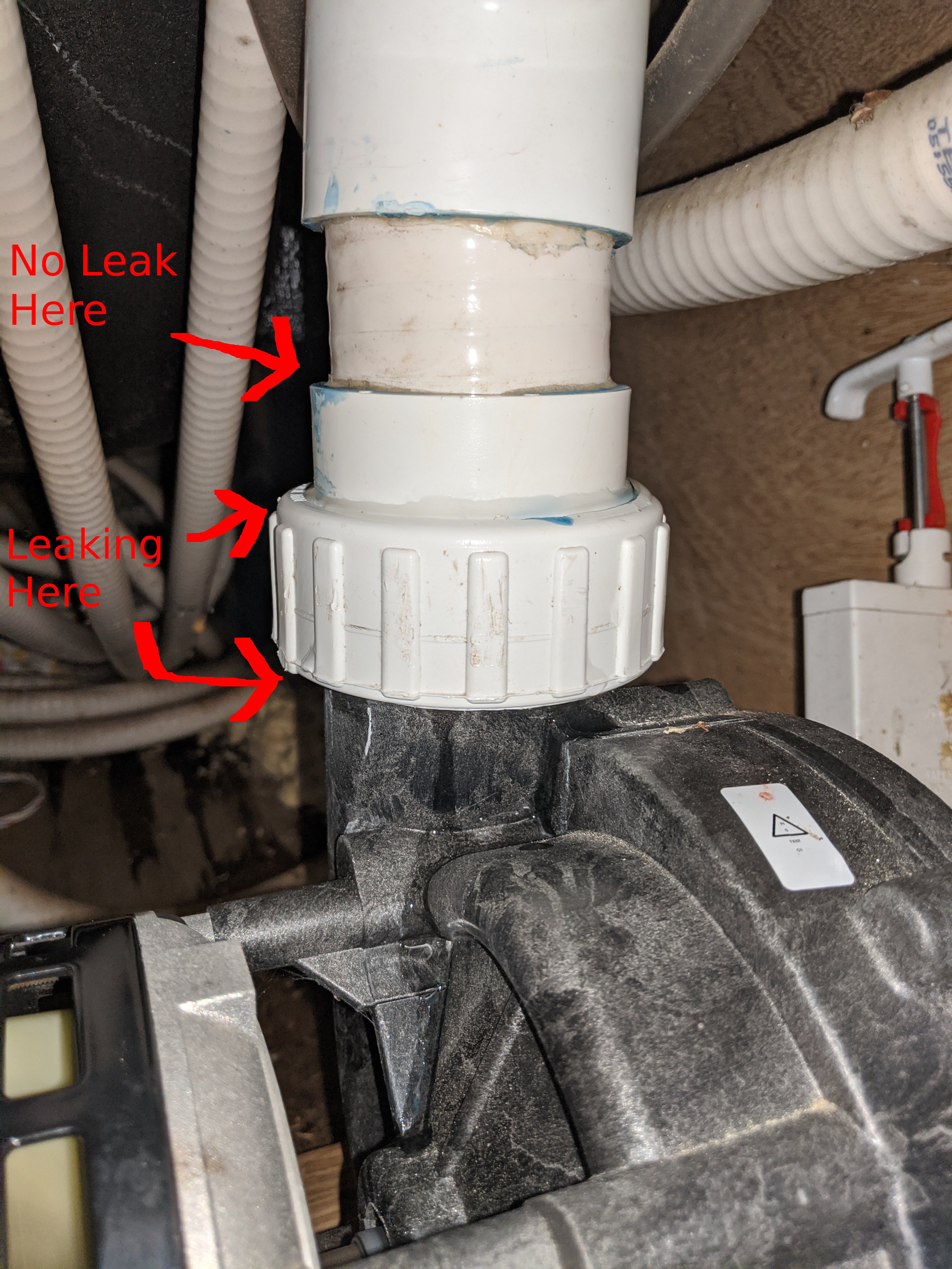

bmbouter Posted April 26, 2020 Report Posted April 26, 2020 I have a Leisure Bay G2 spa, and I've noticed some water leaking from the base when I power on the pumps. It comes from a specific spot so today I opened it up and here is what I found (see annotated pic and video). While the 2-speed motor is running, I can see a drip-leak coming from the pvc junction above the wet-end. Additionally, there is a drip-leak from the wet-end itself, but I think this is likely from drip above flowing down the wet-end and dripping underneath it. I replaced this pulp in early 2018 and the new wet-end came with it so I'd be surprised if the wet-end itself was leaking, but what do you think? I added an image annotated with where the leaks I observed came from. How do I fix this? Just tighten the PVC? Could the joint be too tight? As I remember it I used a strap wrench to do it last time? Are there O-rings or anything inside of here? Should I replace the union? What kind of parts would I buy? VID_20200425_144451.mp4 Quote
RDspaguy Posted April 26, 2020 Report Posted April 26, 2020 Well, the top arrow would be a bad glue joint, but everything else could just be an o-ring. How sure are you that it is leaking from the glue joint? My internet is bad out where I live so your video didn't really play, it took a minute and a half to watch your 14 second clip. Quote
Cusser Posted April 26, 2020 Report Posted April 26, 2020 My "guess": The top leak/arrow indicates an imperfect glue job when that fitting was glued to the PVC pipe. Assuming that the lower two arrow leaks are NOT from the above leak dripping down, those two are from the rubber seal of the threaded fitting. Either tightening or replacement of the rubber seal should help that. As to the upper leak: if you don't want to replace that, or can't, possibly when fully dry and the threaded part disconnected PVC cement could be applied to the area, and possibly seep down into the poorly-cemented region. Quote
RDspaguy Posted April 26, 2020 Report Posted April 26, 2020 That is not likely to work, but runs a fair chance of glueing the union on, then to can buy a new pump too. If you are going to attempt a band-aid, it needs to be inside the thoroughly sanded pipe, not outside with pressure behind it. PVC cement is meant to be between two surfaces, not slathered on like icing on a cake. Epoxy putty would be the material to use. But you will be fixing it again in a year or two, so just fix it right the first time and be done. Quote
CanadianSpaTech Posted April 26, 2020 Report Posted April 26, 2020 Looks to me that the o-ring started to fail so the union was tightened and caused the glue fitting above to rotate a bit and leak. With the amount of plumbing above that joint you are only going to get 1 shot at replacing the union and tail piece. You will need a 2" pump union https://www.vanislewater.com/Waterway-2-Half-Union-Pump-Assembly , a 2" line coupler https://www.vanislewater.com/2-Pipe-Extension-Fitting-Spigot-x-Internal-Schedule-40-Pipe-PVC-Schedule-40 and some glue. Cut the plumbing as close to the top of the union tail piece as possible and dry fit before gluing. You may have to remove the pump to dry fit the new connections and put the pump back into place to make sure everything is going to fit in place. Quote
RDspaguy Posted April 26, 2020 Report Posted April 26, 2020 I am not sure there is room for a coupler. Could fit a drain fitting (the short coupler) but that's as high pressure as a fitting gets in that tub, so it's risky. A repair adapter would work, but then we are reducing inside diameter at the pump, which could make a noticeable difference in jet pressure. Can you post a pic of the plumbing above that fitting? Quote

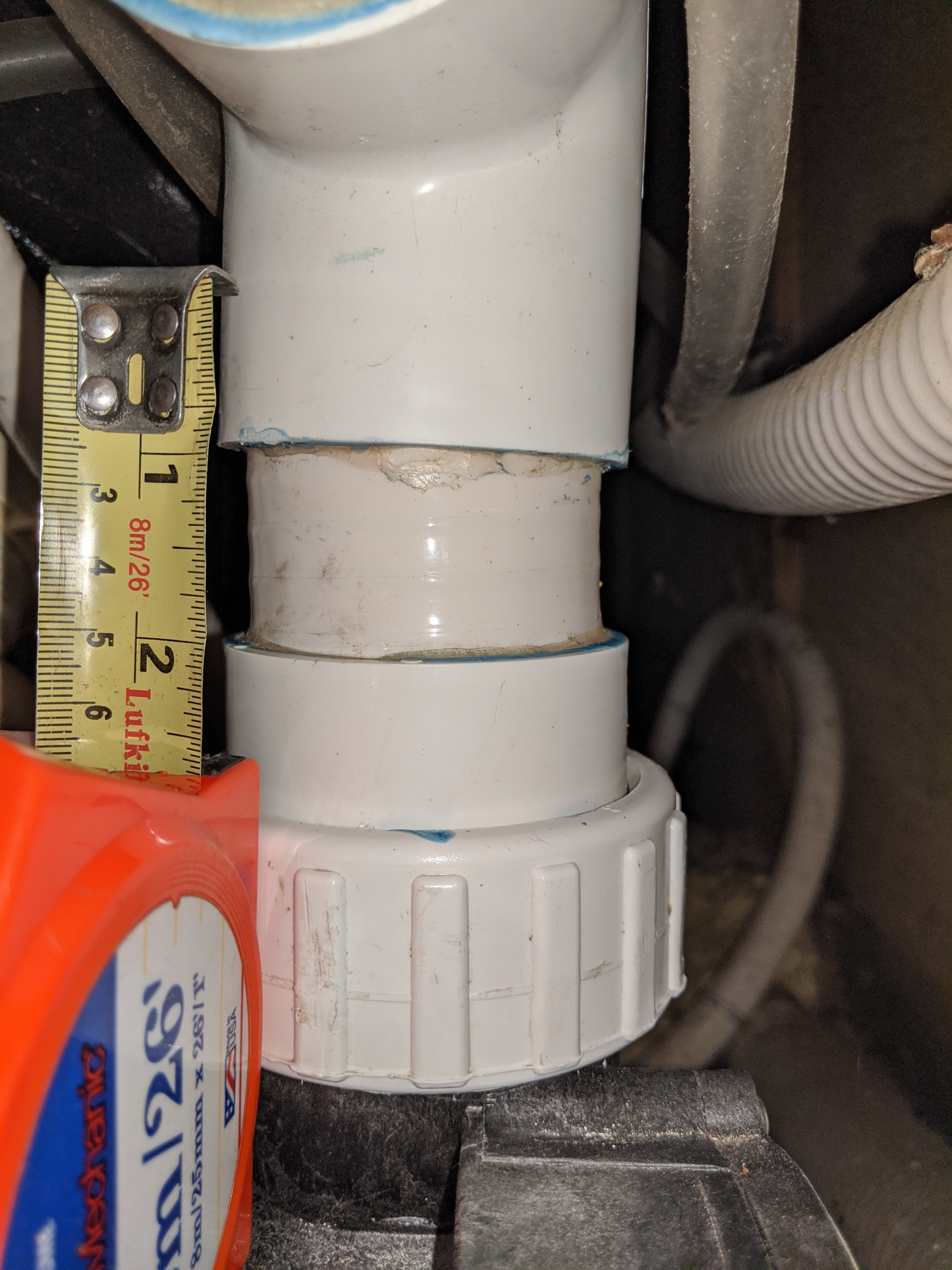

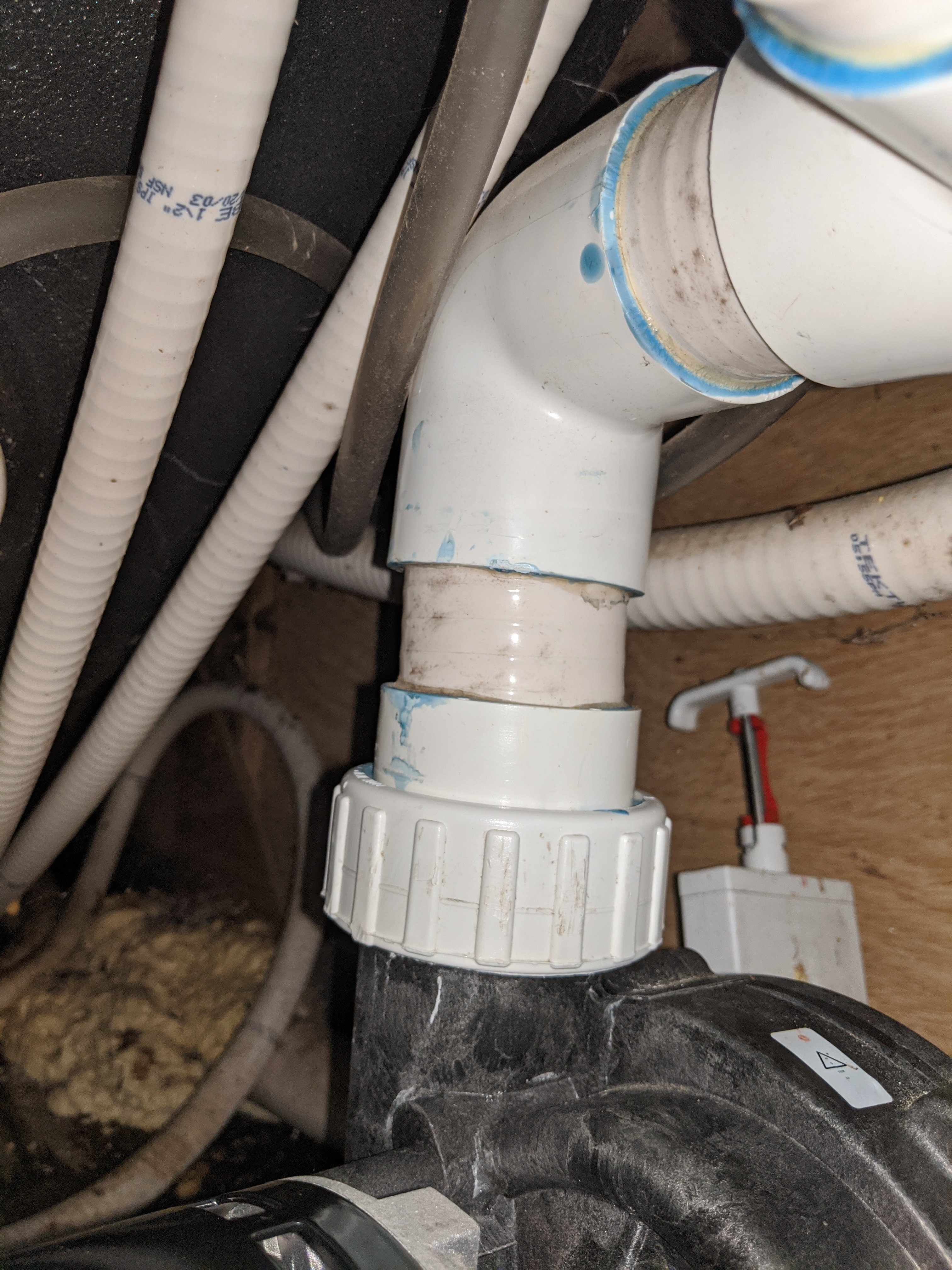

bmbouter Posted April 27, 2020 Author Report Posted April 27, 2020 Thank you to all the responses so far! Here is a correction from my original post; it is only leaking around the O-ring coupler, *not* from the PVC junction. See the new annotated photo for clarity. I've also included additional photos of the surrounding plumbing as asked. Since it leaks only from the top and bottom of the union, is replacing the O-ring what I should do? Do I replace just the O-ring or do I have to replace the union? How much should I tighten the union by rotating it? Last time I used a strap wrench. I don't mind the PVC work, but I can see how one junction could lead to another and another. I do want to do the job right, not a band-aid. Advice is appreciated! What do you think I should do? Quote
RDspaguy Posted April 27, 2020 Report Posted April 27, 2020 Easy. Get a new o-ring. Or a gasket. https://www.spadepot.com/O-Ring-AquaFlo-Pump-Union-P1622 https://www.spadepot.com/Spa-Pump-Heater-O-Ring-Gasket-2in-2-Pack-P1559 Quote
CanadianSpaTech Posted April 27, 2020 Report Posted April 27, 2020 Yeah just slide in a new gasket or O-ring. I usually just slide in a 2" flat gasket and leave the old o-ring. A lot of times the gasket with the O-ring attached won't fit the groove on a pump union so on pumps I just use a 2" flat gasket and charge $100 cash and go for lunch. Looking at the last photo it looks a little crooked and you might have a hard time getting the union to sit flat even when tight for a waterproof seal. In this case use a heat gun and warm the soft 2" plumbing a bit...then go for lunch 1 Quote

bmbouter Posted April 29, 2020 Author Report Posted April 29, 2020 I ordered the 2" gaskets https://www.spadepot.com/Spa-Pump-Heater-O-Ring-Gasket-2in-2-Pack-P1559 Thanks for all the replies! I'm going to install these when they come in and then go to lunch. 2 Quote
CanadianSpaTech Posted April 29, 2020 Report Posted April 29, 2020 Again...when you loosen the coupler have a look at how it sits/fits to the top of the pump and see if the plumbing side is tilted making it hard to get good compression when tightening. If it is off kilter a bit use a heat gun and warm the plumbing up. 1 Quote
bmbouter Posted April 29, 2020 Author Report Posted April 29, 2020 Will do! I have a heat gun so I can accomplish it. I believe this was a contributing problem to the first installation so I'll be paying close attention to it. Thanks again. Quote
bmbouter Posted June 4, 2020 Author Report Posted June 4, 2020 I wanted to come back to this group and say THANKS! I replaced the o-ring at the wet-end, and then went to lunch. 1 Quote
