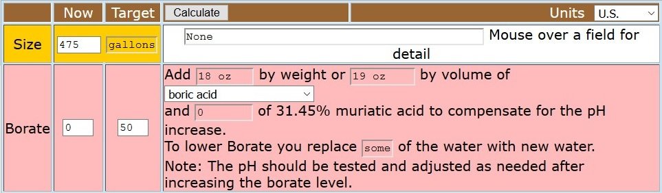

Finally decided to read nitros bleach method and look up the acronyms that I did not know. Using muratic acid( lots of it) I have brought my TA down to the point where the PH settled at 6.8 . Boric acid is showing up tomorrow and I'll be adding 32oz (weight) to get a 50ppm boric load for buffering the low TA.

Don't add the boric acid until after you decontaminate, drain and refill. I have a 450 gallon spa and add 17.2oz of boric acid to get 50ppm borates. You might want to recheck your calculations.
