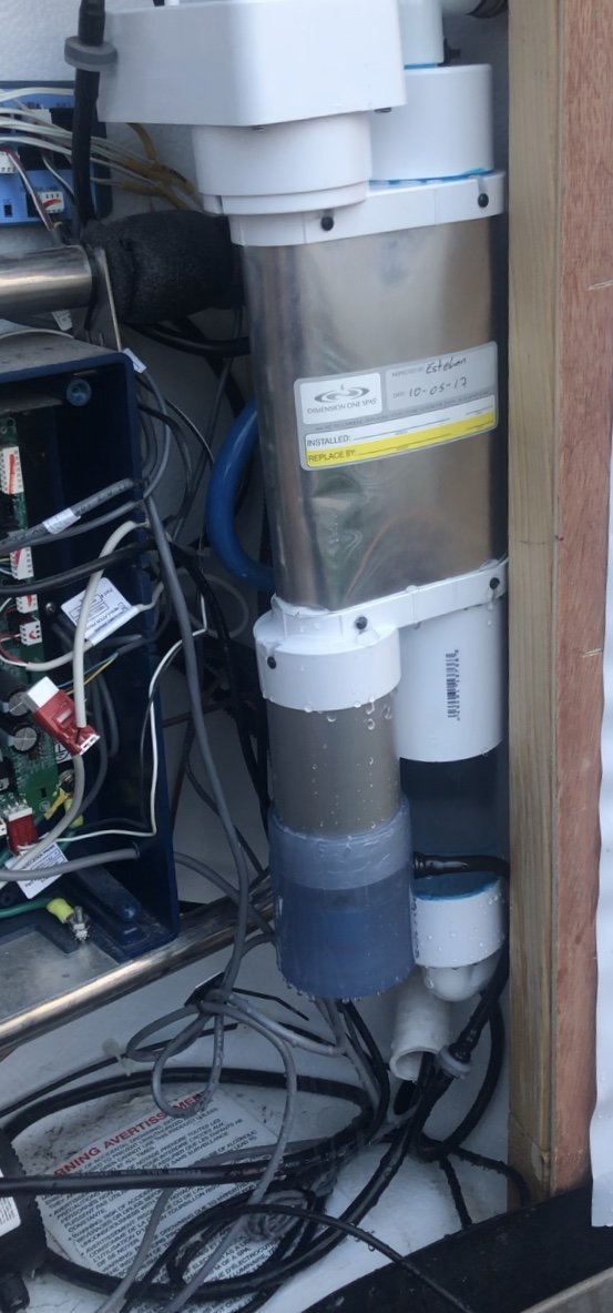

GMBEACH Posted July 15, 2019 Report Share Posted July 15, 2019 We recently got a used Dimension One, Amore Bay spa. When we fill it, water starts leaking from the ozonator. We just purchased a new ozonator, and that one is also leaking. Not sure if we are doing something wrong, or the part was bad. I am attaching a video, don’t mind me talking. The company is sending out a new part. Any help is greatly appreciated! 34314A11-1903-4494-9683-3A4B133B2C51.MOV Quote Link to comment Share on other sites More sharing options...
GMBEACH Posted July 15, 2019 Author Report Share Posted July 15, 2019 I am unable to load the video, this is a picture of it. Quote Link to comment Share on other sites More sharing options...
d1dennis2009 Posted July 18, 2019 Report Share Posted July 18, 2019 Yes, the glass tube inside is being damage in shipping. This happens pretty often with the UP+ assembly, hopefully the shipper is wrapping it properly this time. Quote Link to comment Share on other sites More sharing options...
