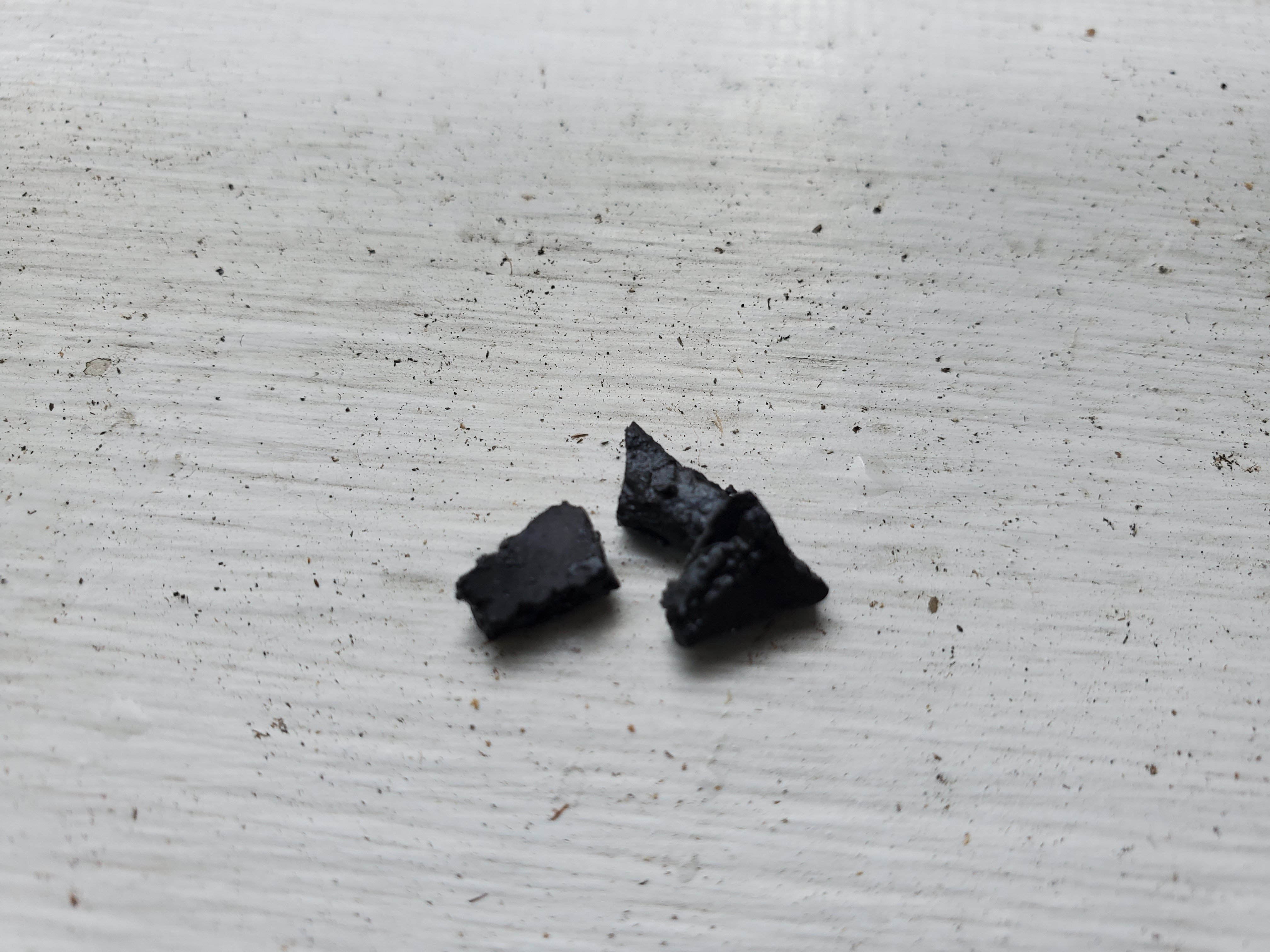

Chann Posted July 19, 2020 Report Posted July 19, 2020 Hello, I just purchased a Royal Sovereign II from my family and the moto massage hasn't worked since we had it moved. Also the knob for the moto massage does nothing. It doesn't increase the water pressure in the dual jets or decrease it. So I tried removing the knob and tried blowing air into the air tube and where the valve went. Nothing helped and then a few pieces of black rubber came out of the waterfall. Quote

Foxy1 Posted September 25, 2020 Report Posted September 25, 2020 The obstruction or "plug" could be something simple like a bit of rubber from an old air valve seal that has broken away from the valve seal and been sucked down the air tube or possibly, but slim outside chance... some silicon grease (small lump), again sucked into the air tube. This could happen from over application of the grease to the rotating valve, then constant turning of the valve then its sucked down causing a blockage. Quote

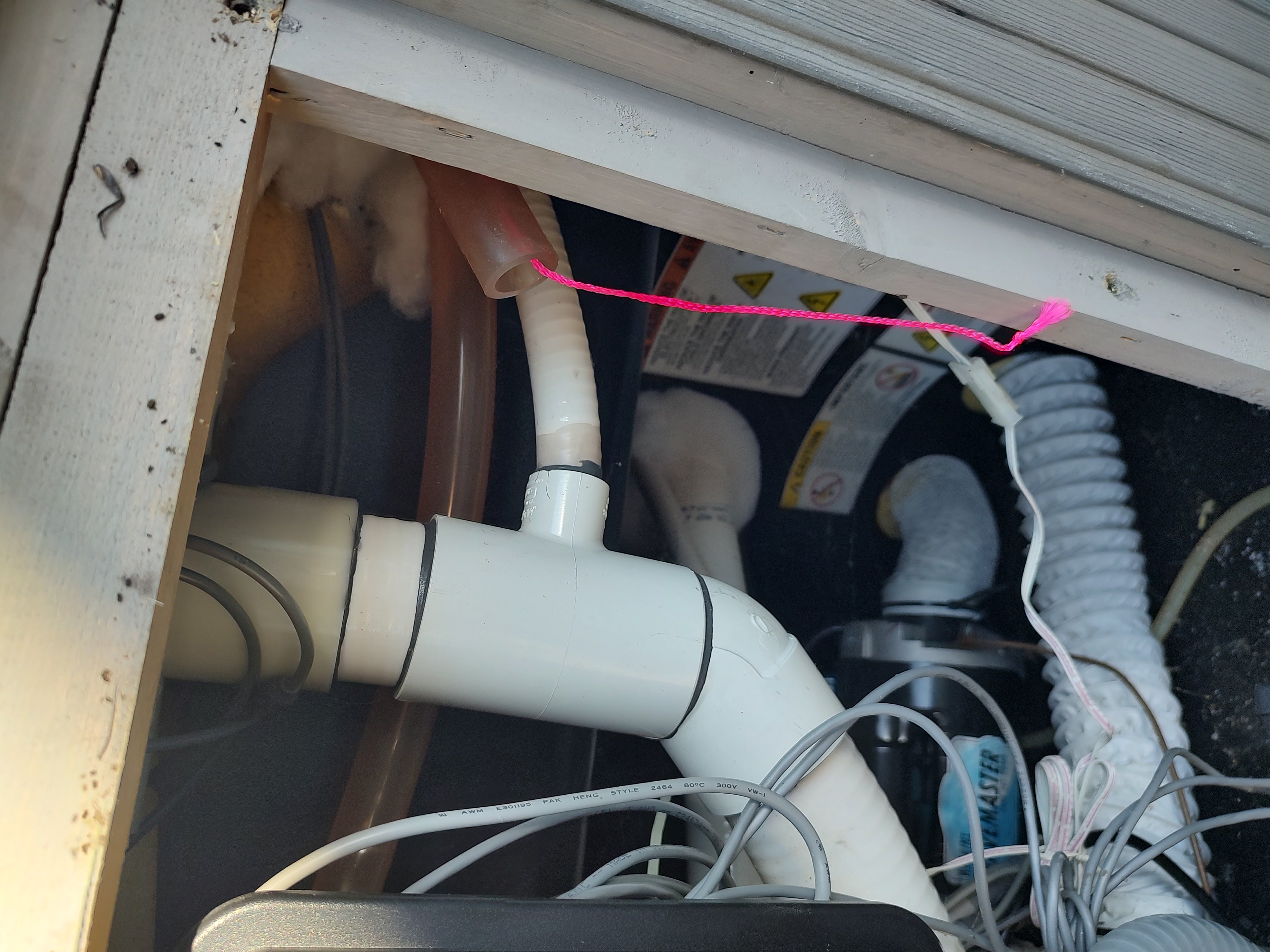

dlevitt Posted September 2, 2022 Report Posted September 2, 2022 I'll keep trying to snake through the Moto massage to find the possible blockage. I was curious to know if the clear tubing (with the chase string) is there to let air into the system. Could this be blocked? Sorry for the sideways picture... Quote
ratchett Posted September 5, 2022 Report Posted September 5, 2022 On 9/2/2022 at 10:19 AM, dlevitt said: was curious to know if the clear tubing (with the chase string) is there to let air into the system. Could this be blocked? Sorry for the sideways picture... That chase wire to run speaker wire to the optional speaker compartments - the pink line is installed at the factory to make life easy for dealer's techs to quickly run speaker wiring around the tub after delivery. They are not connected to any air lines going inside the hot tub. Quote
