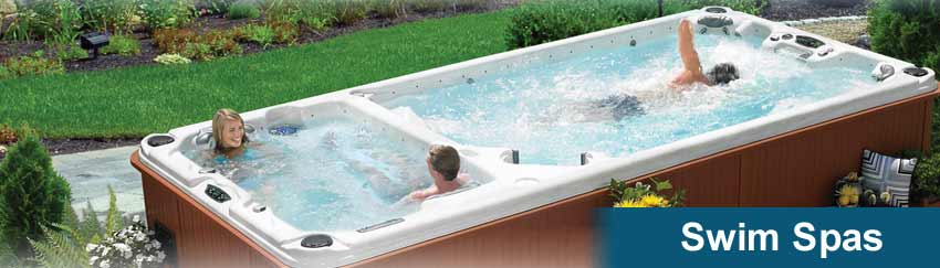

danthespaman316 Posted July 8, 2017 Report Share Posted July 8, 2017 The units I'm talking about are self-contained. All of the equipment is located within the unit's cabinet. They're purchased, delivered and set up as 1 packaged unit. It's literally a giant hot tub with specialized swim jets (see picture). The wrap keeps noise from getting outside the cabinet, full foam keeps it from echoing throughout the tub. If you go with something like an Endless Pool which is typically configured closer to an inground pool build, I assume that you can locate the equipment up to 30ish feet away from the unit. However, you would have to build some sort of housing around the equipment to deaden noise to the equivalency of a "portable" swim spa. Seeing one first hand would be your best bet. Quote Link to comment Share on other sites More sharing options...
