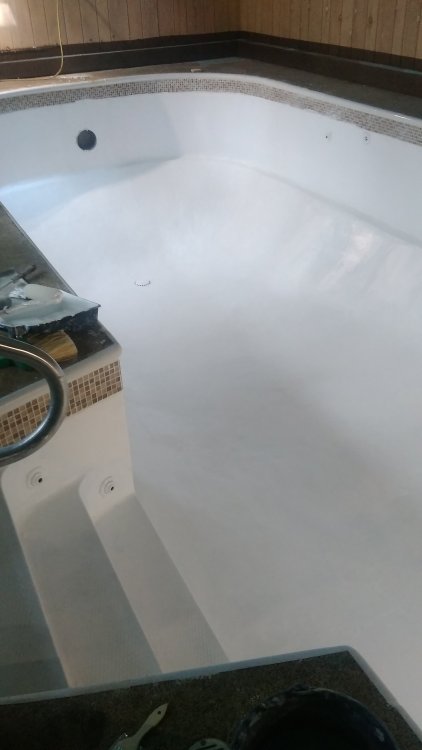

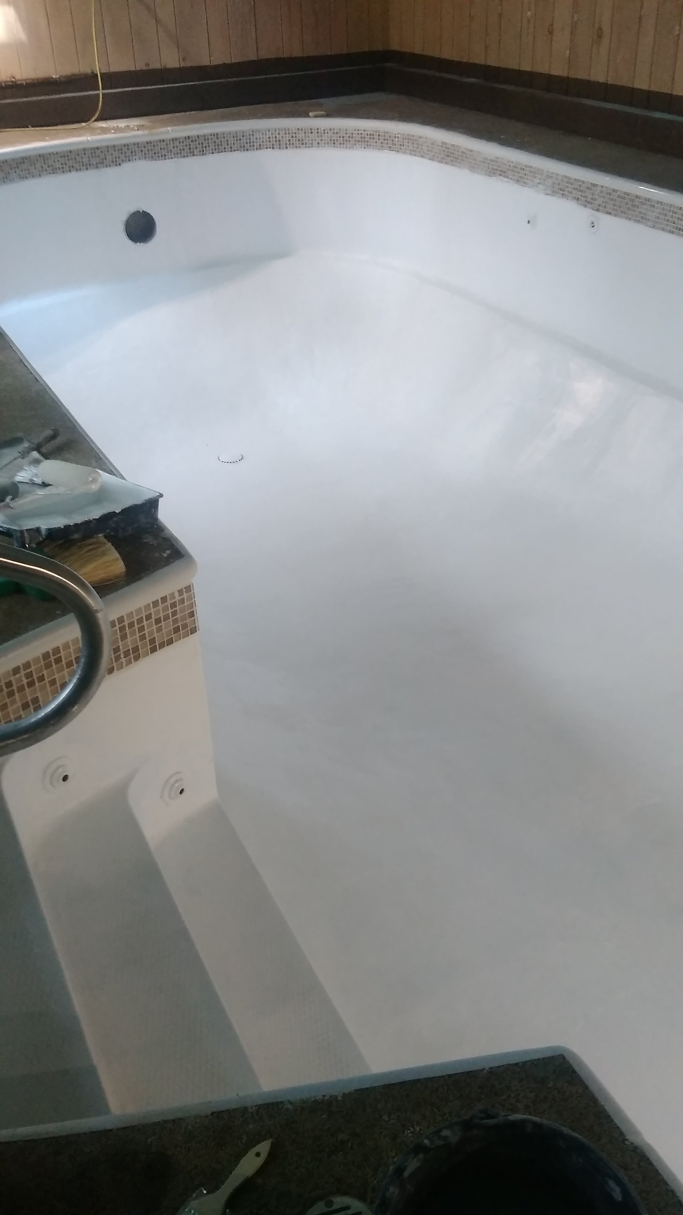

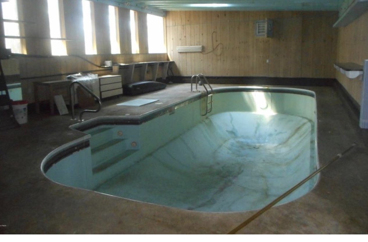

AlexPA Posted June 26, 2018 Report Posted June 26, 2018 I’m closing on a house that has this type of pool, and I’ve had two pool repair companies that aren’t familiar with these types of pools that have quoted me 20k for converting to concrete pool. It’s an indoor pool that has been closed for 5 years, and was operational when closed. I did have someone offer me a quote to tile and paint pool for $3500 but I don’t feel that is correct for this style pool. Can someone advise me what to do, and building a new pool is out of the question for us. I’ve included a photo. Quote

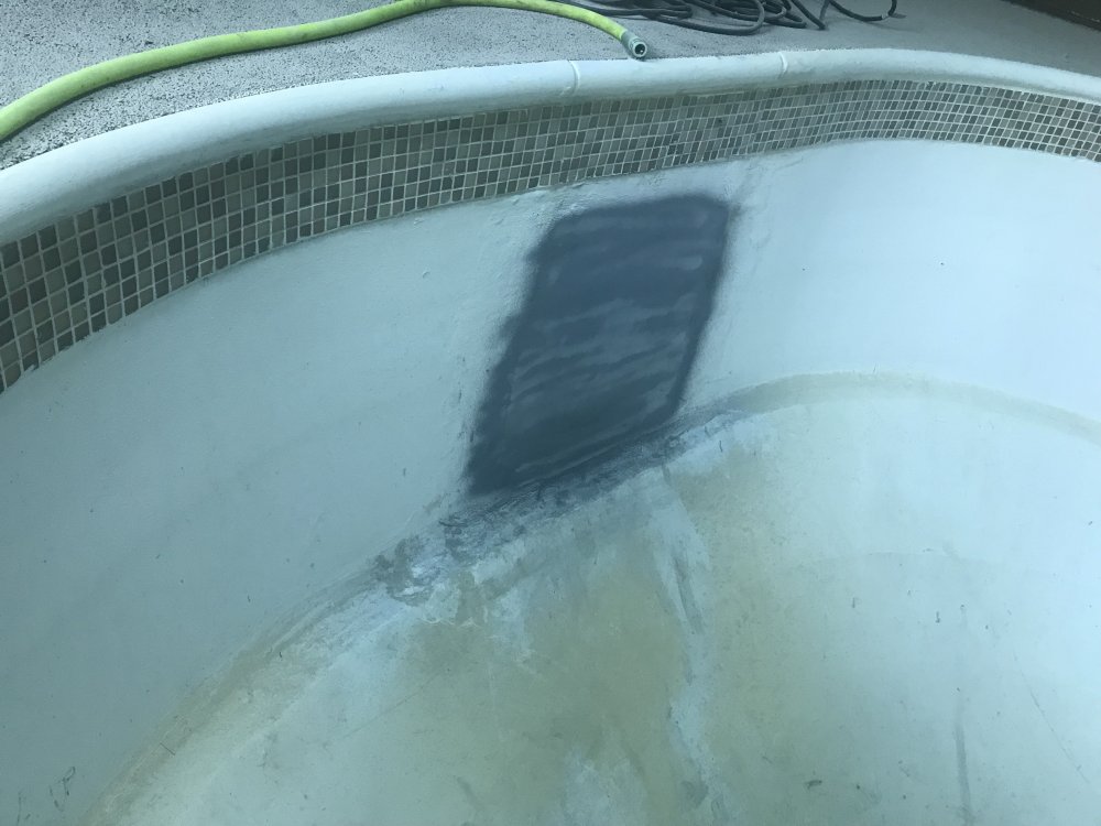

AlexPA Posted June 26, 2019 Report Posted June 26, 2019 I had the pool professionally painted, but needed to patch a whole after where the pool guy attempted to put a light. Wondering if I need to repaint whole pool, or if I can paint patch spot. Quote
