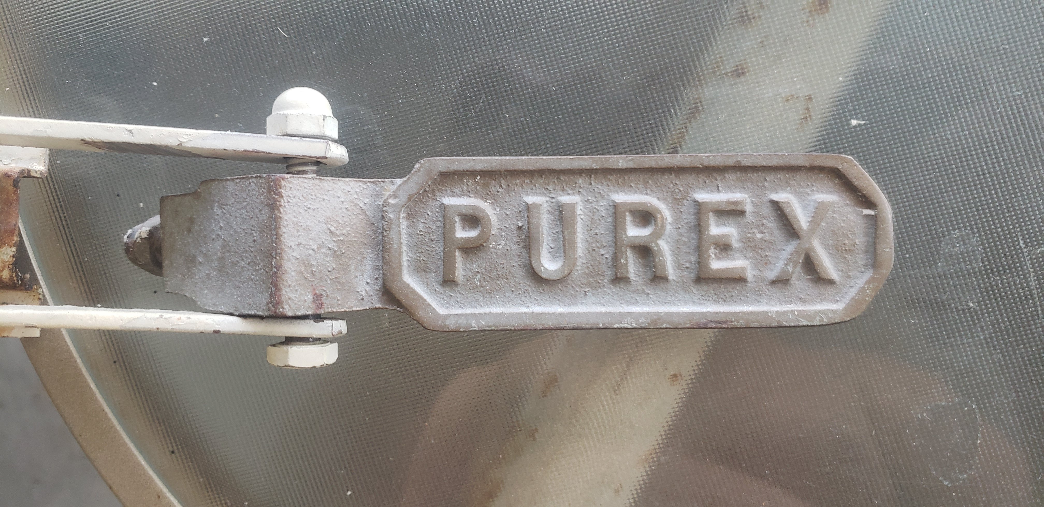

sverny Posted July 26, 2023 Report Posted July 26, 2023 I have a brand new pentair quad DE filter and cleaned it for the first time. Everything went well until the final step of putting on the lid. It has a big spring on top of the manifold that pushes the lid off the seat when trying to put on the rather heavy circular clamp. I am 69 years old and my back is killing me from bending over trying to get this damn clamp on and trying to get the lid to seat uniformly and then when trying to get the long clamp screw in the mounting hole the whole damn thing falls. EXTREMELY FRUSTRATING AND I AM GETTING BACK SORE AND HOT FROM THIS SUPPOSEDLY EASY METHOD!!!!! I terribly miss my old purex filter with the lid that fits OVER the o-ring and the purex logo brass swing clamp handle. Anyone remember that?? C'MON PENTAIR!!! THERE'S GOT TO BE AN EASIER DESIGN FOR THIS SORT OF CLAMP!!!! Quote
waterbear Posted July 26, 2023 Report Posted July 26, 2023 Not sure why you are having these problems. The lid should fit on with no problems and the spring should not be pushing it off. Perhaps these YouTube videos might help. https://www.youtube.com/watch?v=BLJvkeW5wtY https://www.youtube.com/watch?v=9UhnyRNjrkM&t=59s (FWIW, I am also 69 years old but I have found that Pentair filters are one of the easier ones to maintain.) DE filters are more work than sand filters in general and Purex IS Pentair. All new filters are sold under the Pentair brand, the Purex brand was retired many years ago. Comparing maintenance on a sand filter and a DE filter is literally comparing apples to oranges. Quote
