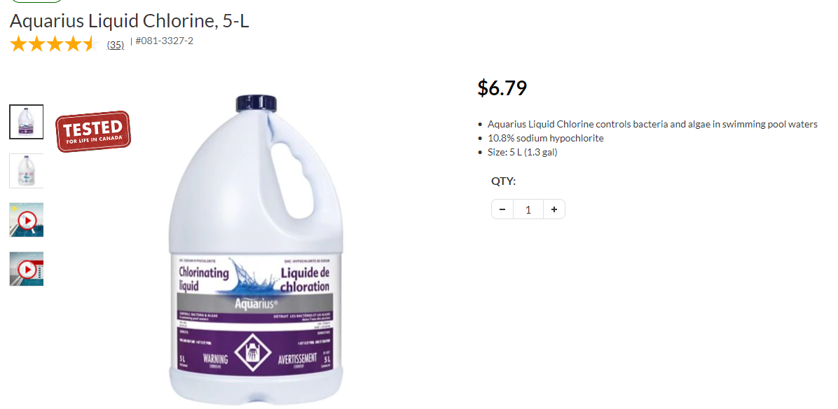

orellius Posted November 4, 2020 Report Share Posted November 4, 2020 Quick quiestion. For the Dichlor/bleach method, I am just starting this in a 6 month old RotoSpa tub. Fresh water put in on the weekend. Is this type of chlorine recommended at all? It's for pools, but all the local Clorox I can find, just says "concentrated" but no chlorine content info (no %). I'm guessing it's good if not better, but higher concentrate so use less? Cheers https://www.canadiantire.ca/en/pdp/aquarius-liquid-chlorine-5-l-0813327p.html#srp Quote Link to comment Share on other sites More sharing options...
waterbear Posted November 4, 2020 Report Share Posted November 4, 2020 Canadiantire's website states that their Aquirius Liquid Chlorine is 10.8% so it's 10% pool chloirne and it's fine to use. You will need less. Pool chlorine is usually either 10% or 12.5% while household liquid chlorine bleach is usually either 6%, 5.25%, or (for some of the bargain ones at such places as dollar stores) 3% and usually not a good value for the money. Any will work, the only difference being the amount needed to reach a specific free chlorine level. The ingredient should be sodium hypochlorite. The percentage on the container (6%, 10%, 12.5% , etc. ) is the MINIMUN guarenteed percentage and is often higher in a fresh container to make up for the ineviblabe chlorine loss from strorage. Household liquid chlorine bleach is difficult to find these days because of Covid 19 but I have seen pool chlorine in such places as Walmart, Home Depot, Ace Hardware and, of course, many pool supply stores. IF you can't find sodium hypochlorite then, as long as your calcium hardness is not too high, you can use calcium hypochlorite (cal hypo) from a pool supply store. It is normally sold in 1 lb bags as a pool shock but not all pool shock is cal hypo. This is also a form of chlorine that will not raise cyanuric acid but it will raise calcium hardness so you want to monitor that and when it gets very high (about 400 ppm) you should do a water change or, at least, a partial water change, to lower it. If you normal fill water is high in calcium the only other option is lithium hypochlorite shock, also sold in bags as a pool shock but it is very expen$ive b comarison to liquid chlroine and cal hypo. You want a product that is just calcium hypochlorite (ususally listed as 55% or higher on the lable,. It comes in different strengths but any will work, just the amount needed for a certain Free Chlorine level will vary . You don't want a product that also contains algaecide, copper, clarifiers, or a 4 in 1 or 5 in one or 3 in one shock. Same goes for the Lithium Hypochirite shock. You do not want to use a product that is either dichlor (Sodium Dichloro-S-Triazinetrione) or trichlor (Trichloro-S-Triazinetrioneonce or Trichloroisocyanuric acid) once you have reached your desired CYA level as these both add cynauric acid. Hope this is helpful. Quote Link to comment Share on other sites More sharing options...
orellius Posted November 4, 2020 Report Share Posted November 4, 2020 3 minutes ago, waterbear said: Canadiantire's website is currently down. However, pool chlorine is usually either 10% or 12.5% while household liquid chlorine bleach is usually either 6%, 5.25%, or (for some of the bargain ones at such places as dollar stores) 3% and usually not a good value for the money. Any will work, the only difference being the amount needed to reach a specific free chlorine level. The ingredient should be sodium hypochlorite. Household liquid chlorine bleach is difficult to find these days because of Covid 19 but I have seen pool chlorine in such places as Walmart, Home Depot, Ace Hardware and, of course, many pool supply stores. IF you can't find sodium hypochlorite then, as long as your calcium hardness is not too high, you can use calcium hypochlorite (cal hypo) from a pool supply store. It is normally sold in 1 lb bags as a pool shock but not all pool shock is cal hypo. This is also a form of chlorine that will not raise cyanuric acid but it will raise calcium hardness so you want to monitor that and when it gets very high (about 400 ppm) you should do a water change or, at least, a partial water change, to lower it. If you normal fill water is high in calcium the only other option is lithium hypochlorite shock, also sold in bags as a pool shock but it is very expen$ive b comarison to liquid chlroine and cal hypo. You want a product that is just calcium hypochlorite (ususally listed as 55% or higher on the lable,. It comes in different strengths but any will work, just the amount needed for a certain Free Chlorine level will vary . You don't want a product that also contains algaecide, copper, clarifiers, or a 4 in 1 or 5 in one or 3 in one shock. Same goes for the Lithium Hypochirite shock. You do not want to use a product that is either dichlor (Sodium Dichloro-S-Triazinetrione) or trichlor (Trichloro-S-Triazinetrioneonce or Trichloroisocyanuric acid) once you have reached your desired CYA level as these both add cynauric acid. Hope this is helpful. Thanks for the reply, this is 10.8% SHC. Quote Link to comment Share on other sites More sharing options...
waterbear Posted November 4, 2020 Report Share Posted November 4, 2020 Their website came back and I edited my reply. It's 10% sodium hypochlorite and it's perfect to use. You just need less! You can also use it as replacement for household bleach for sanitizing surfaces but it's approximately twice as concentrated. IT's the same chemcial, sodium hypochlorite. Quote Link to comment Share on other sites More sharing options...
