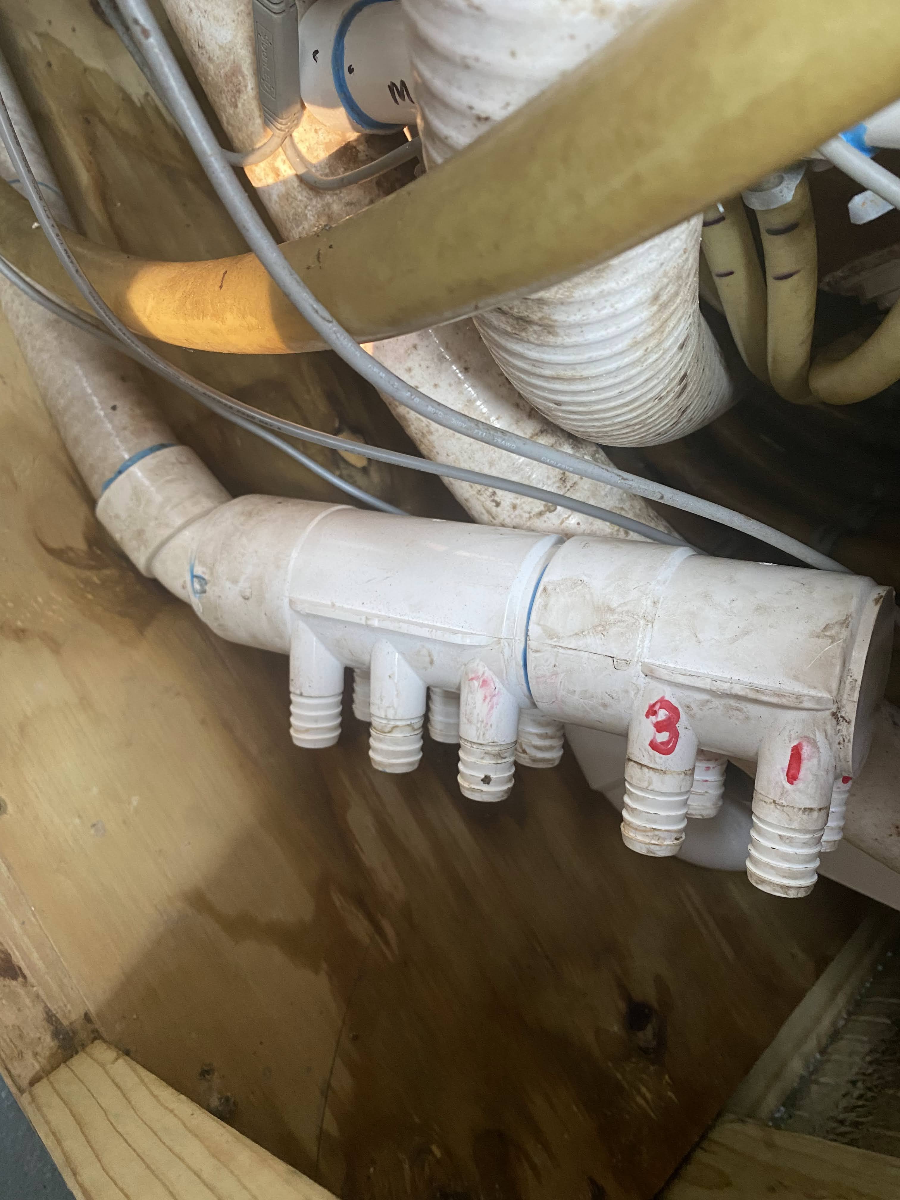

Hi All, I'm replacing a manifold on my Thermospa tub. When connection .75" ID (1" OD) hose to the manifold barbs or jet barbs, do you use PVC glue, or just use the clamps? Or something else? From what I can tell the manufacturer just used the clamps as I was able to remove the hoses with some heat and gentle twisting, but I'd like some input on the best way to put this back together. Thanks, Rob

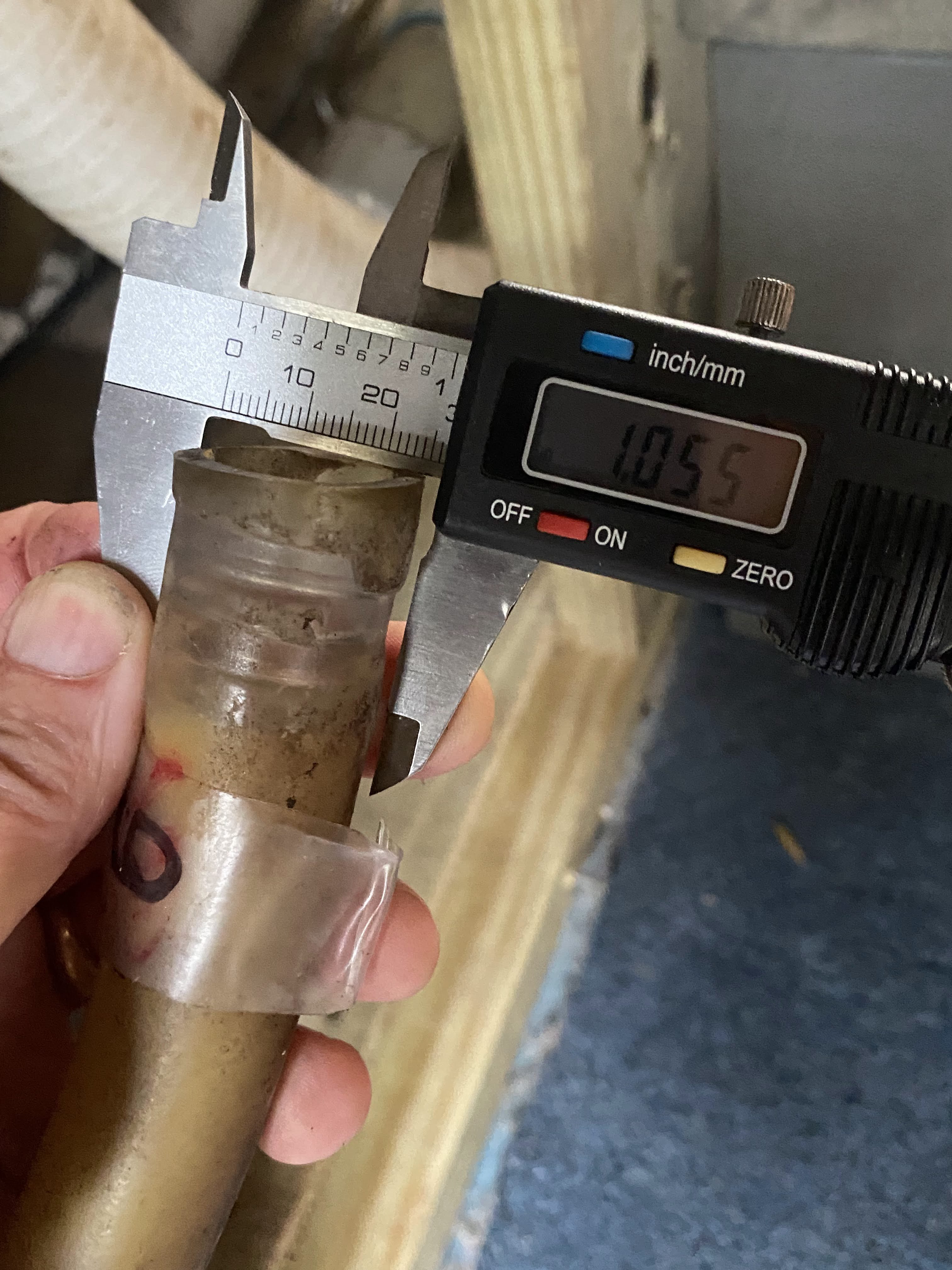

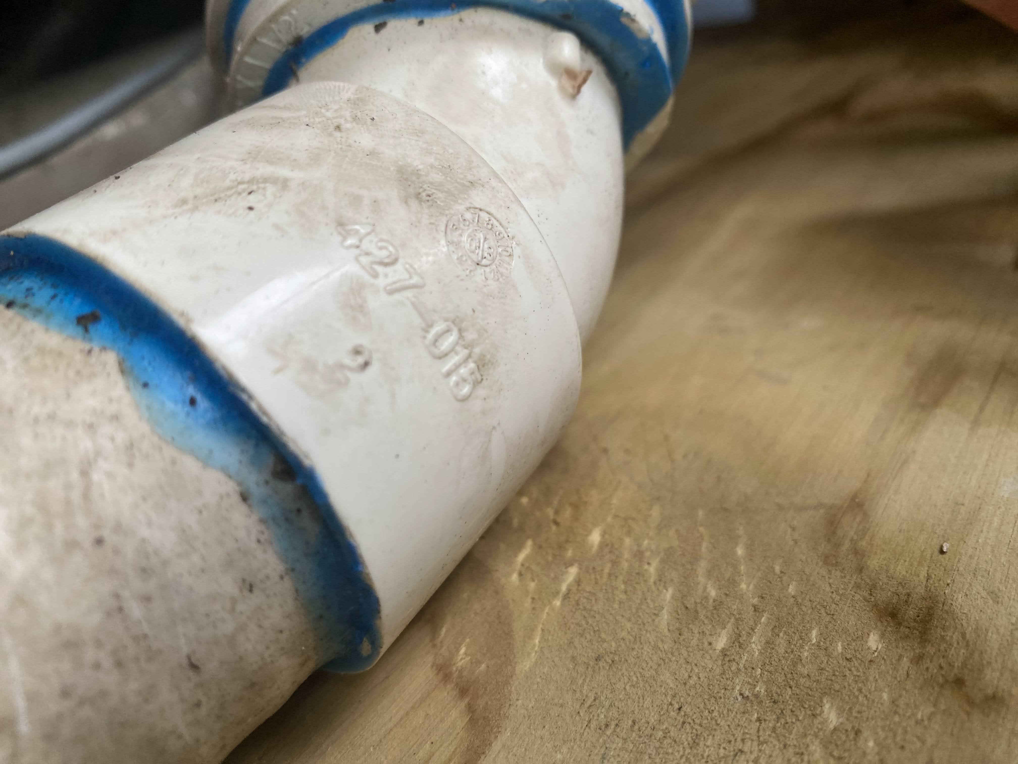

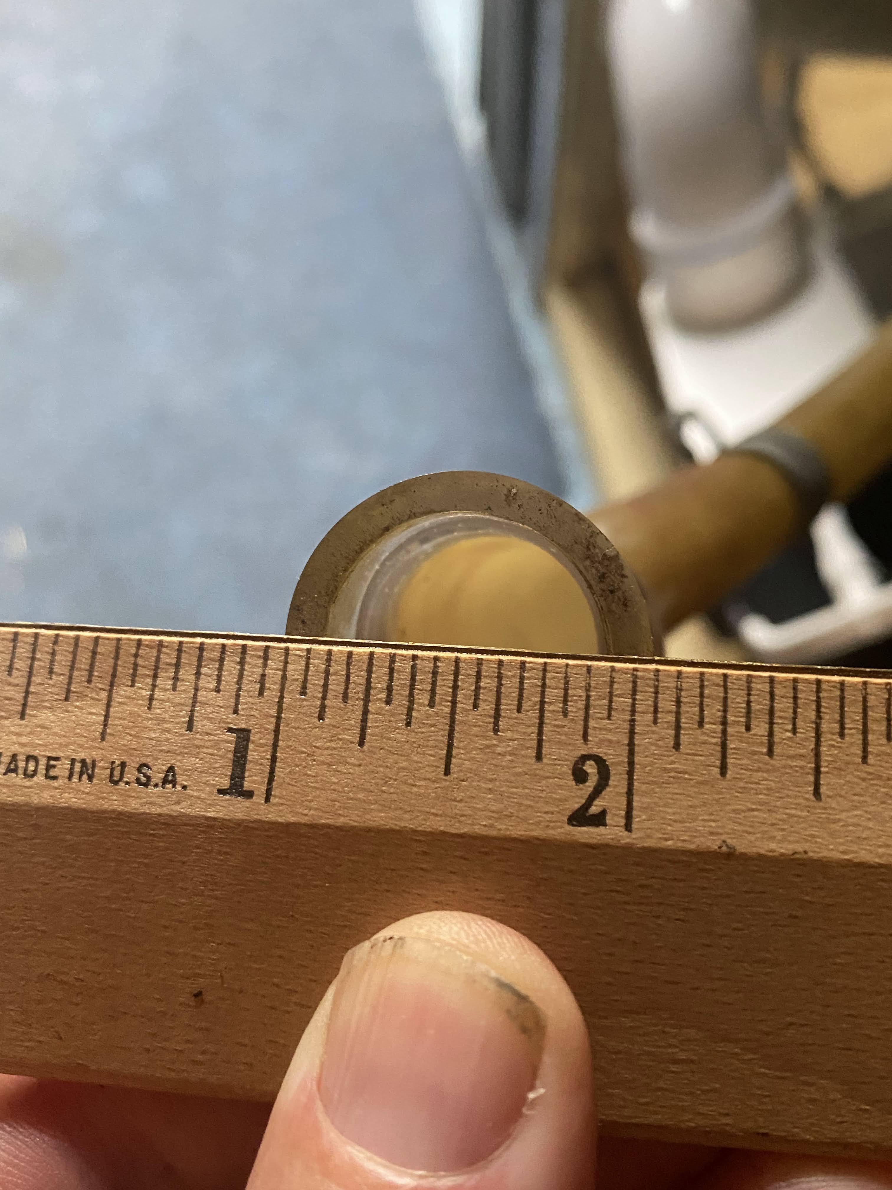

Hi All, I've got a 2009 ThermoSpa that developed a leak last week. I've identified the source and it is a water manifold. It appears to be leaking from the dead-end (I have some questions about how it may have happened, but I'll post those in a separate thread). I'm having trouble figuring out what parts to order to make this repair. The pipe that leads from the pump to the manifold is 1.5" but most if not all water manifolds I'm finding have 2" slip connections. I've included a bunch of pictures with caliper measurements in the hope that someone can help me find the correct parts. I'm speculating that somewhere around the 45' angle there is a 1.5" to 2" converter and the manifold is actually 2", but not really sure. I'm pretty sure the barbs on the manifold need to be 3/4" based on the 1" OD of the hoses. This seems to be pretty standard. Any guidance to the correct parts would be very appreciated. My plan is to cut the 1.5" pipe and make the repair from there with an extension and slip. Thanks, Rob

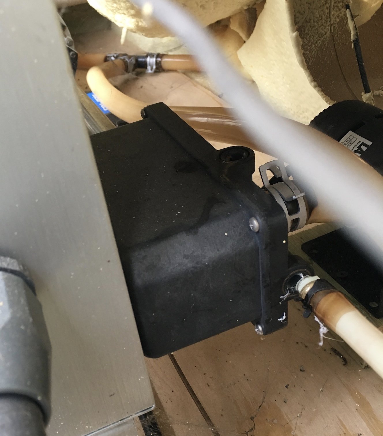

The attached picture shows a box at the rear of the spa controller on my Jacuzzi J-335. You can see in the picture that the plastic barb fitting has broken off inside the black box (lower right). Also pictured is a similar attachment point/port at the top of the black box. Firstly, any help in identifying these parts would be appreciated. Second, I have tried a couple of methods of extraction, but can't remove the remaining, male part of the barb fitting from the lower right port. It is threaded, right? Any tips for removal? Finally, I don't think there was anything attached to the port on top. Would that make sense? I would appreciate any advice in how I might get this back together...or what I should replace to get up and running. This is a J335 spa controller dated 6/3/08. Thanks.
