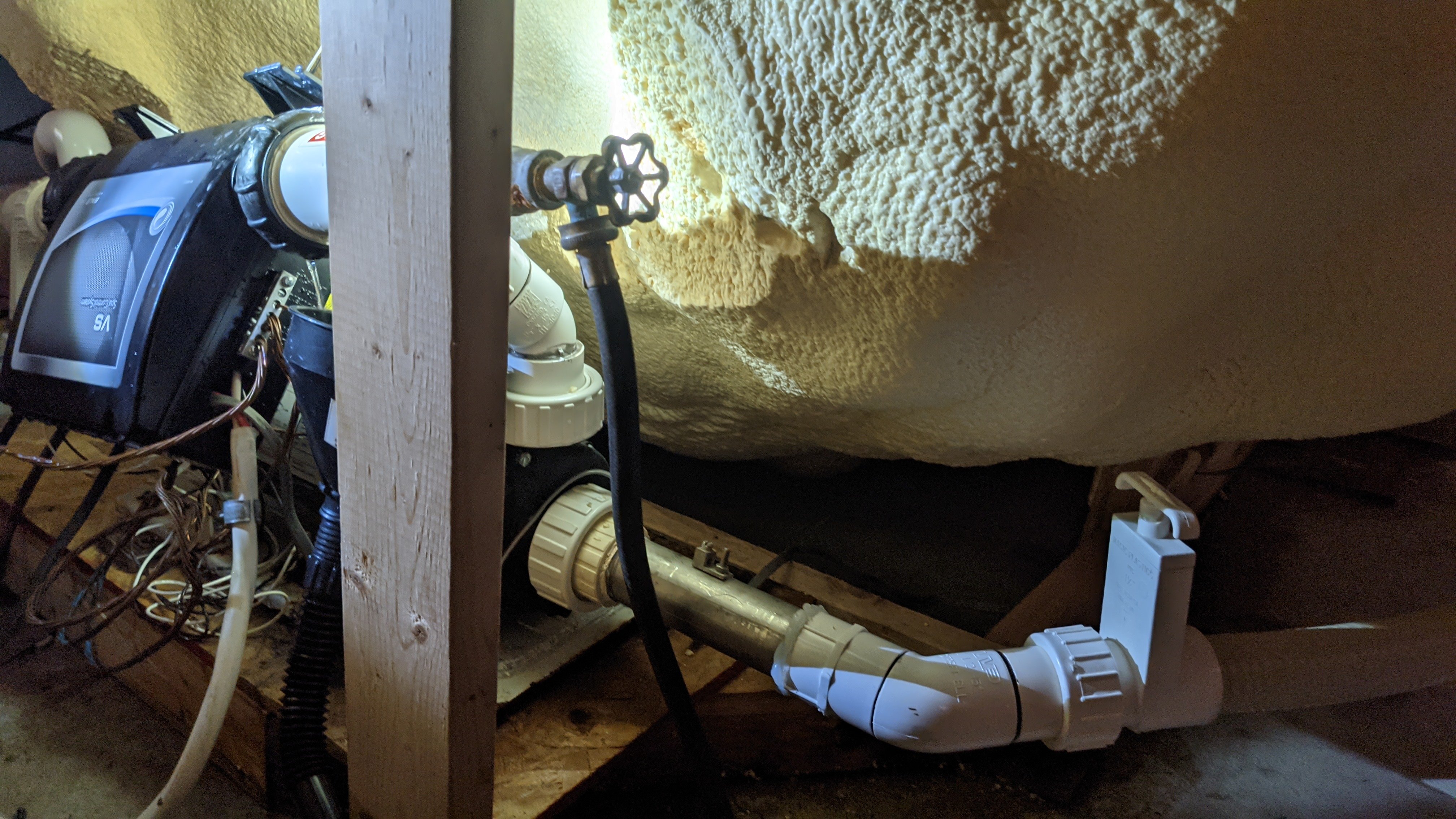

Hi folks, I moved into a new home recently with an old tub. I noticed a slow leak where the PVC joins the pump. I figured no big deal, new o-ring and some plumbers tape will fix. I pushed down the slice valves and turned them (see pics showing closed valves). They closed easily, no issues. However, when I detached the pump the water came gushing out... I waited a bit figuring was just water on the other side of the valve... But it never stopped. Has anyone had an issue where closing slice valves appears to do nothing? Didn't appear to even slow the flow. Any suggestions?

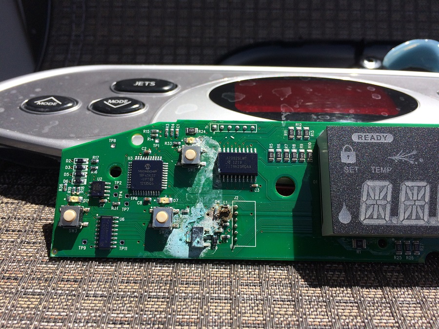

New to this forum. I have a 2013 Hot Spring Limelight series hot tub which I have had zero issues with until recently. I noticed the display letters/numbers started flickering and going off and on intermittently. Luckily, I was able to turn off the pumps and lights before the control head totally died! I removed the panel from the tub body and disassembled it, only to find that the silicon pad (3 buttons) on the left side which controls the jets and "mode up" and "mode down" settings was cracked around the base, allowing water to penetrate into the head and drip right onto the circuit board. My thoughts are this is a very poor design and if there was even a cover over the circuit board to divert water away from dripping directly onto the board, this never would have happened. Also, any parts searches are showing this control head as a complete assembly when it is easily able to be disassembled by removing a few screws. Does anyone know of a place where I can order the separate components that I need rather than having to shell out $320. plus shipping for a new unit? Any help would be greatly appreciated.

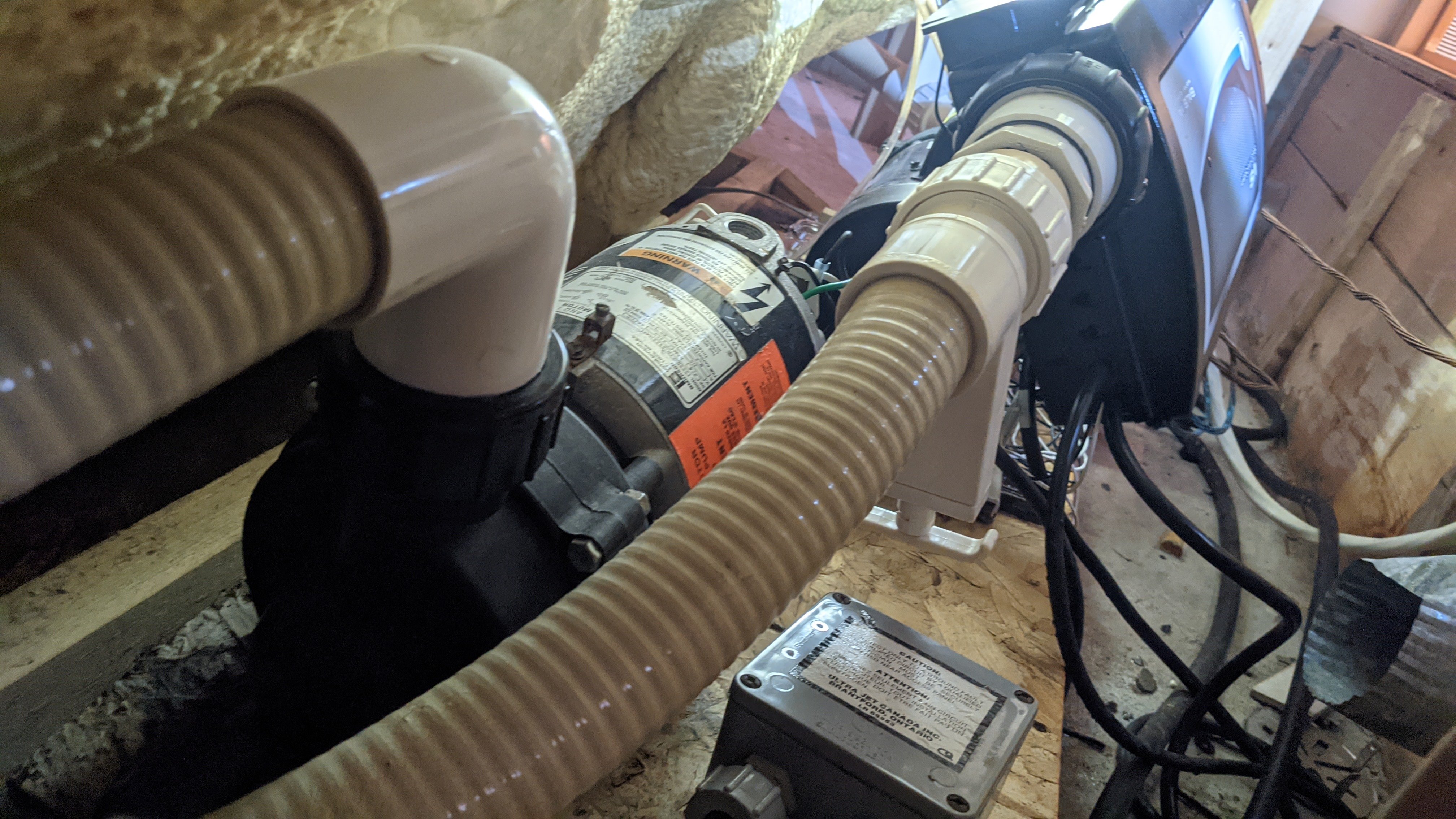

I've got a Caldera Geneva hot tub that I bought new in the fall of 2012. Aside from replacing the cover this year, I've really not had any major issues with it up until now. Yesterday, I noticed water on the ground around the edge of the spa. I pulled the side panel off to check things out. There was water around the circulation pump. It was leaking out slowly. It appears to be leaking from the large ring that you can tighten with a pair of channel lock pliers. I tightened the ring but it did nothing to stop the leak. My questions are: Is there an O ring that I can change within the large ring in the middle that I tried to tighten? If there is an O ring, where can I buy it? If there is no O ring, do I need to replace the whole pump? If I need to replace the whole pump, where is a good place to buy one? I've attached pictures to show you what I'm dealing with.
