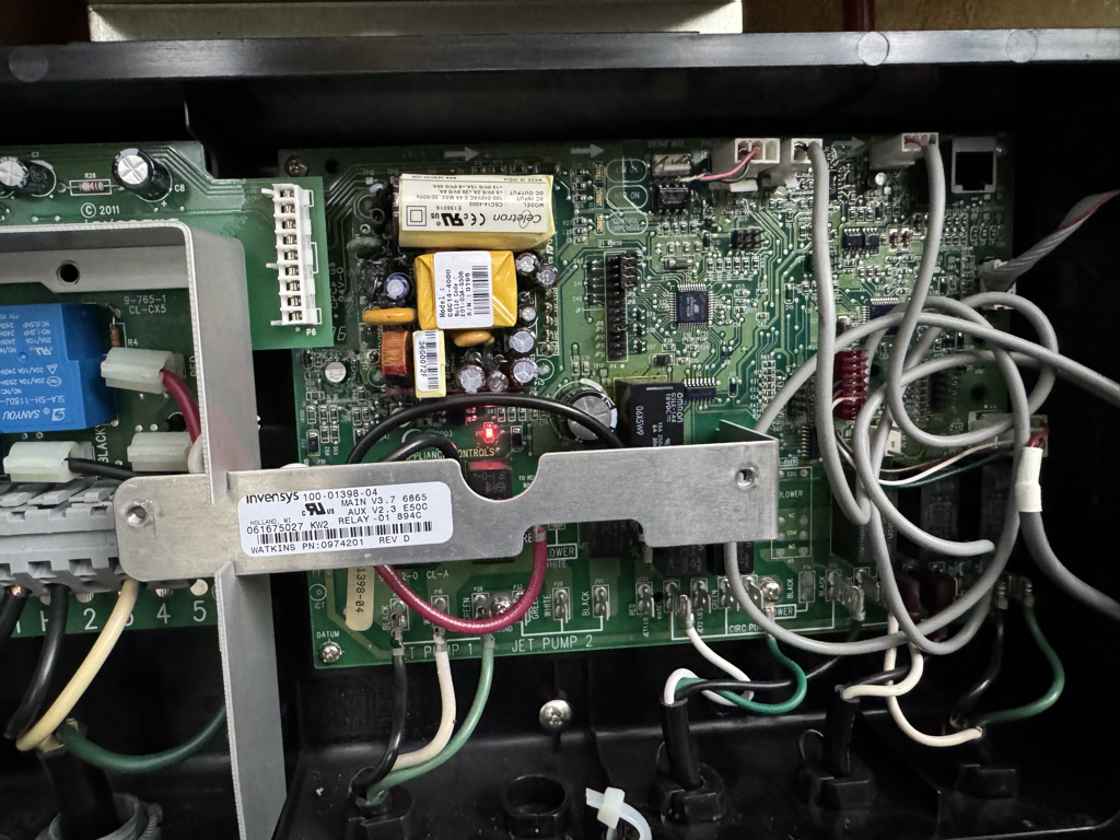

Hello, I have a 2012 Hot Springs Jet Setter Model JJ SN JJ1P2197 that has a safety protection mode on. The water level is okay. The filters are okay. I have removed the stand pipe filter and mineral tablet out of it. It originally had a bad IQ2020 main board. The old part number was a Watkins PN 1315101. I ordered a new control board for it (watkins 76998). The circulation pump kicked on at first flipping the breaker then stopped after a few seconds. The controller panel only works with some functions. No jet pumps or circulation pump. No heater. I took a new plunger to the water return to get any air locks out. There is a red light on the board that has control unplugged beside the light that is red. The lim light is on solid with a green glow. The BUS status light is blinking green about every 5-7 seconds. Any help would be appreciated.

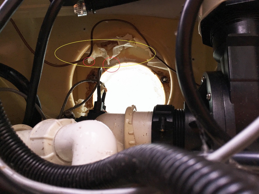

First off, hello everyone. i have a late 90's Jetsetter (J-1511684) with a bad leak. I have checked the seals on the pumps and lines and have a dry equipment compartment. As you can see in the photos, the insulation packing above the lens is soaked and dripping constantly. I know many of these tubs have issues with the lens leaking but the water is much higer, it has swelled all the packing above the lens. Is it possible that the water has leaked out somewhere lower and saturated the packing enough that it has swollen above the leak? If I let it go it will finally stop losing water about 1/4 way down the last jet on the tub. Any ideas would be helpful, Ted
