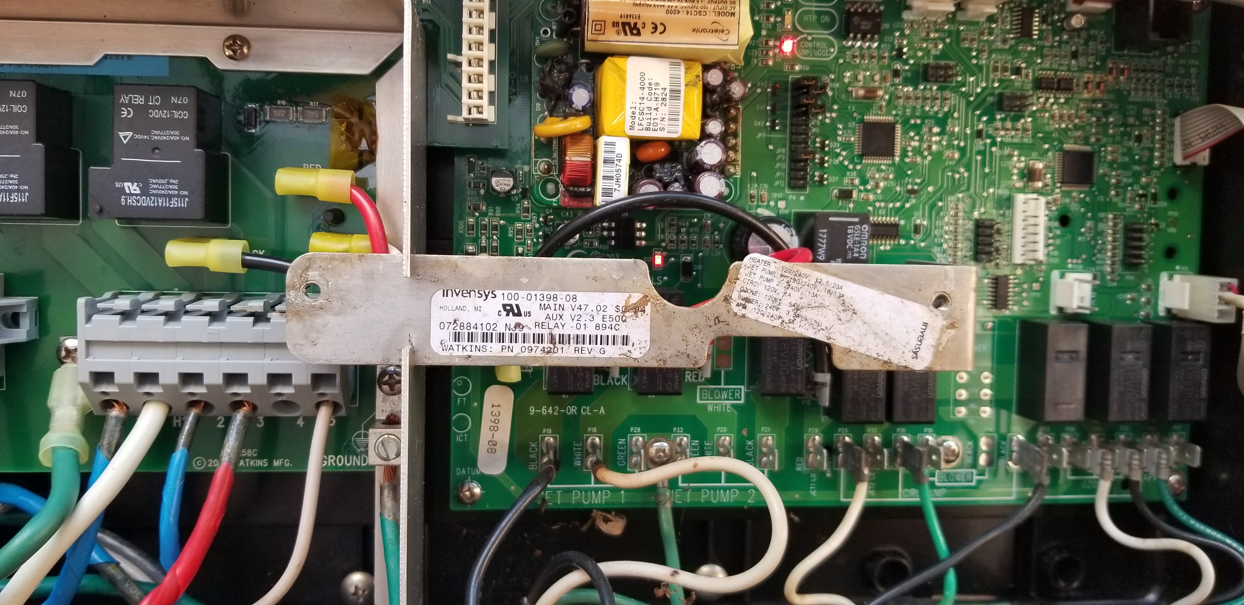

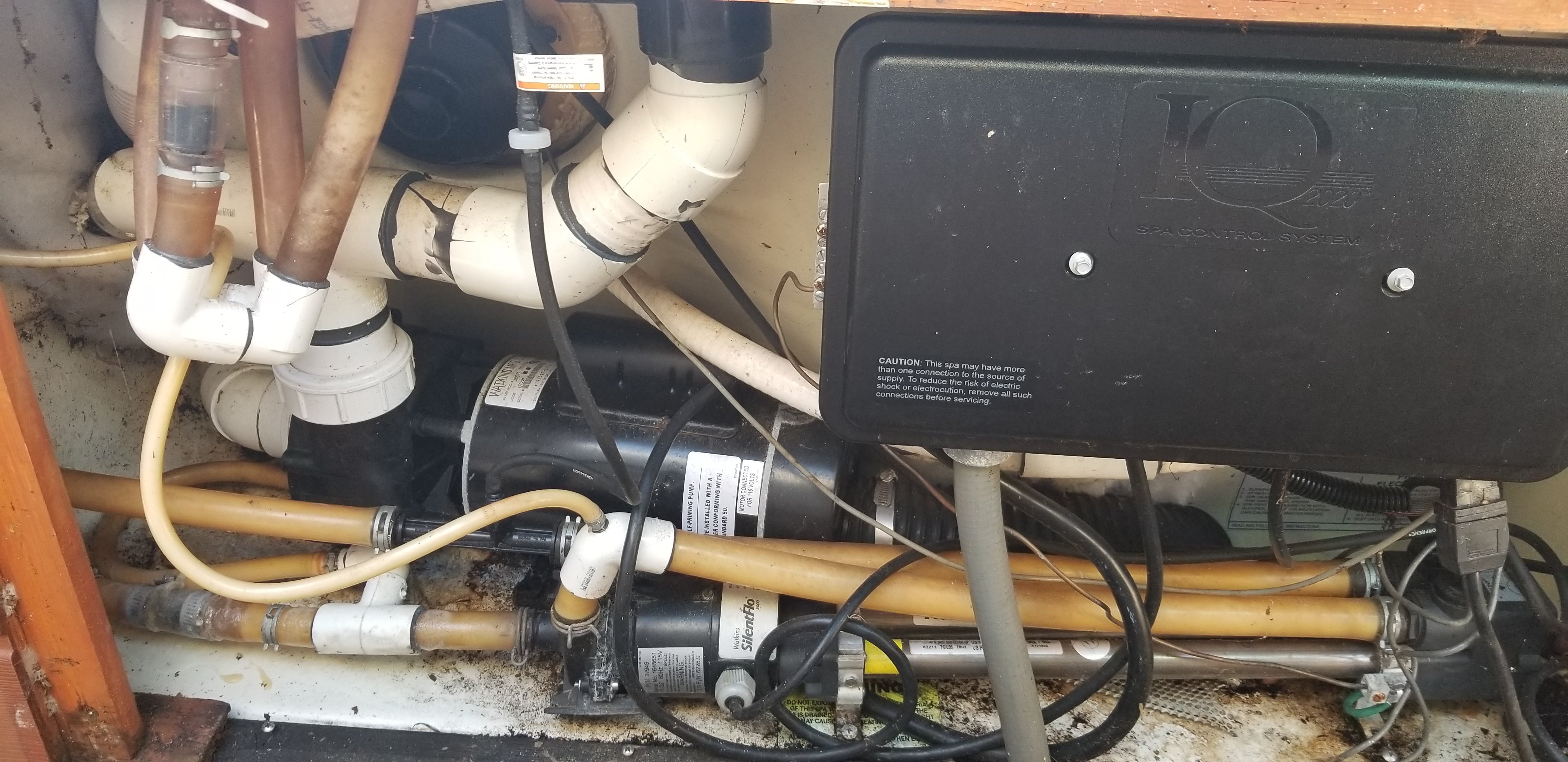

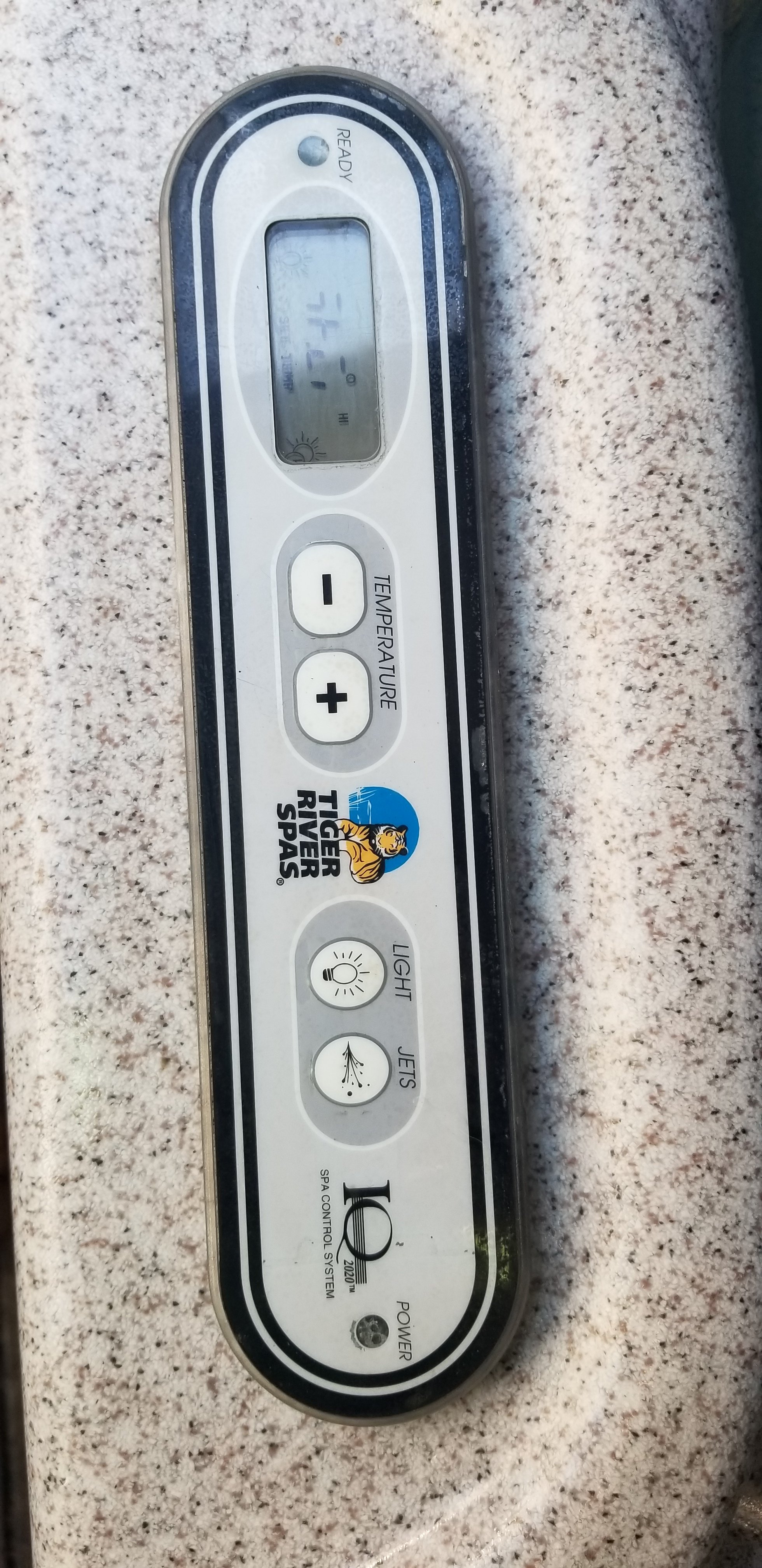

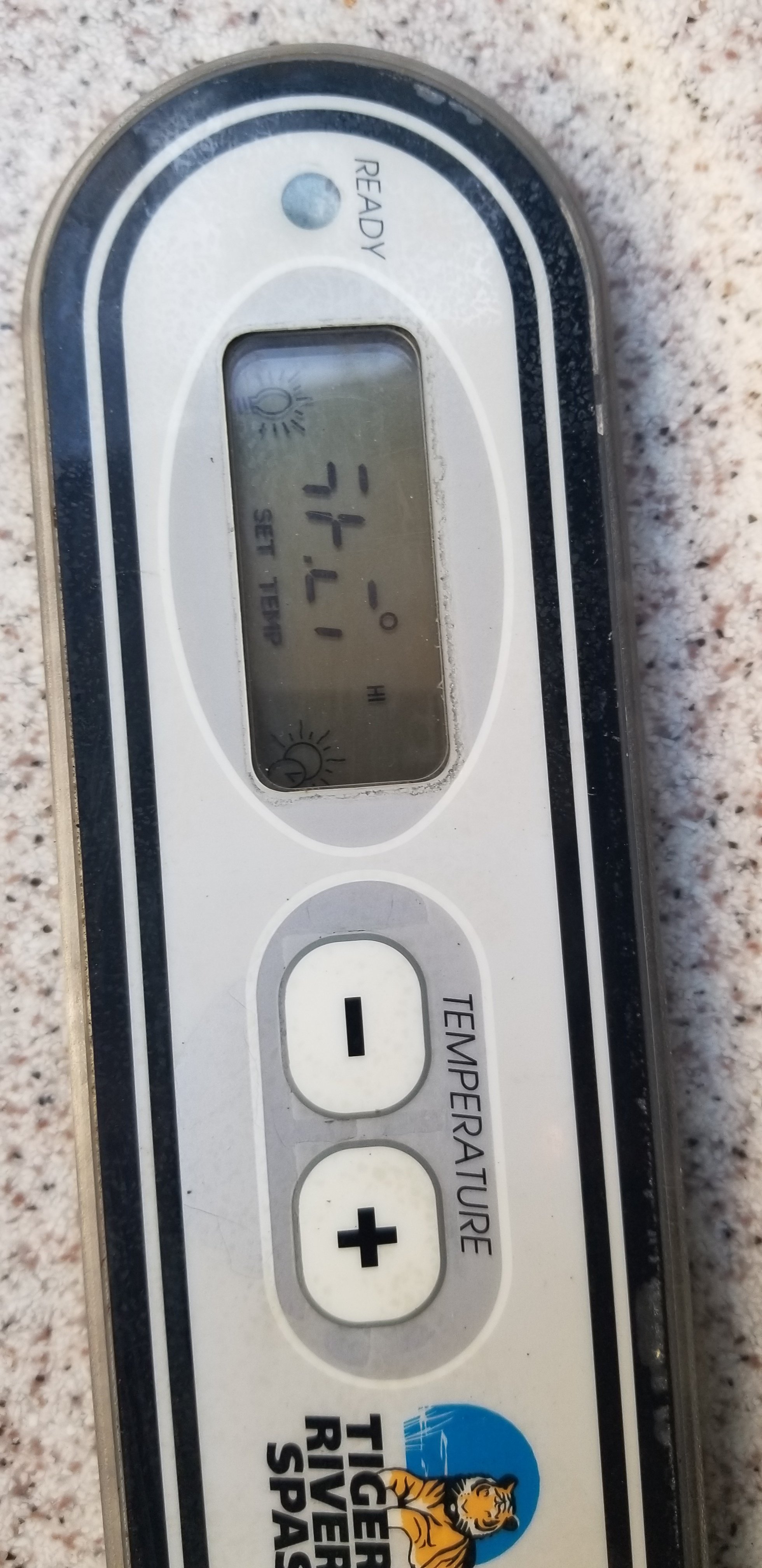

I have an older tiger river bengal model m hot tub, I recently fixed a leak at a flow valve, it worked fine the following day after the repair, but now the green light isn't on and its got some funky code on the readout. I have no idea what the isdue is so I took a few oics to hopefully help. Any input is appreciated. Thank you!
