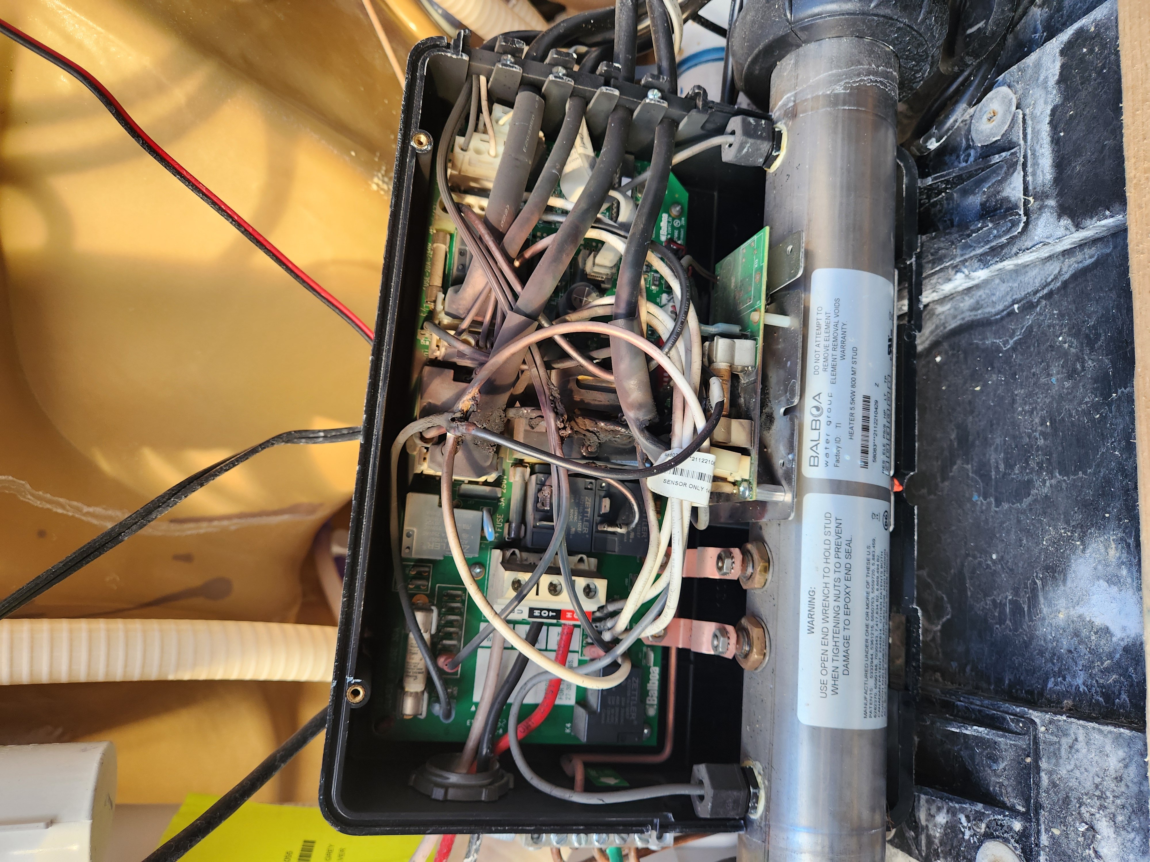

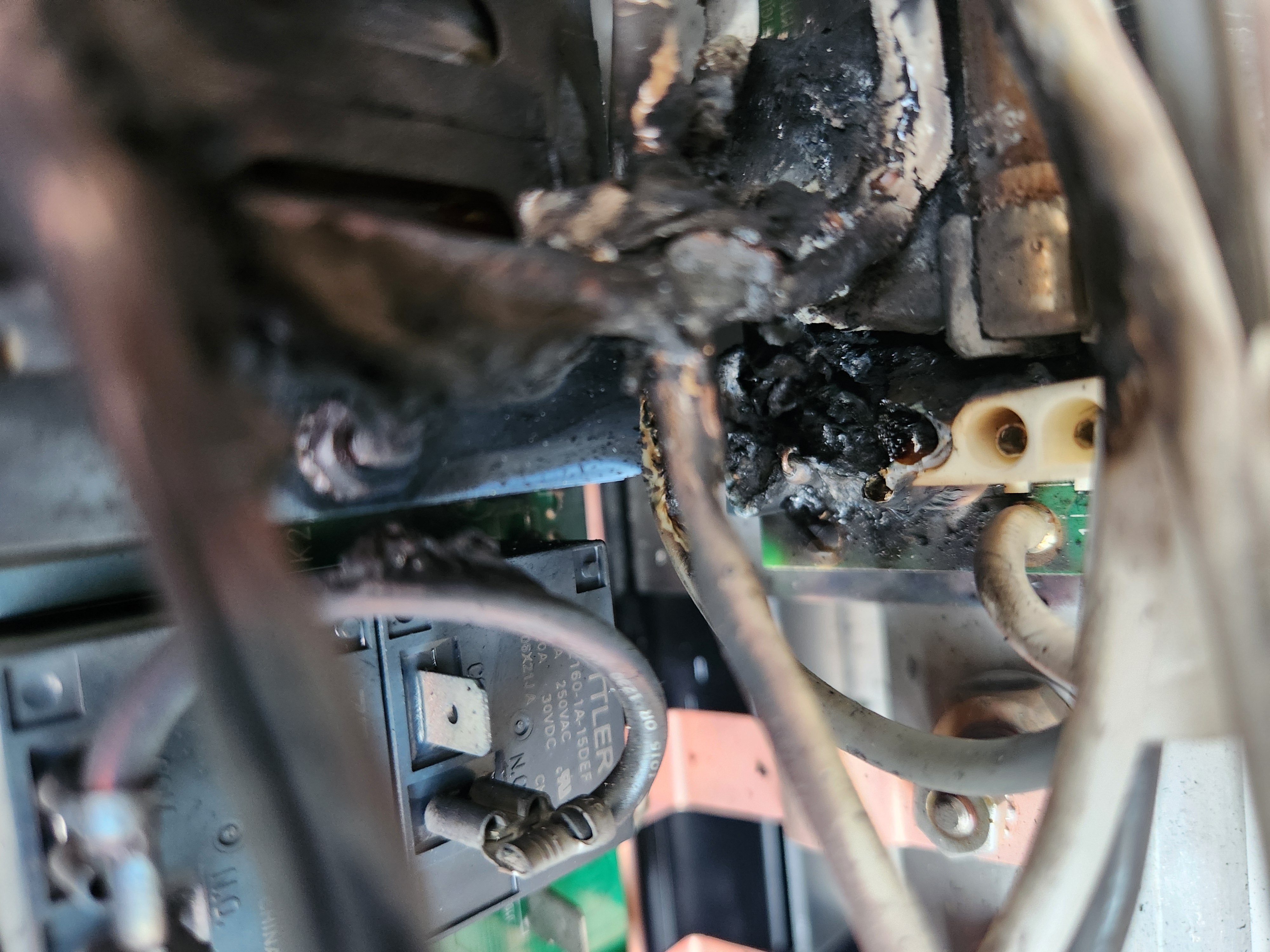

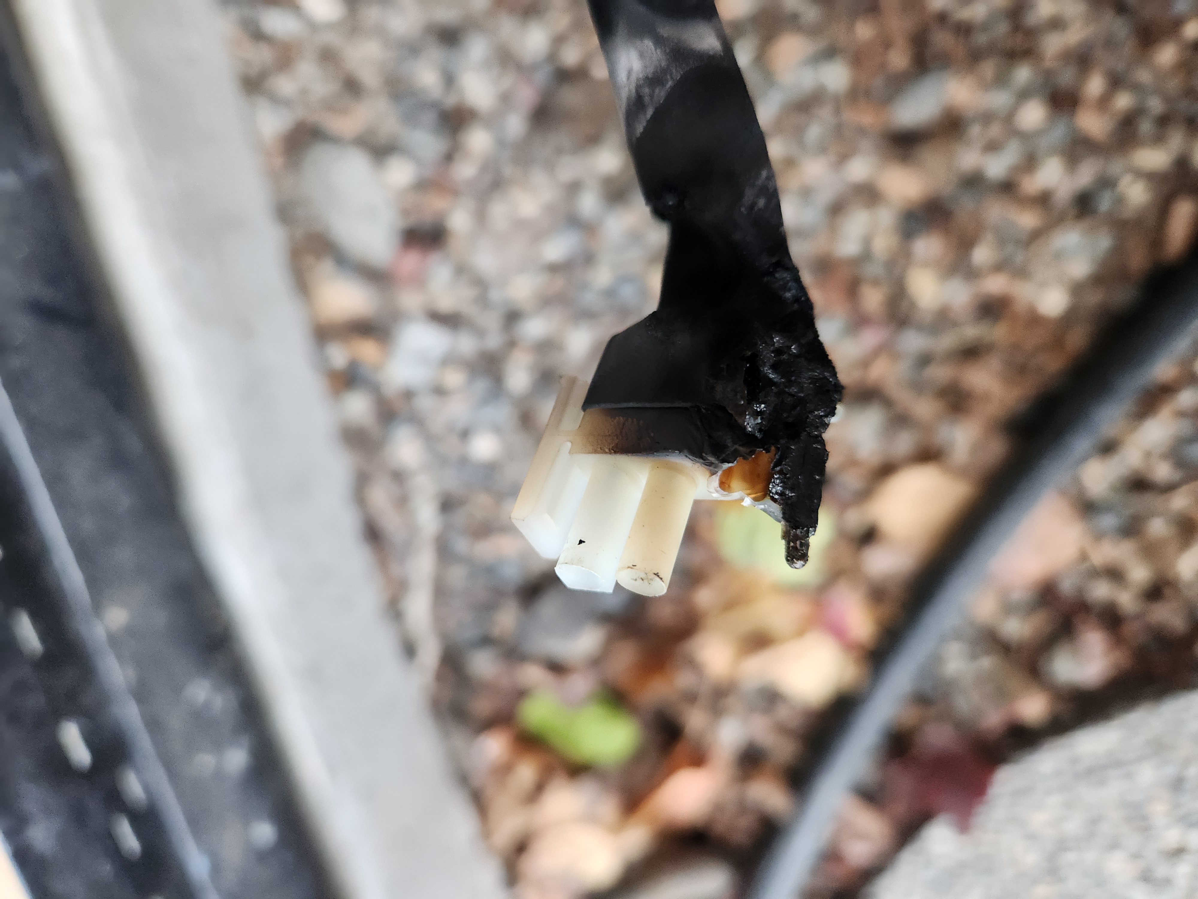

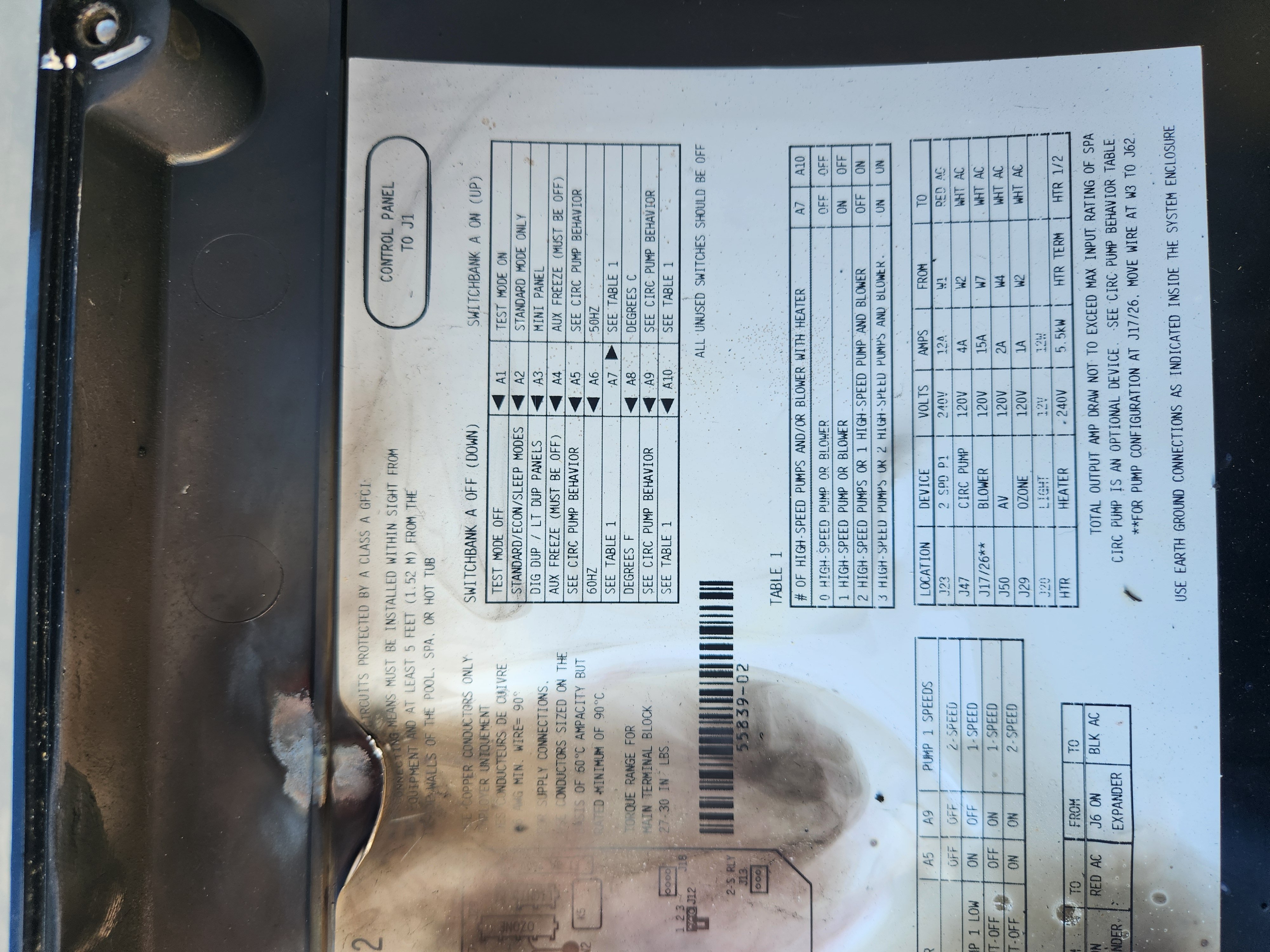

My spa pack burnt up. Balboa 55839-02 (VS513Z). Looks like the source of the problem was a pump 2 connection as seen in the pictures. Was this caused by a loose connection or something else? The pump is 240v but I am seeing hints on the internet this spa pack is for a 120v pump 2. Just want to make sure I understand the issue before replacing the spa pack with the same part number. Thanks for the help I am just past the 2year warranty. Will evolution/strong spas or costco help me out with this or should i just buy the parts and replace them?
