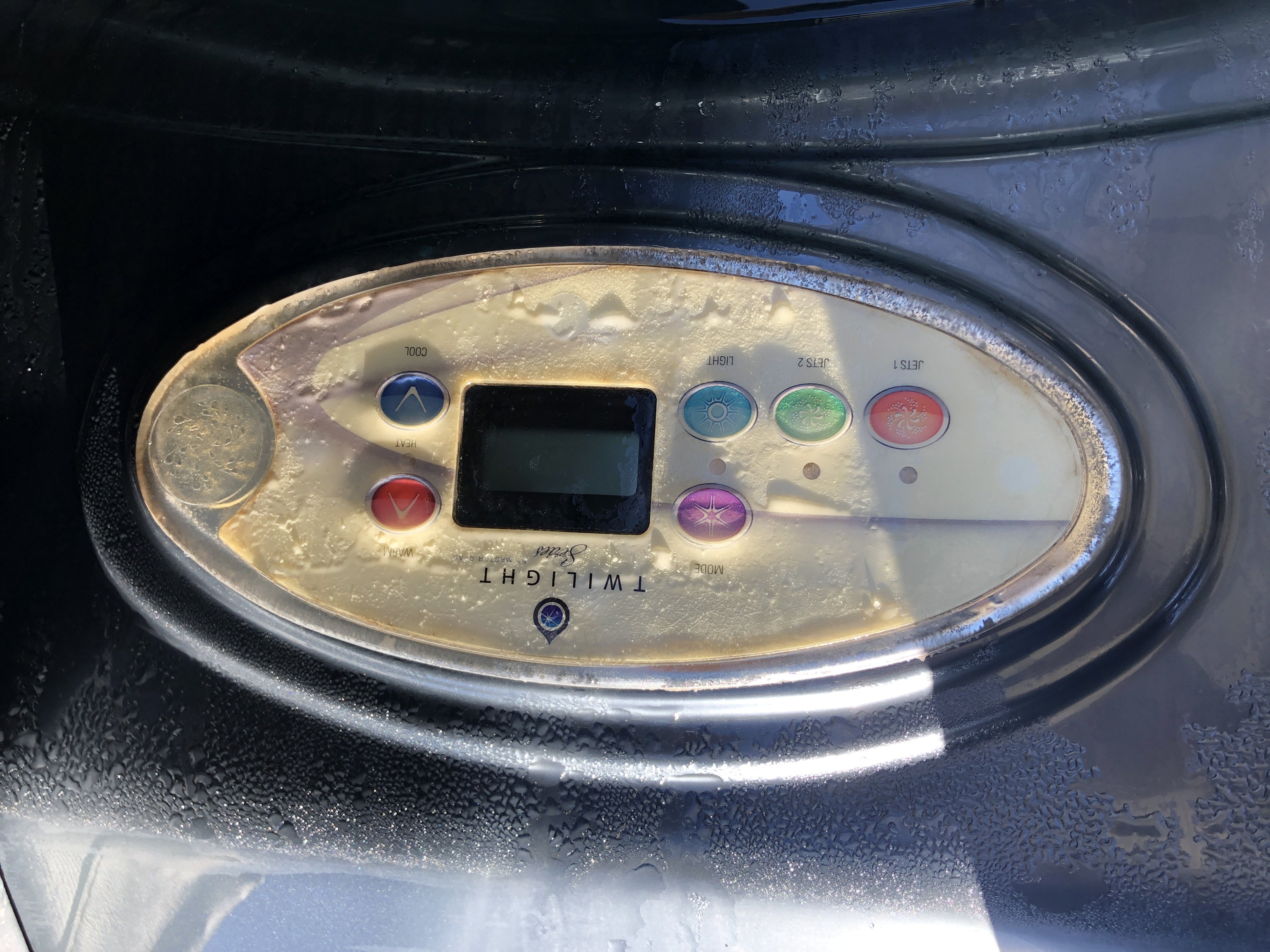

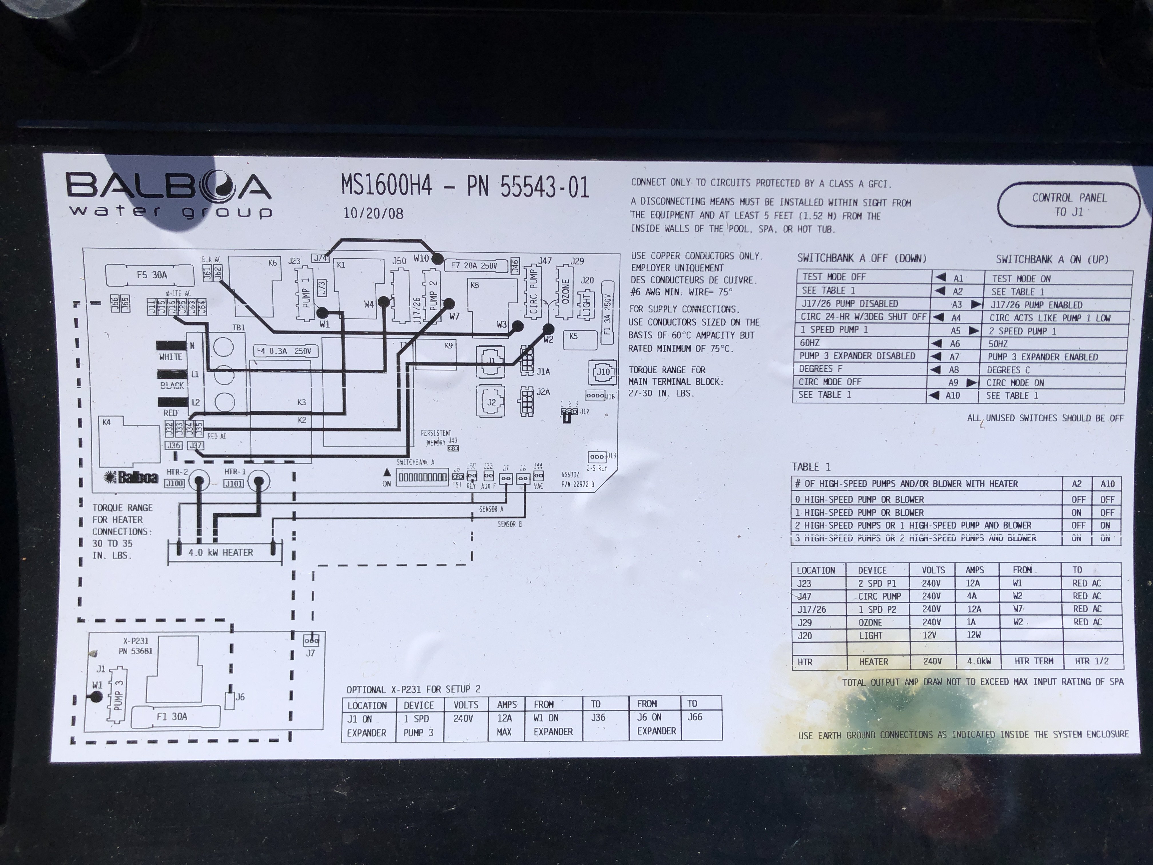

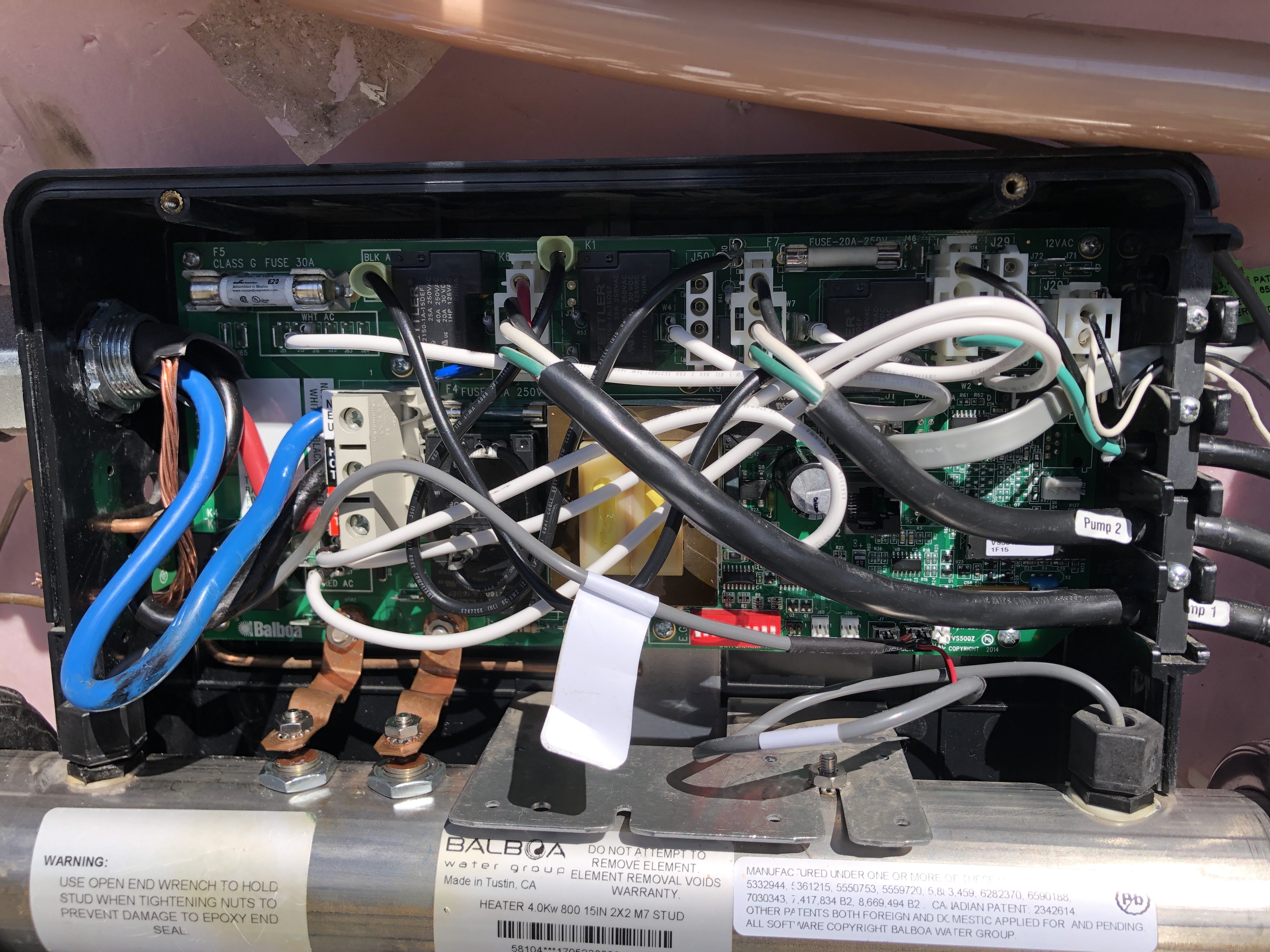

Master Spa replace circuit board, clicks and nothing
Desa posted a topic in Portable Hot Tubs & Spas
Hoping for some insight. Heater blew, so had to replace board and heater element. The old master spa board was a VS501SZ serial no55241. Balboa rep replaced with VS501Z serial no54357. After install, power up, two quick clicks then nothing. Power into board good, fuses test good. No power at topside control. Any ideas? Old Master Spa Twilight series that came with my house, replaced both manifolds, and two pumps. I’ve gotten emotionally attached lol Circuit board was 600cnd so I hope I didn’t just throw that away. -
