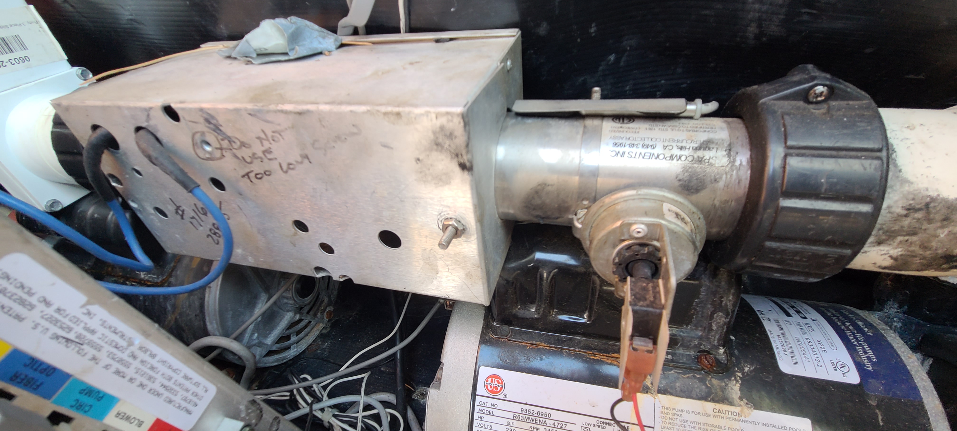

So this winter I came home to a blown out fitting on the pipe to/thru the heater (left side coming into heater box). I believe it was due to an "OH" error (which I've seen before & shuts the jacuzzi down) which shut the heater down, water froze, black clamp fitting busted, water drained out. So yesterday I replaced the fitting, filled it & it fired up as normal, circulated & all seemed fine. BUT, the water never heated up. I checked all wires & fittings. So does this seems like a heater issue? I can easily find the heater & replace myself, but I'm not 100% sure that's the most likely issue. Thoughts? Thanks!

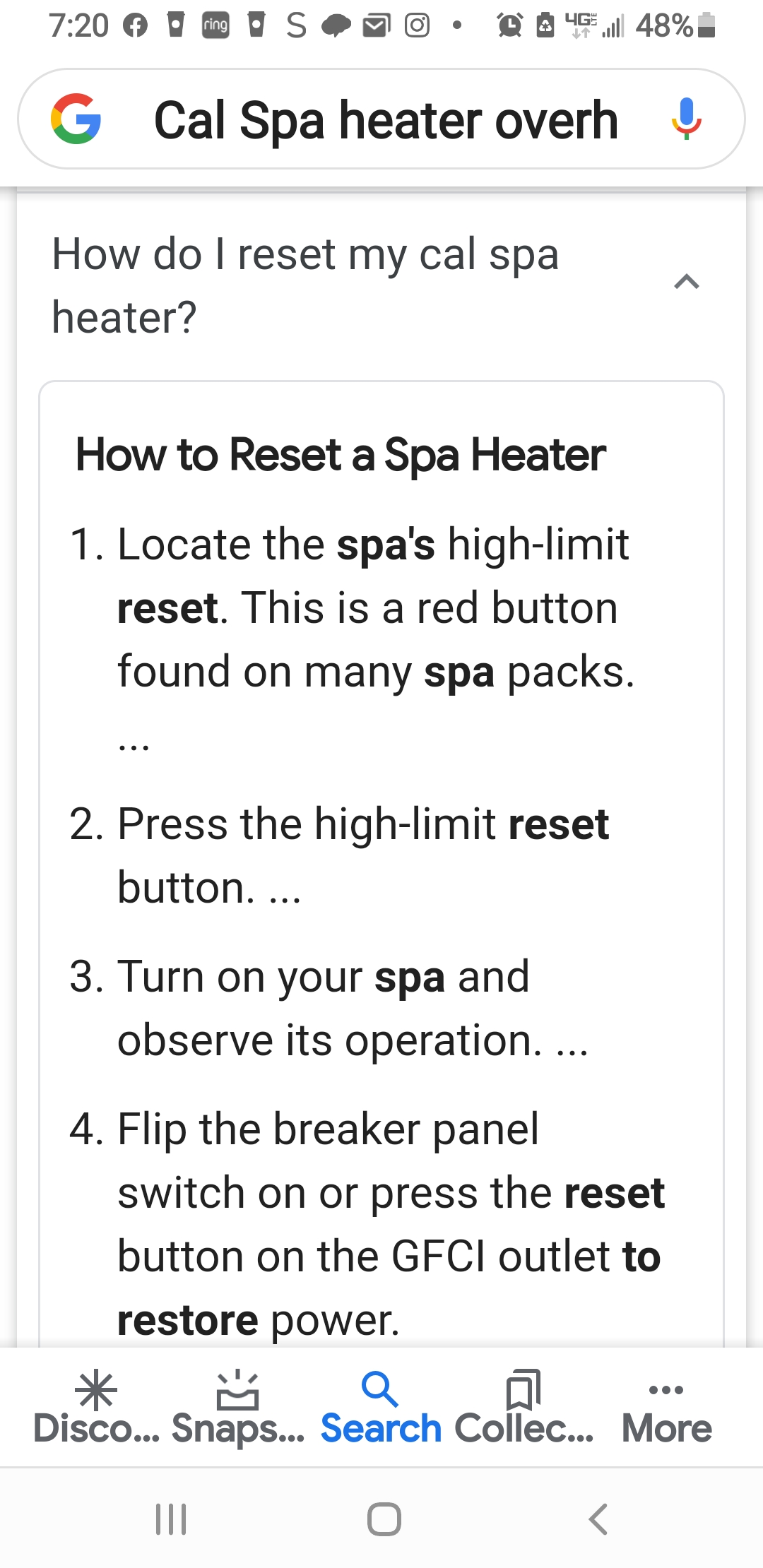

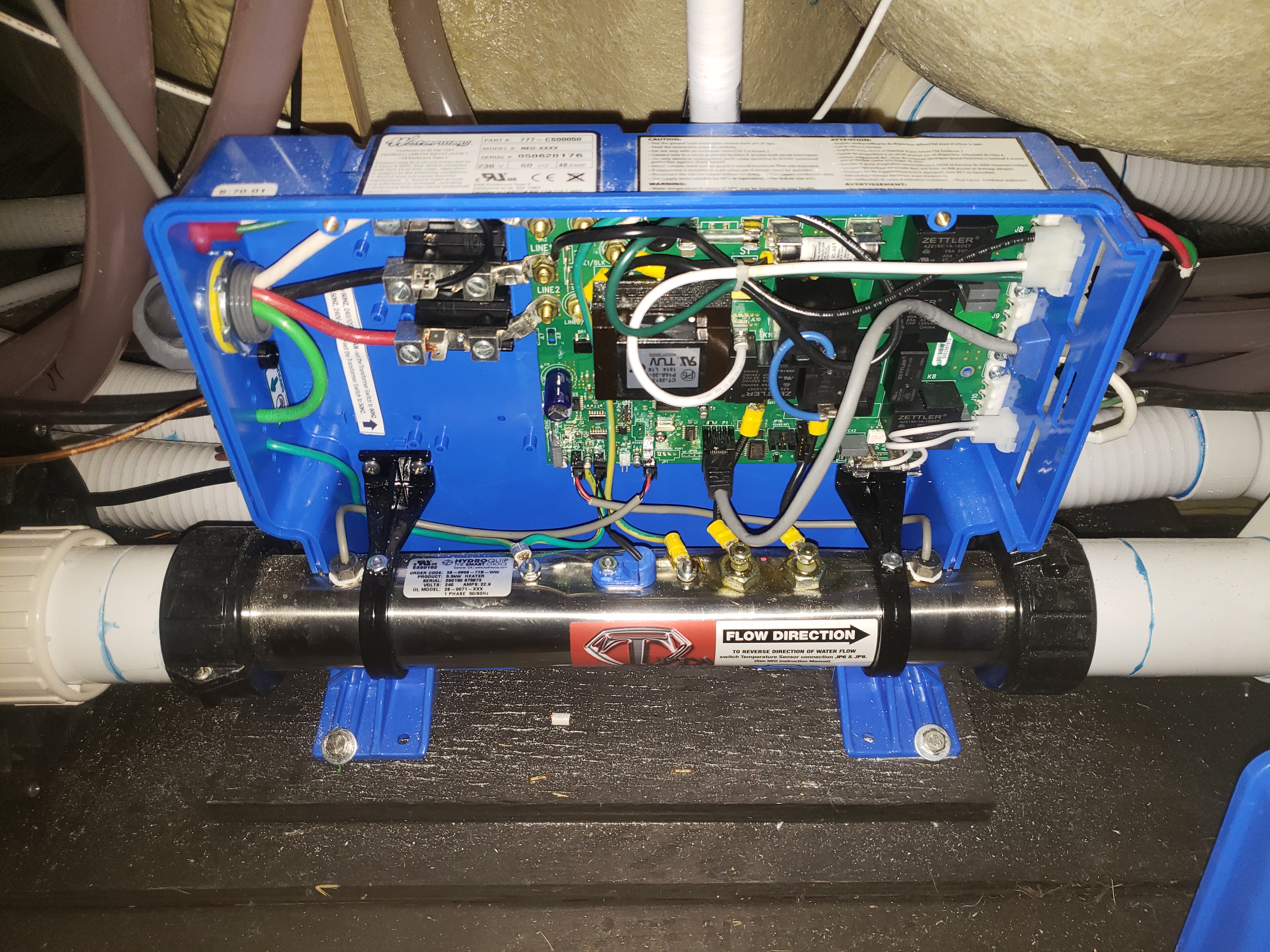

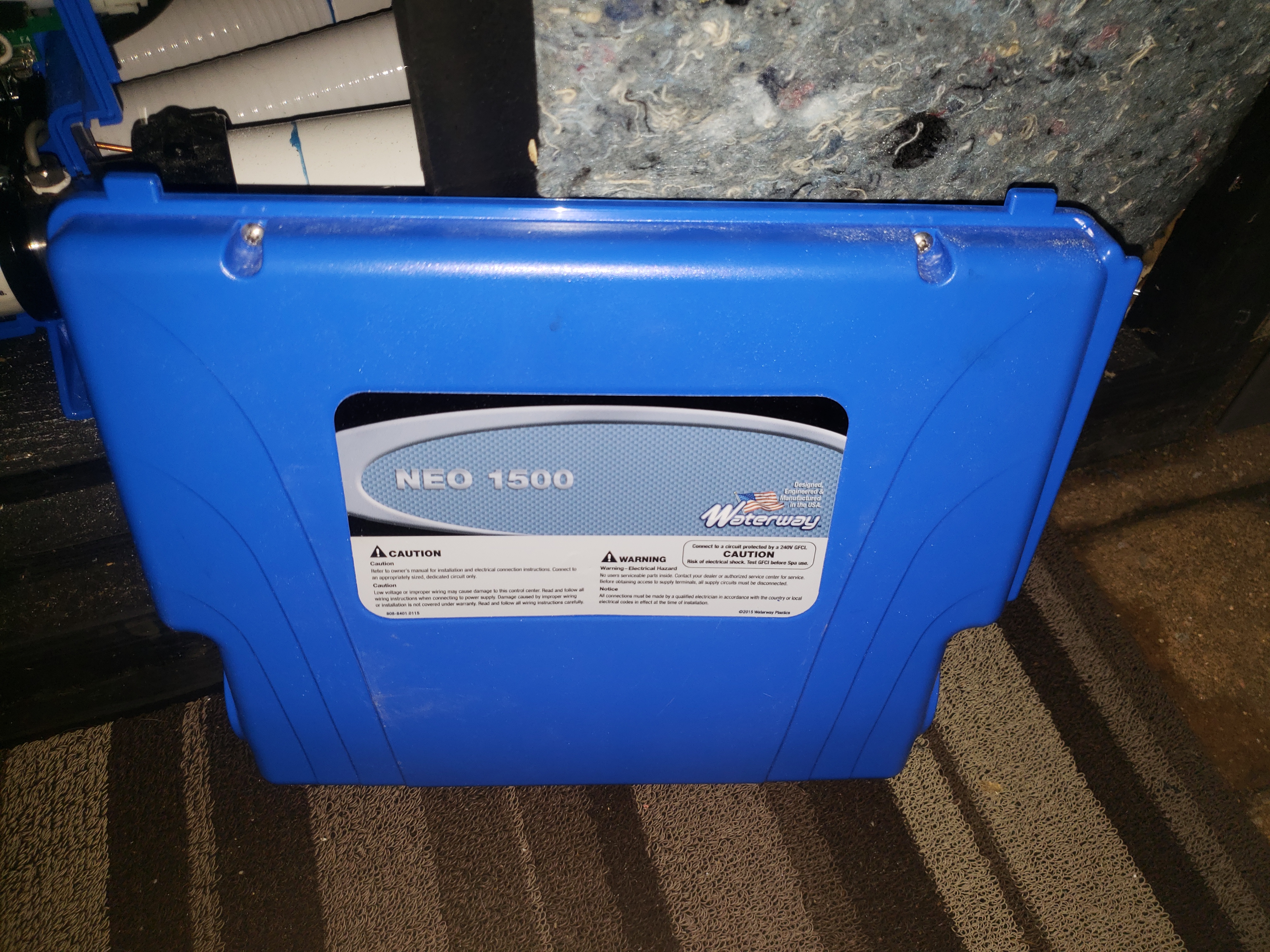

I'm getting an error message on my only 6 month old Cal Spa it says heater overheated. Everywhere I look says this is a common problem when draining and filling the hot tub. It says the way to fix it is to open the spa box and push the red reset button. I cannot locate this button anywhere can somebody please help and let me know where it is. The spa box is a waterway Neo 1500. Please help find the reset button... Thank you
