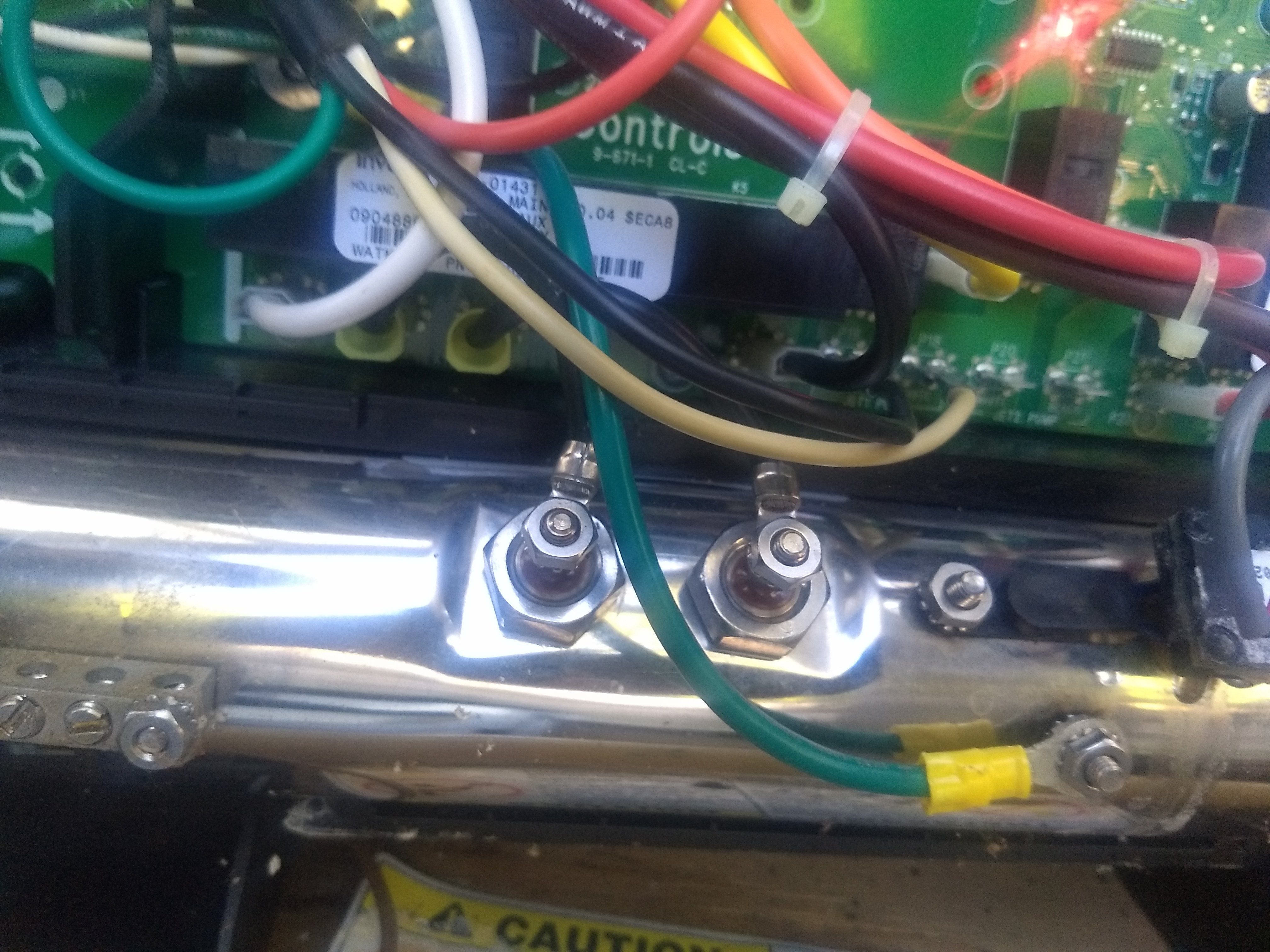

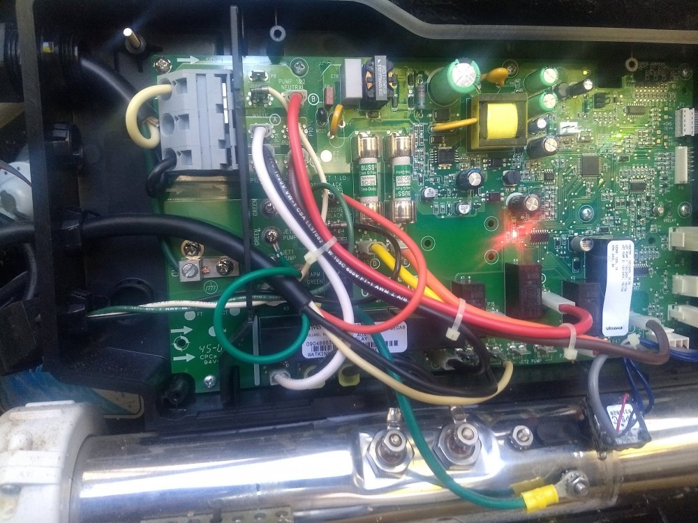

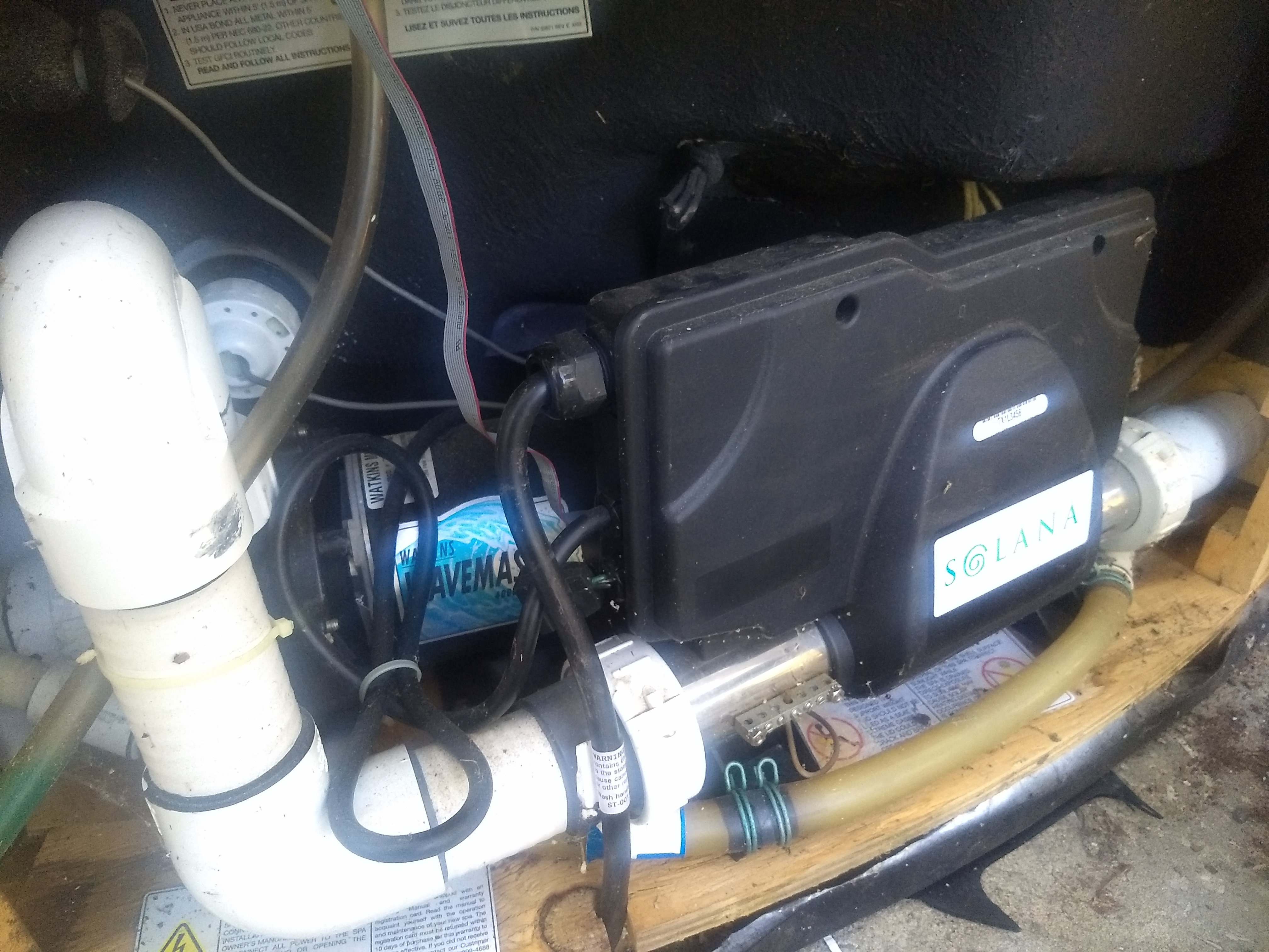

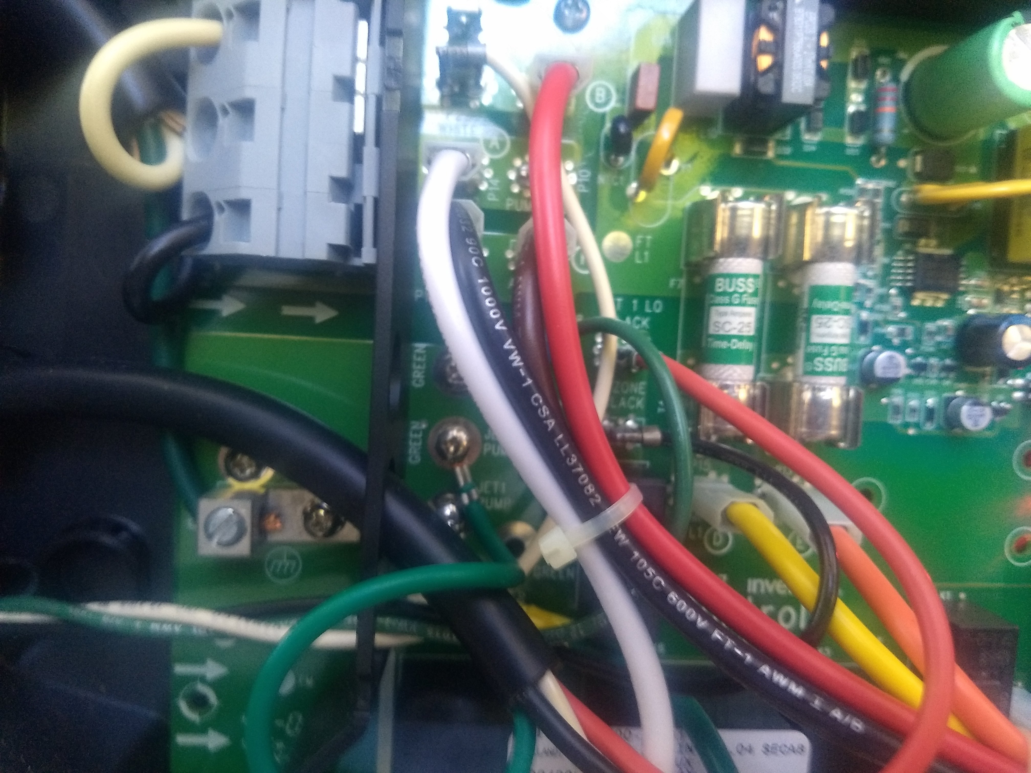

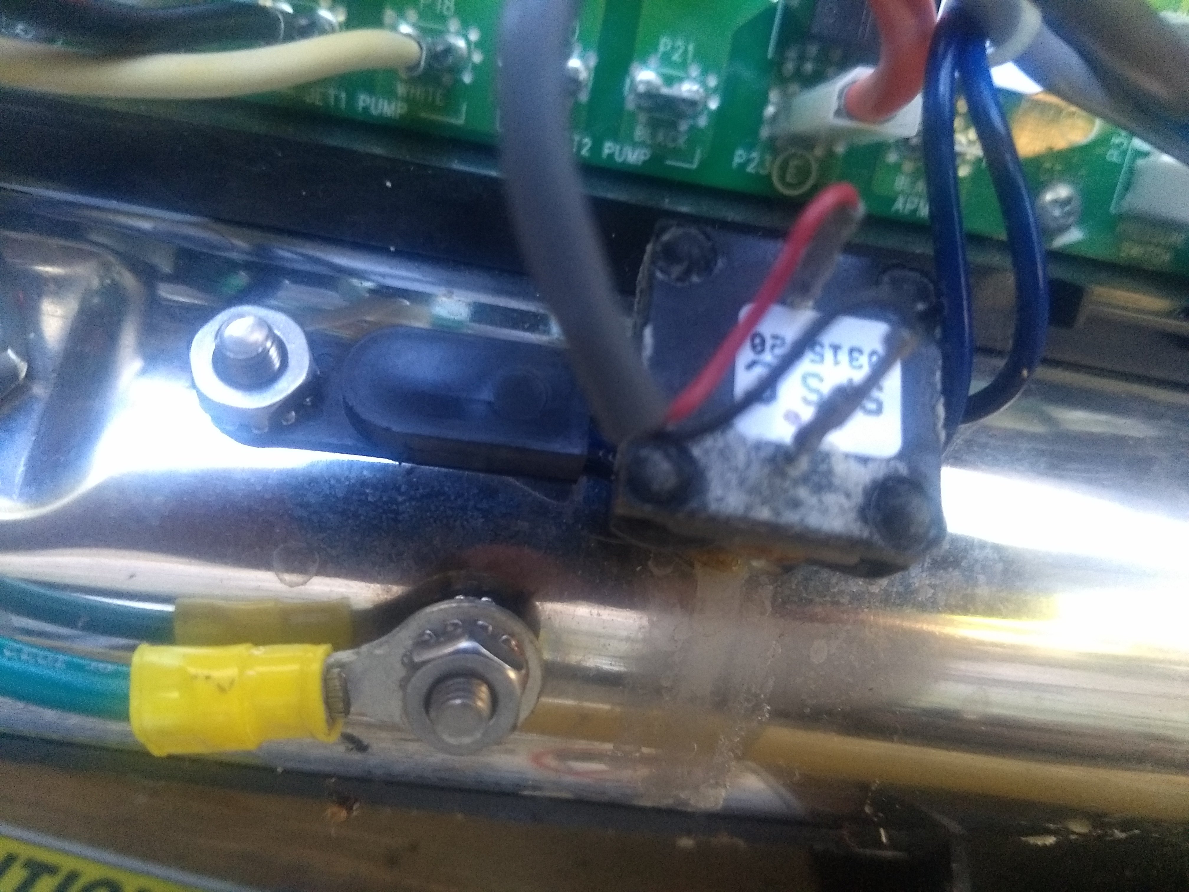

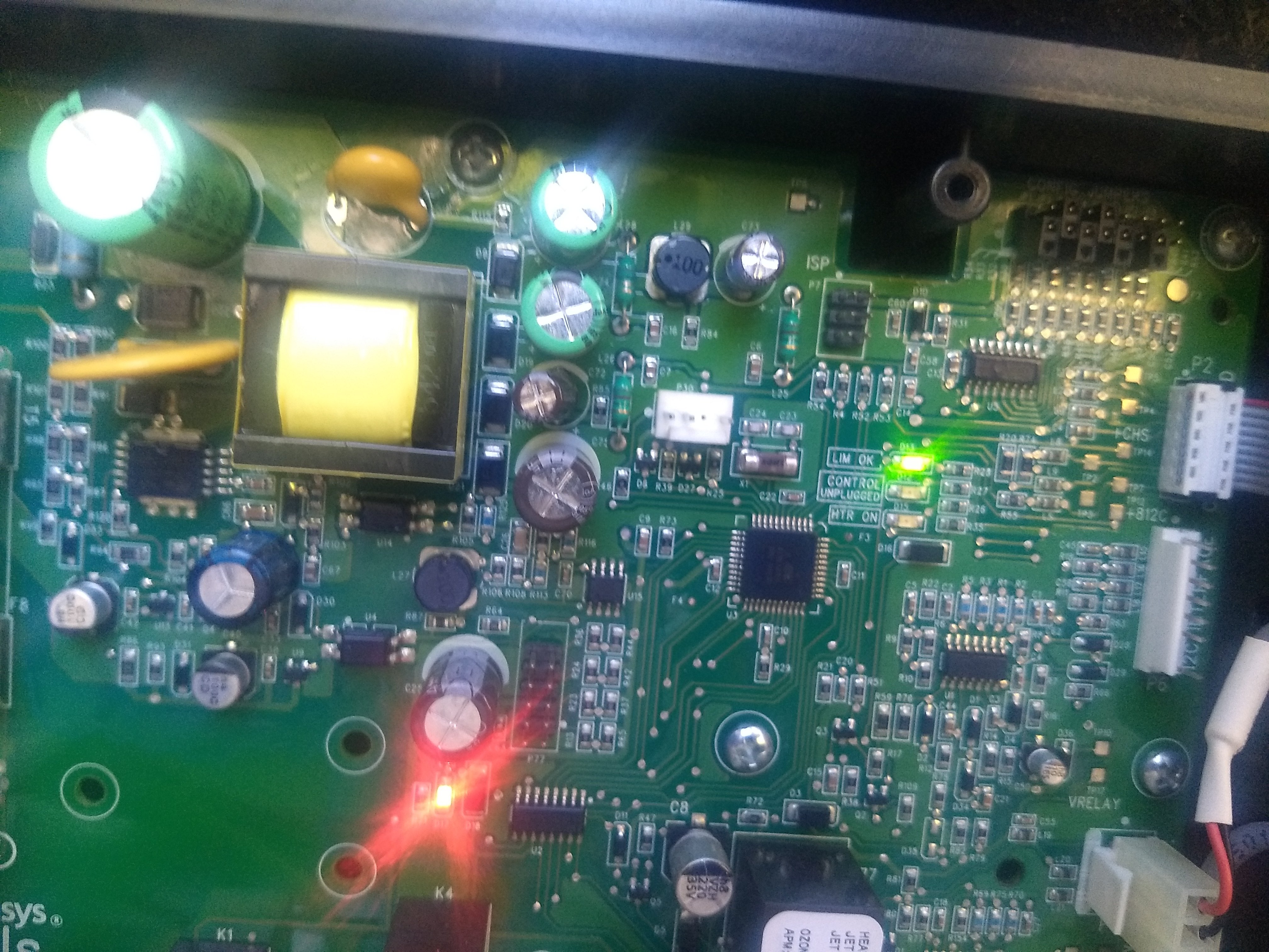

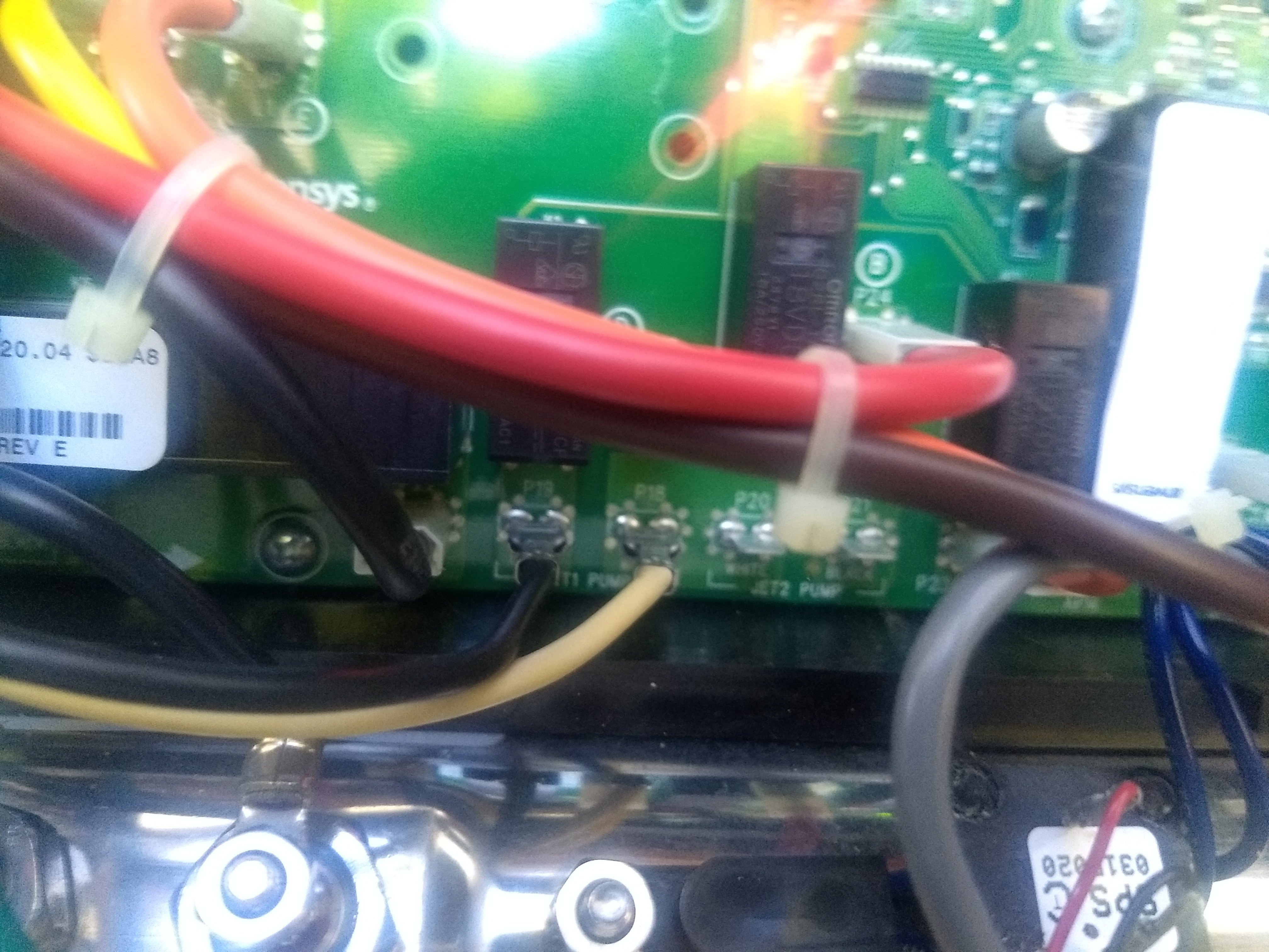

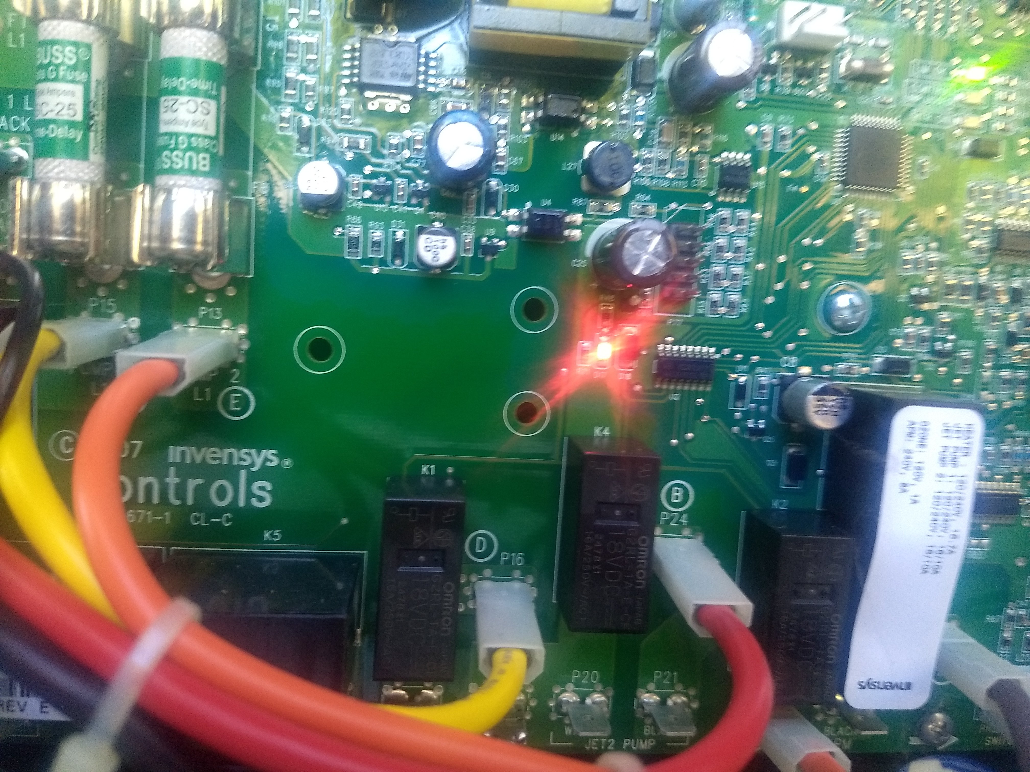

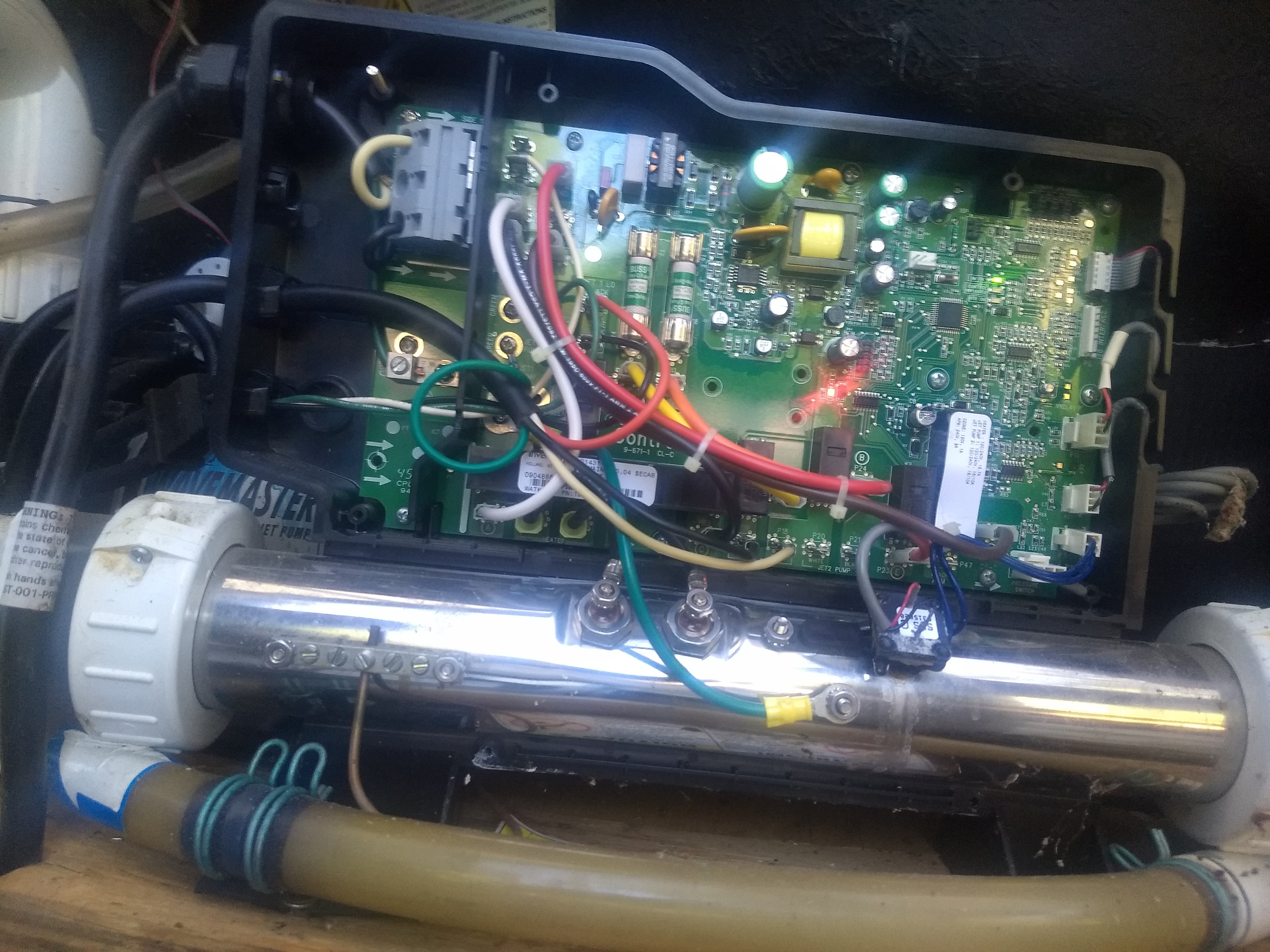

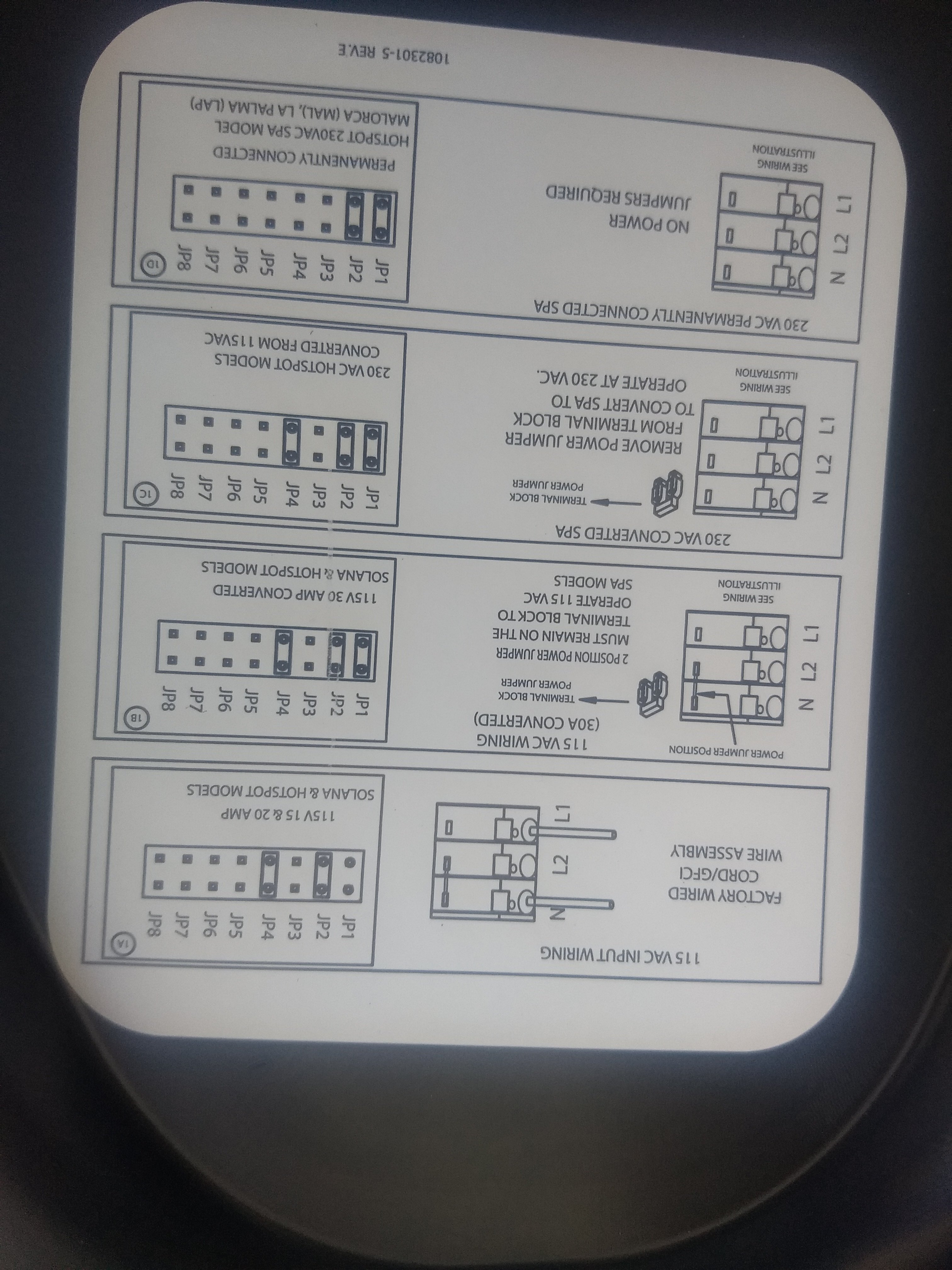

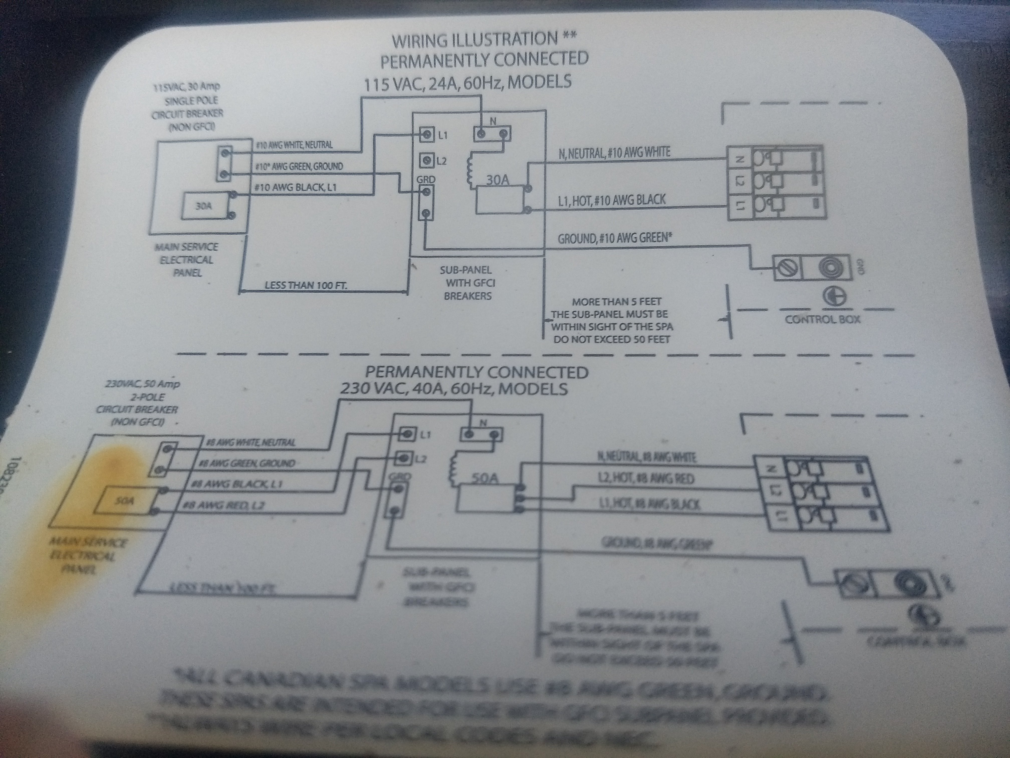

  3. Here are a bunch of pics. All taken while the tub was running. I didn't turn it on. It was just running cause it seems like it always is.lol. when I turned the Jets off, the green light stayed lit and the red light went out. Also the small black sensor in the heater tube had a drip of cold water coming off it and some staining on the heater tube below it so I assume small leak there. As the weather has gotten cooler, it has been running non stop.

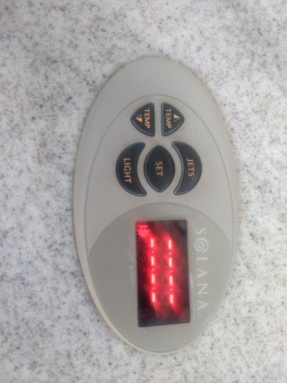

  4. Hi. I am new to spas and to this site. I have a Solana TX and it seems to function fine anytime we use it. Jets work. Temp stays within a degree or two of what the display says. It seems like it is running almost all the time. The display shows two rows of dots and dashes. _._._._._. _._._._._. Something like that. It goes away if you touch the controls and seems to function correctly, but within 10 seconds or so it returns to the dots and dashes screen. Any ideas? Thanks in advance for any help.
