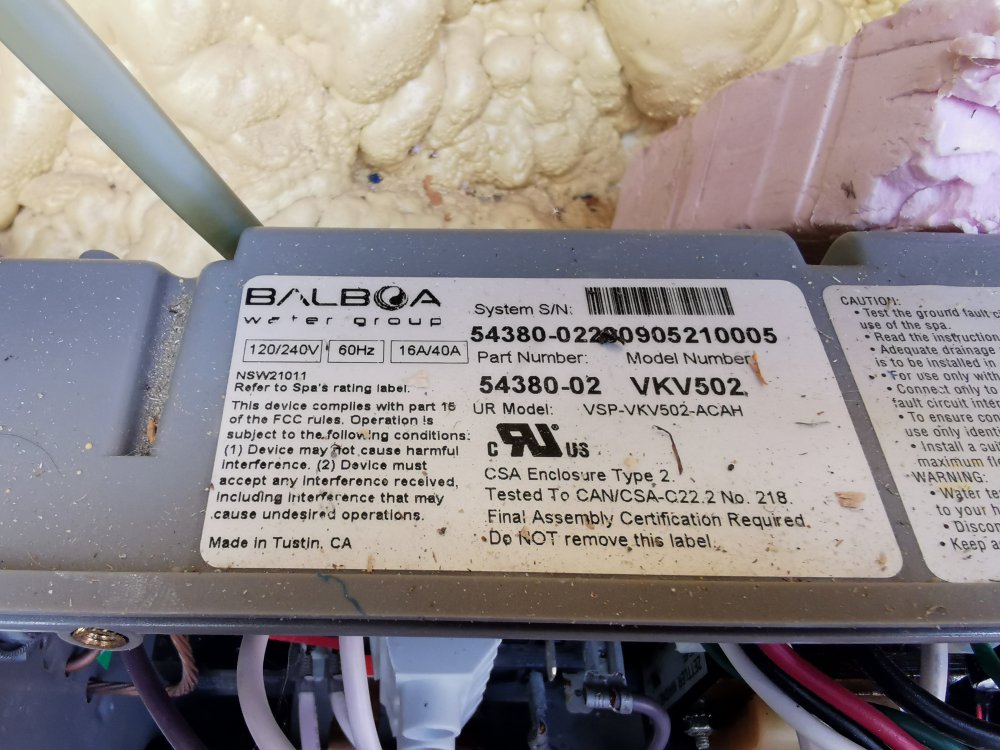

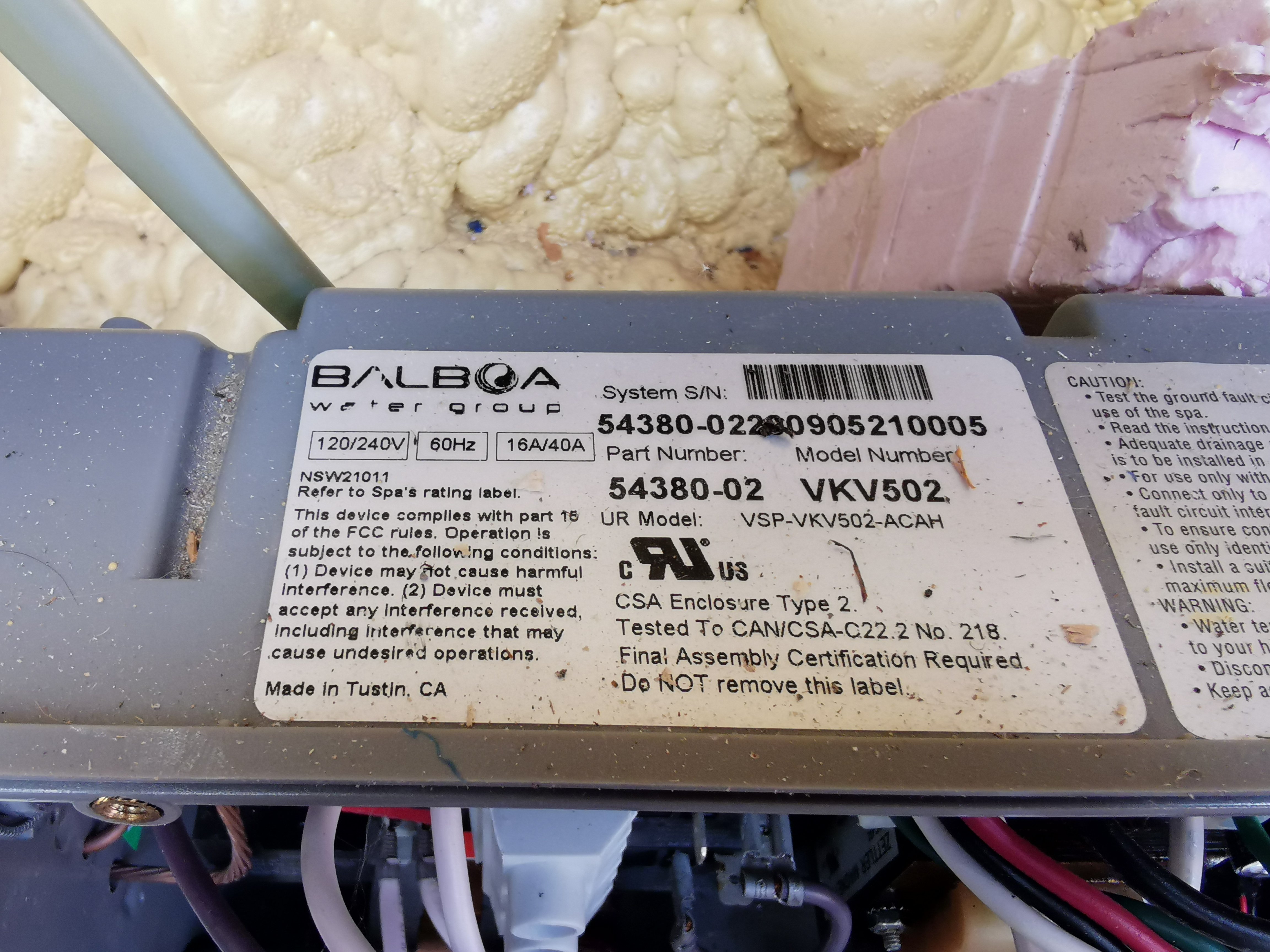

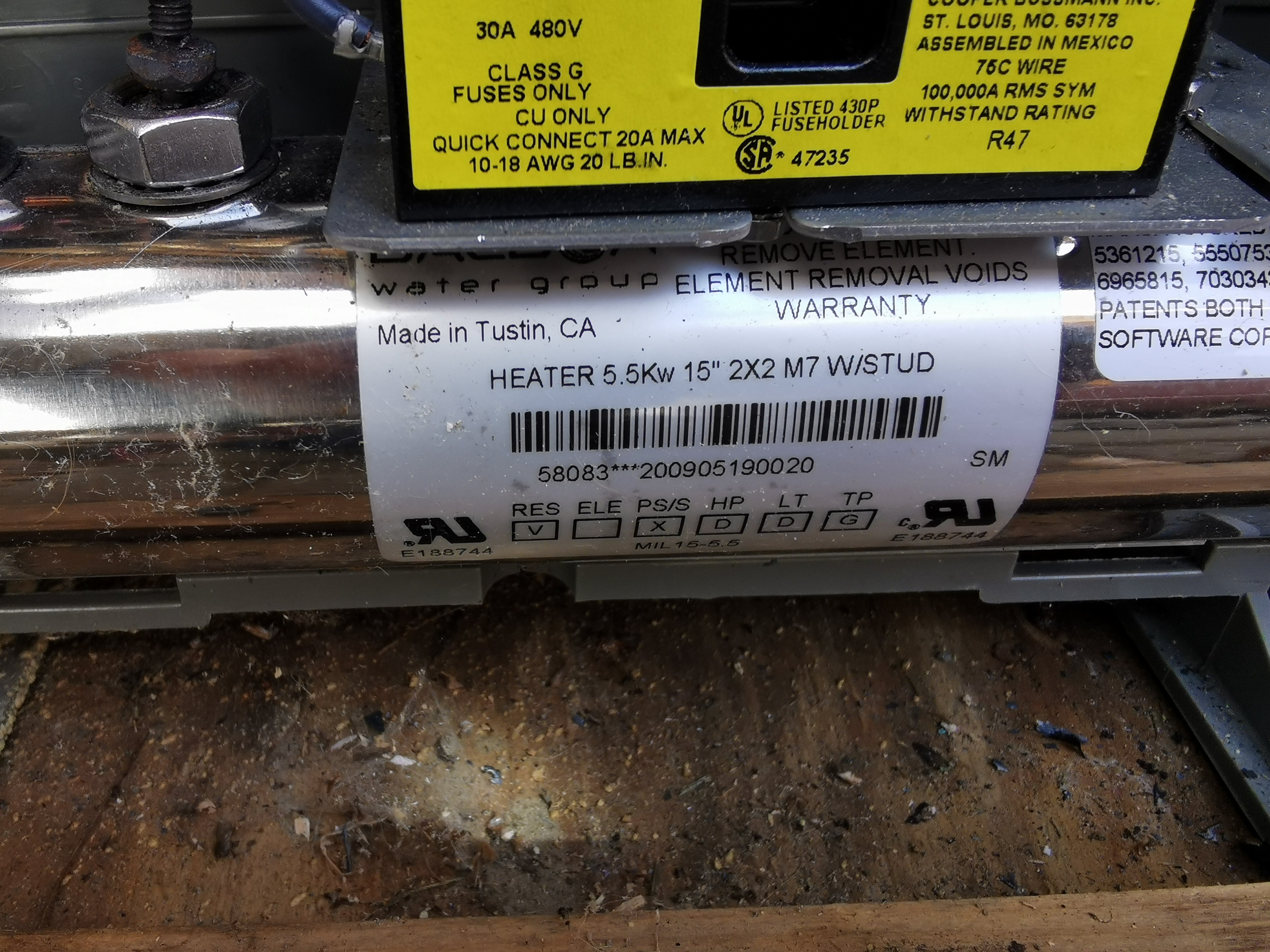

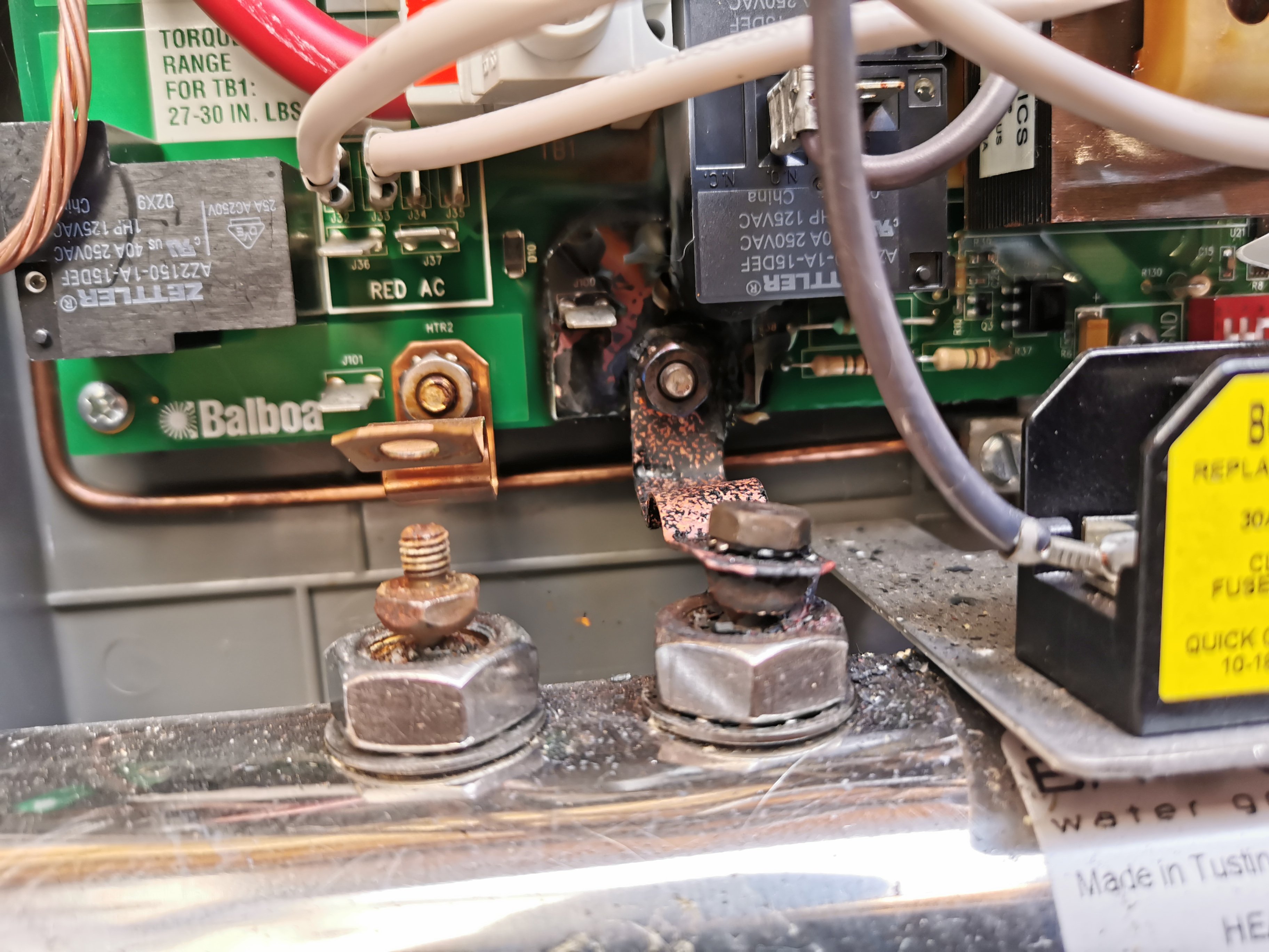

  1. Do you think I could replace only heating element or should change the whole heating kit which is on one of my pictures?
  2. Hi. My hot tube was working perfect and out of nowhere I heard bzzz smell burn and all stopped working. I checked main fuse on power to board and to heater and both are fine but spotted burn on my balboa board where is connection between heating element and board. The connection was tight before fact. When tested heating element showing 11-13 ohm but few times jumped to 30?! Any idea what was the cause of that and if my mother board need to be replaced as well as heating element? Images attached.thanks for any help.
