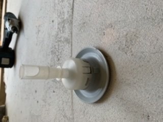

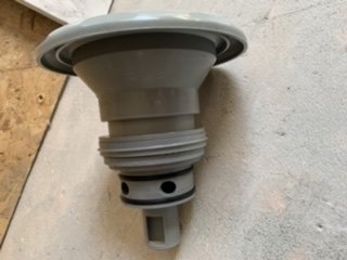

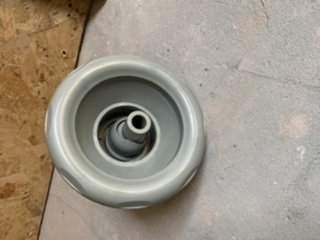

It does appear I have no chance of getting this Jet over here In the U.K. Could you recommend a good trusted company over in the U.S for me try and source? many thanks
That’s brilliant thank you very much RDspaguy 👍. That looks like it could well be the one I’m after. Now to see if I can manage to source one here in the U.K. Is it quite normal to find different brand jets in one tub? I think the rest are Pentair type.
Hey guys wondered if any one can help identifying this jet. It’s roughly 7.5inch on the face. Its removed by turning and screwing out. I’ve looked all over on line and just can’t find it. The waterway jumbo jet is almost the same. It’s an old tub, 13 years old or so and not sure of brand. The rest of cyclone jets in the tub are Pentair Brand.
