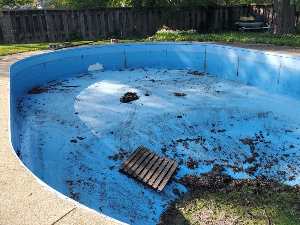

The pool, is a 50-year-old, steel sided pool, with some leaking pipes, no main drain, and partially working skimmers Most likely it needs to be totally dismantled and rebuilt here's some specifics on the pool: 25' x 40' Inground pool, 35000 gallons, Hayward DE filter and decent pump what are the best construction techniques and approaches to building a pool - in 2023 ? what material would be used for the deck, for the bottom, and for the walls ? what contractor or company would offer that ? What should I expect to pay ? Please help; I don't want to live until continual maintenance, the rest of my life. Thank You Here's a few links of the Pool -- construction zone -- haha, in years past http://mysrv.info/Pool_2018/Pool_1805.html http://mysrv.info/Pics_2018/Pool_2018/Pool_1807.html I am going to leave my email if it's easier to get in touch that way doingitrite AT yahoo
I'm about to paint my older pool, now that I've done a complete resurfacing on it, due to some rust spots. I was in this big maintenance cycle in 2010 - and now again in 2013 It really turned out good previously, but I'm trying to do everything I can to minimize the maintenance, and put the best fixes in for Long-Term. I even have pictures of the Before and After, in 2010 - and let me tell you, it started pretty Ugly. Here's my recent pictures/post, from just this year: Pool, bad - Start of 2013 http://imgur.com/dD1tXw8,ZxTWQnA,5VUkyvm,VIRKdtg#2 After grinding any rust out, down to the bare steel, and cleaning, I've used a thick layer of AboWeld to patch the seams and repair any rust spots. ( It's the first time, I've used such a product - allthough I hear WallNew was quite popular too ) **** Now I'm looking for painting tips or techniques, and How to Do It Right. **** I've already gotten the paint, and it's from Kelly Technical Coatings: Olympic Zeron epoxy paint. I might go about it this way: Rough up any AboWeld spots with course sandpaper, to allow the paint to grip better. Clean and brush down, with TSP solution ( 1/2 cup, to 2 gallons ) Clean and brush down, with Muriatic acid solution ( 50/50 muriatic acid/water ) Clean and brush down, with TSP solution Make sure it's dry and I have 5 relatively Dry days ahead. Mix the epoxy paint, and apply. Tips welcome from anyone experienced. This is a Big Big job, especially since it's an IG pool, 35,000 gallons, and it's 17' by 42' I don't want to make a mistake and it's got to be quality work, throughout. ps: It's steel-sided, with a concrete bottom. I'm going to be painting over the last coat of paint - there's only 5% of it (seams & edge) that needed patching. On the bottom, just dirty in spots, stained with dirt, and a few rust spots too, I think from metal shards that got loose and landed on the bottom ( during the grinding/resurfacing process ). Eventually, this whole thing will need a rebuild, and I'm looking forward to Low-Maintenance, compared to all this; I'd be glad to hear suggestions on modern builds, materials and what is used to build new pools too.

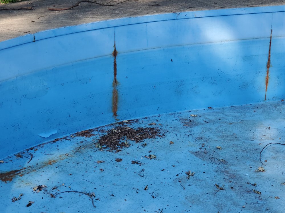

25' x 40' IG pool, 35000 gallons, DE filter (Hayward EC65), and 1.5 HP Pump The main drain was cemented over, years ago - Just have the skimmers for outflow I've had this rust problem before (actually, since I've owned the house) and re-painted 2-3 years ago, Now it's back ! and it's ugly. Do I need to repaint ? Do I need to rebuild ? I don't think I have the kind of sides that works well with a Liner I know the Steel sides are water-tight, and if I repaint (at a cost or Aprx. $2000) I'll have a functioning pool. I'd love to replace the steel or even cover it with something, that would be aesthetic as well and coated in some way. What's behind the Steel sides ? I don't know (probably concrete), but it might not even hold water, or Hold 30000 gallons of pressure I'm looking for a good permanent solution to this problem, and I don't think my pool sides are setup to mount a liner of any kind. You can see photos at this link, and navigate thru (4) photos. I've included the worst 2 examples below http://imgur.com/GcIZeBb,DkMxvxP,V1PsaBq,CdeXjwZ Thanks so much for reading, and any replies, suggestions are welcome. -Hopeful Swimmer

I also notice that the skimmers are quite rusty. They are mounted in the concrete siding and basically are 2 metal boxes, painted and welded together. One box goes horizontally from the main pool to the cavity. And the other goes vertical from deck surface down to the line. Jeez, I got a quote from a pool contractor, and of course the delay, and then the price: $1500/skimmer x 2. I realize these guys have once a year to make their $$$, but With all my issues, did I really need to be gouged ? I note the horizontal metal chamber that comes out to the pool, has a flange that covers over it, and is bolted into the side of the pool. OK? bolted into the steel side, I guess. The other issue, I'm wondering about is, How the bottom of the steel side and the concrete bottom, were attached together to make water tight ? What bond could have been used ? I don't think I'd trust a water-tight seal to a seal of primer and paint. I maybe resurfacing the steel area near the bottom, and it's quite possible I will need to reseal it. -
Steel Sided Inground Pool With Rust Issues
webguynow replied to webguynow's topic in All Swimming Pools Types
Kinda curious how far I might have to grind and scrape out to fully remove the rust. If it gets really bad, I will - damage the seams, and then I'd have re-weld ? actually that might get expensive, but sounds like a good solution. Also Should I try to remove all the paint ( the walls are only 5' tall ) Or just let the solid surfaces alone, and remove all the paint from only trouble areas ? if you have input, let me know. thanks -
I've got rust in the skimmers and quite a bit on the seams and around the top, localized in those areas. I'm wondering if there's a proven fix or procedure, for issues like this. I know it's a big job. see the photos: Pool Pics ~~~~~~~~~ My tentative plan is to strip the paint off the sides, with stripping chemicals and spackle spachula stripper. Then grind and scrape all the rust off possible ( jeez - this could eat thru the seams ) Then treat with naval jelly, even though I hope I won't have or see any more rust. Then prime it, and paint it with marine paint. ( this alone might be $2000+) ~~~~~~~~~ I don't have experience with any of these steps, except for when I tried something like this last year. I think my approach was a little light, and I just had a grinding stone and then used Naval.Jelly, then a Rustoleum paint product. The rust came back and the paint chipped. So I'm looking to do it the 'Right' way this year Anyone have suggestions, references, links, or a procudure/guide I can follow TIA ( Thanks in Advance )
