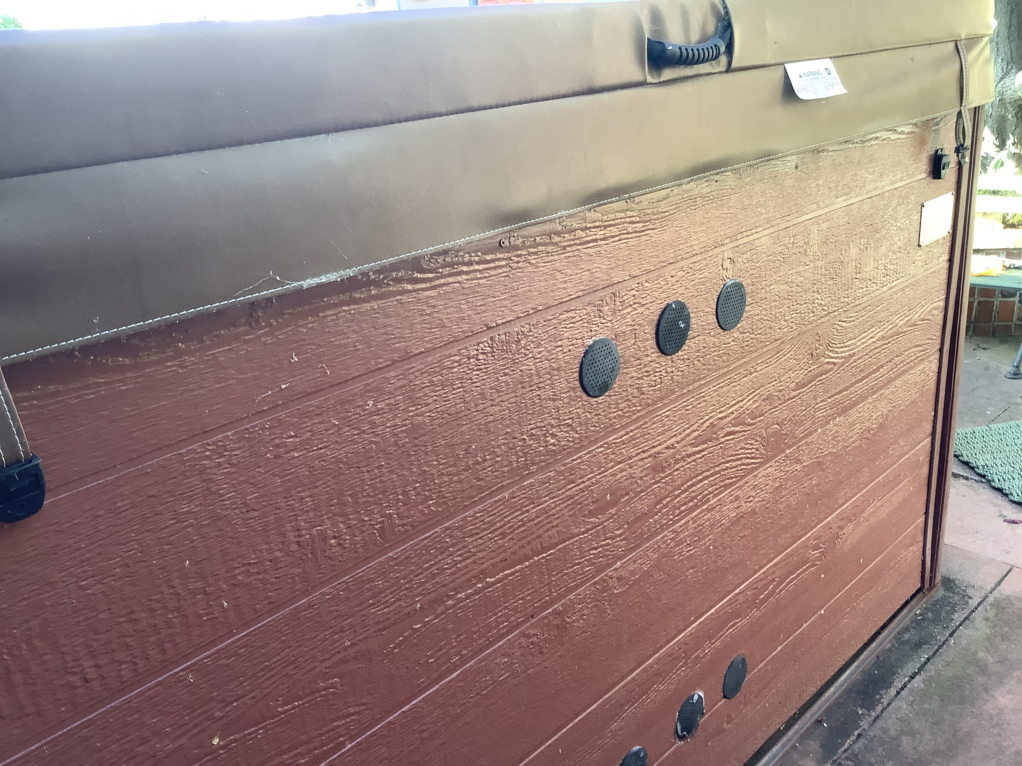

We got delivery in about 7 weeks. Learned that one reason for possible delay is that the cover was made in Mexico and shipped from San Diego. I might add the cover is great quality, superior to our last. But also an inch thicker, heavier than last. I should have tried to get a lighter one adequate to the California Bay peninsula. It might have been cheaper and easier to manage raining and lowering. -
We need to replace the cover on our 2008 MasterSpa H2X Swim Spa. It is 8x12 ft, two piece. We're just south of San Francisco (no snow). Some places say expect as long as 4 months for delivery. Any recommendations for quality cover and maybe quicker delivery welcome.
