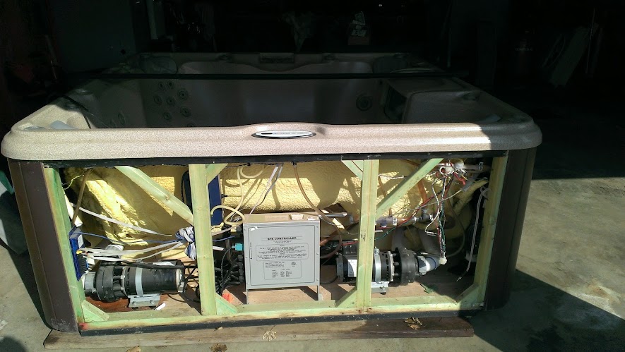

iced98lx Posted March 29, 2013 Report Posted March 29, 2013 Well after selling the reliable Colman 480 series I had the fiance decided she really didn't realize how much she liked the hot tub. Soo... I started looking for a used one since I wasn't keen on spending $12,000 again and selling it for $4000 when she decided that it was too much upkeep. I was surprised by an offer from my future brother in law (he's marrying my future wife's sister) to pick up his hot tub for free since he sold his house and needed it moved. The tub is a sundance 7 footer that I don't know much about. When I got it home I found much to my dismay the 'winterizing' that had been paid for didn't pay off: Now I'm looking for the end of the Volute for both big pumps, and found this: http://www.spaandpoolsource.com/6500-288theramaxfrontpumphousing2025hp.aspx This looks to be exactly what I am looking for for the Emerson T55MWCCE-1208 and T55SWBNC-999 pumps that are in the tub (one two speed, one one speed). Obviously I wont' know if I need impellers or possible an entire wet side until I get the pump out, but I'm hoping not. Any suggestions on things to check/look at? It's a full foam tub so I can't check every connection, but seems like there are a lot of scary places things could go wrong. I will be leak testing this in the garage prior to moving it into the back yard and hooking it up. Also any suggestions on getting the connections off the main pumps? those things are TIGHT! Thanks!!! Quote
iced98lx Posted March 29, 2013 Author Report Posted March 29, 2013 Also, does this give anyone enough information to identify what I'm working with tub wise? Quote
iced98lx Posted March 29, 2013 Author Report Posted March 29, 2013 appears to be a 2008 Sundance 780 Chelsee. Look slike the $38 front pump housing could work to solve some problems. Thoughts? Quote
Spa_Guru Posted March 29, 2013 Report Posted March 29, 2013 Best bet is what you have in mind, which is to leak test it before placing it, be sure you are filling it on a flat surface. If the pumps froze, I'd almost bet those jets in the center of the floor are cracked on the back side. Quote
n1oty Posted March 29, 2013 Report Posted March 29, 2013 Yes. The jets in the footwell dome are very susceptible to freeze damage and are a lot of work to replace. Keep your fingers crossed that you don't have issues there. John Quote
iced98lx Posted April 1, 2013 Author Report Posted April 1, 2013 Best bet is what you have in mind, which is to leak test it before placing it, be sure you are filling it on a flat surface. If the pumps froze, I'd almost bet those jets in the center of the floor are cracked on the back side. Yes. The jets in the footwell dome are very susceptible to freeze damage and are a lot of work to replace. Keep your fingers crossed that you don't have issues there. John Can I get to them from the top to at least take a look at the jet bodies? "A lot of work" meaning I have to set it on it's side and tear apart the bottom?? I'm going to get these pumps out and get the covers ordered and on and see what I can see for this. The heater in these just runs through the separate recirc pump, yes? Thanks for the suggestions, a little disgruntled that the person who was supposed to winterize this didn't apparently. Quote
n1oty Posted April 1, 2013 Report Posted April 1, 2013 If you end up having leaks at the foot dome jets, the tub will have to go up and you will have to go at it from below. Cross that bridge if you get to it. Order and replace the front volutes and see if you get lucky. It is unlikely that you will see cracked jet bodies from above unless the damage is really horrific. If you can see THAT much damage to the jets from above, expect a lot of issues throughout the tub. John Quote
iced98lx Posted May 13, 2013 Author Report Posted May 13, 2013 Finally got both pumps out of the tub, just need the volutes and the flow sensor (cracked housing) going to order parts and leak test. Quote
iced98lx Posted June 18, 2013 Author Report Posted June 18, 2013 parts finally ordered, getting married put this on hold. Snagged both end units and a new flow switch. Hopefully be leak testing this weekend. Quote
